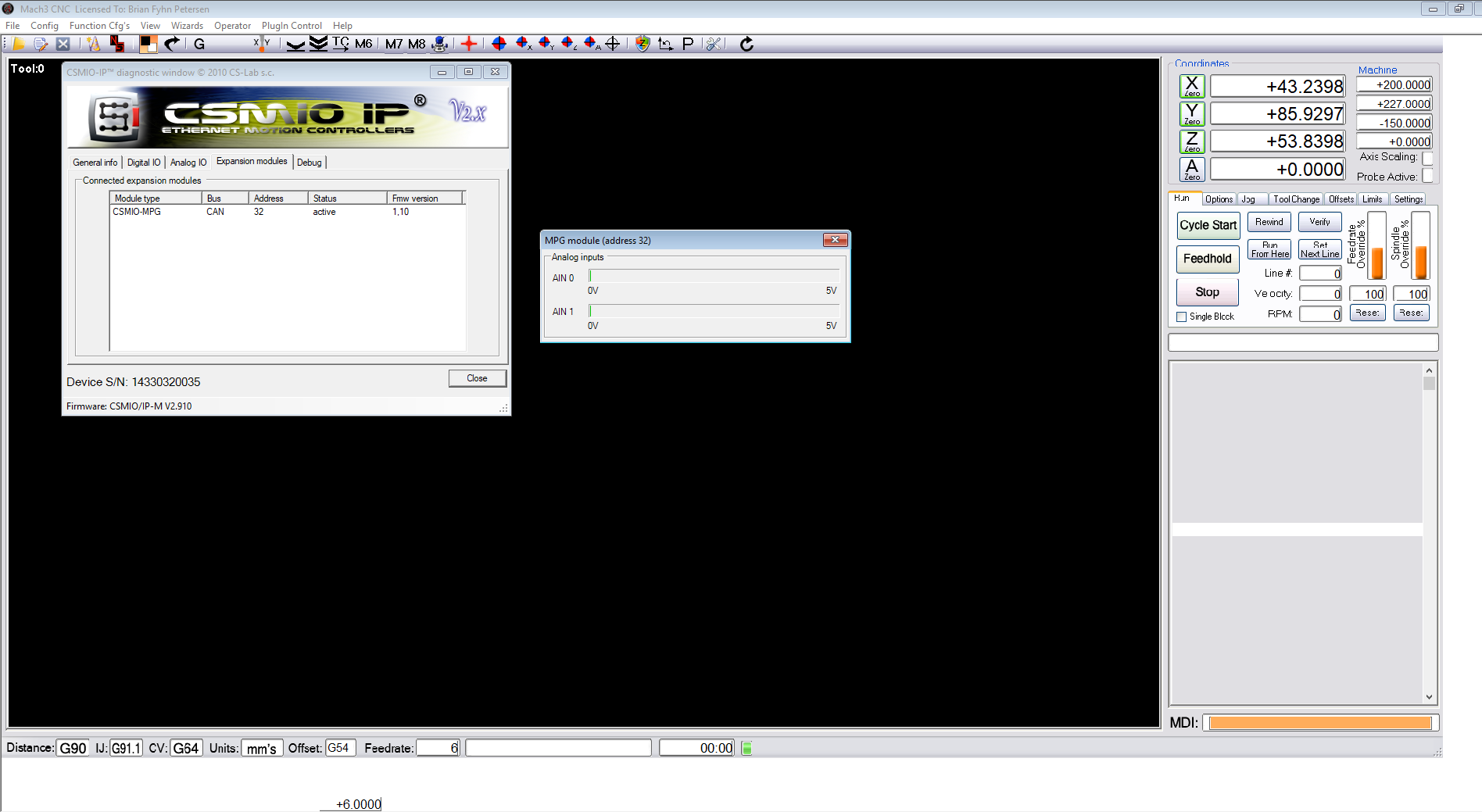

My MPG has just stopped working from one day to the other. The machine was shut down as I normally would do.
- The plugin is still listed under "Expansion modules", but the analog input signal bars are not moving when I turn the wheel.
- The LEDīs "MPG A and MPG B" on the MPG module turns on and off like normal, when I turn the wheel.
- The LEDīs for the multiplier selection shifts when I turn the knob.
- The LEDīs for the Axis selection shifts when I turn the knob.
It seems like the signals are not passed on to the controller. All cables are firmly connected.
Thank you.
BrianClick image for larger version.
