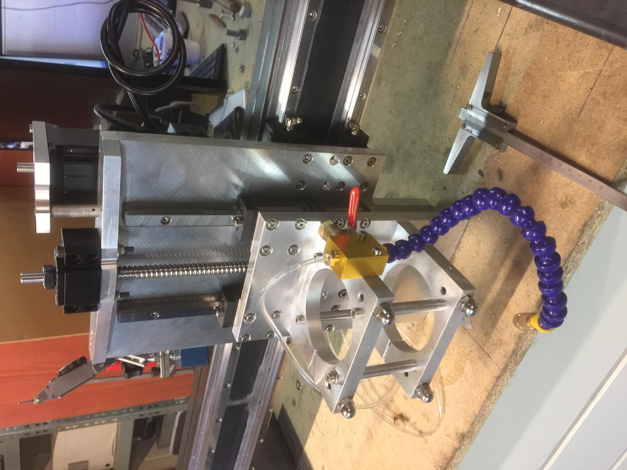

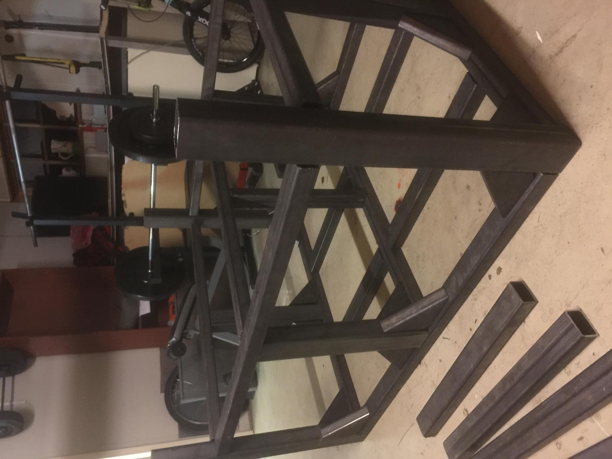

  1. Hello
    Some time ago i asked the opinion for a router to build in alloy or steel.
    Going to use steel.
    y and z as are ready but niw working on the frame.
    did cut all the steel today and it is heavy,total weigth off the steel 145 kg.

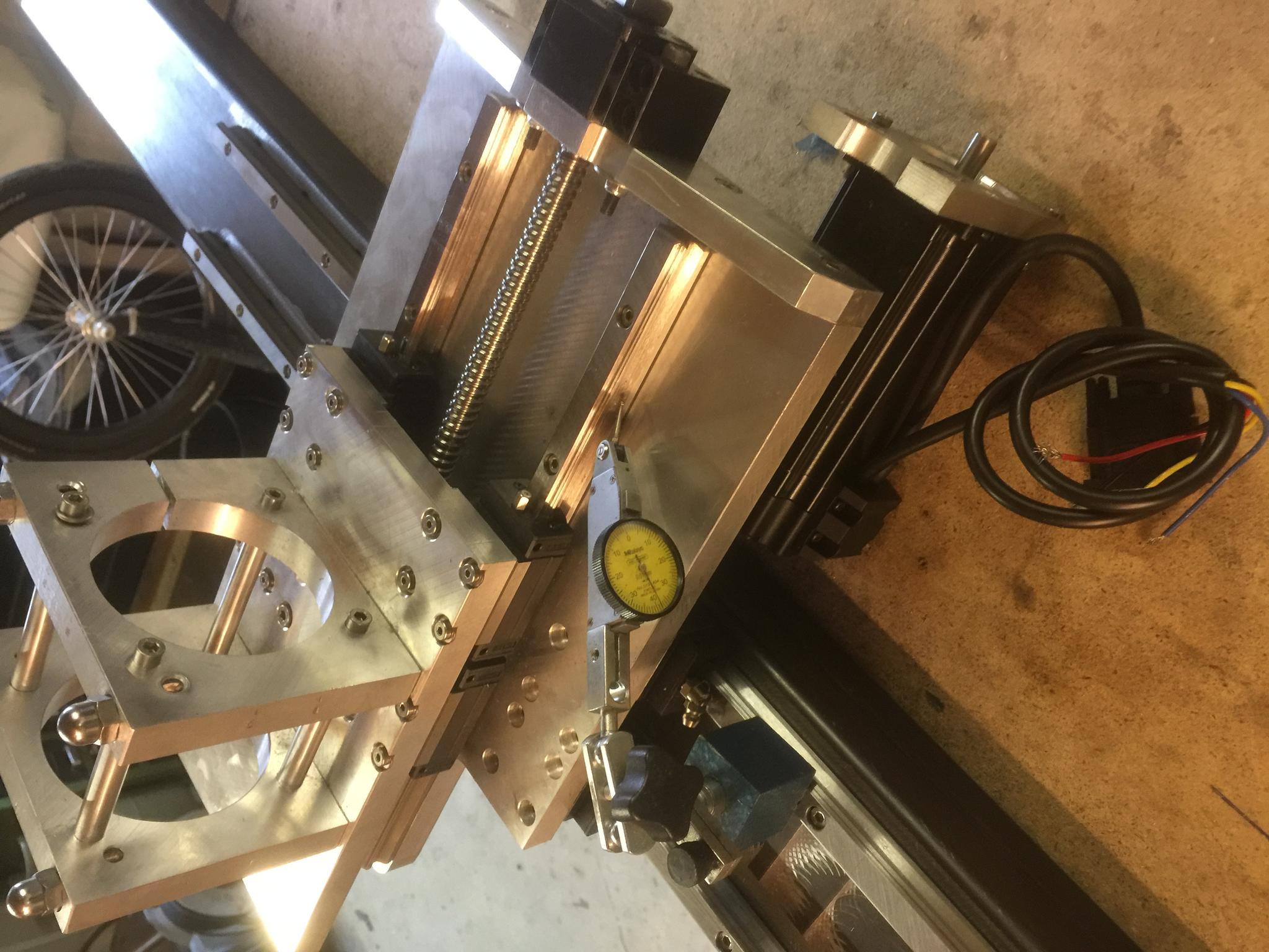

    z and y axle are chinese linearwagens and i like them,
    Did buy a set off four closedloop steppers nema e23 2.8 nm and also china and i like them very much.
    The service off the seller is perfect.
    Fir the x axle i did get hiwin 20 mm
    Spindles i whil use also china brand,did order a axle 400 mm to see what they are like and they do what they want.
    All members the best for 2019
    (sorry for dutchy english)
    greatings Frank

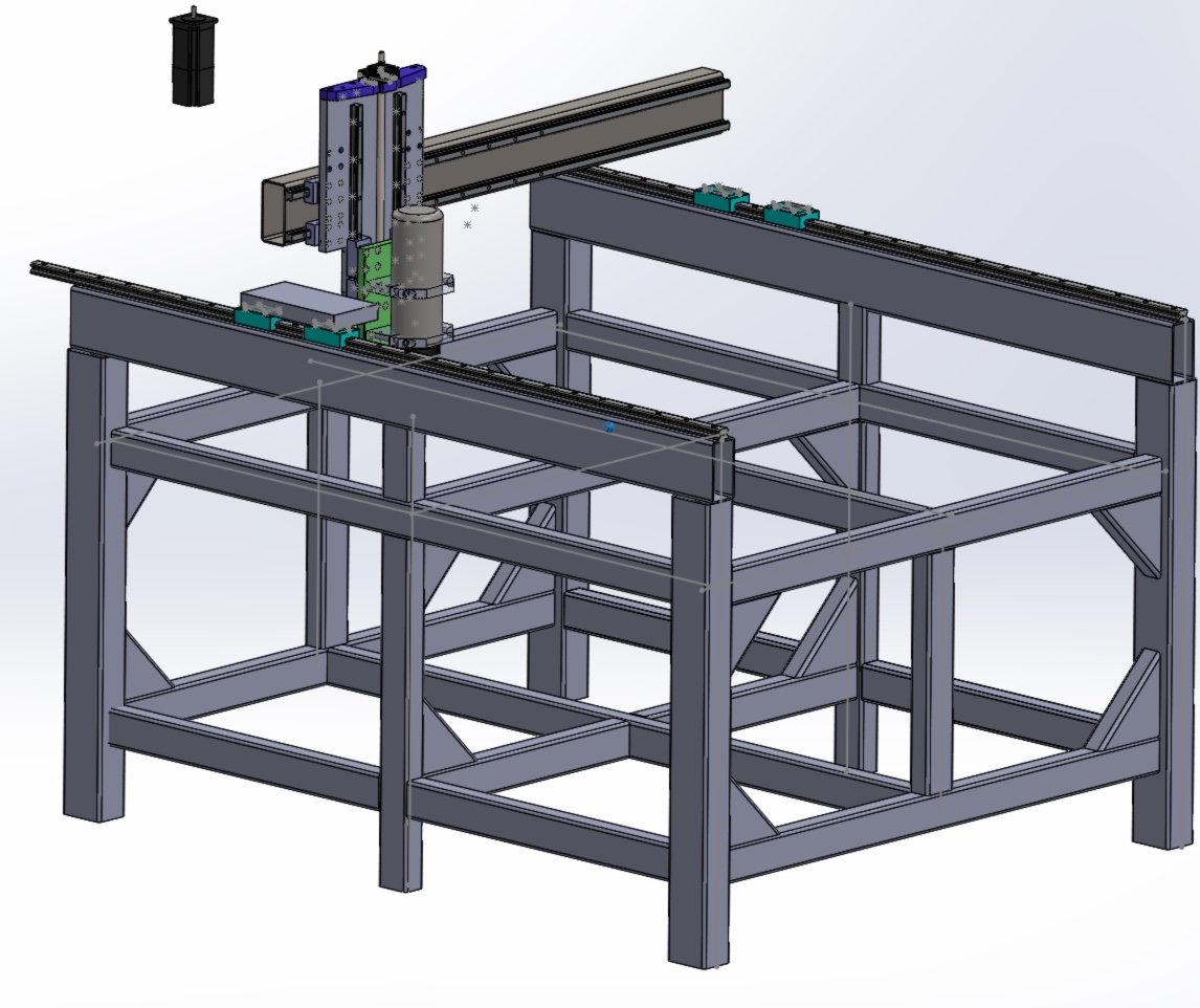

    Hey nice build. Can I ask what is your size of your y axis. Mine is 100x100x1400 mm and I am not sure if I can make the linearrails as you did on one side or if I should put one on top and one on the side so I get a larger distance between both. My z axis travel is 250mm
    Sent from my MI 6X using Tapatalk
  3. hello
    Size is 1200 x1000 mm and z. hight will be adjustable max i am thinking about.
    or make a dieper point for higher z valeu,all can still be changed
