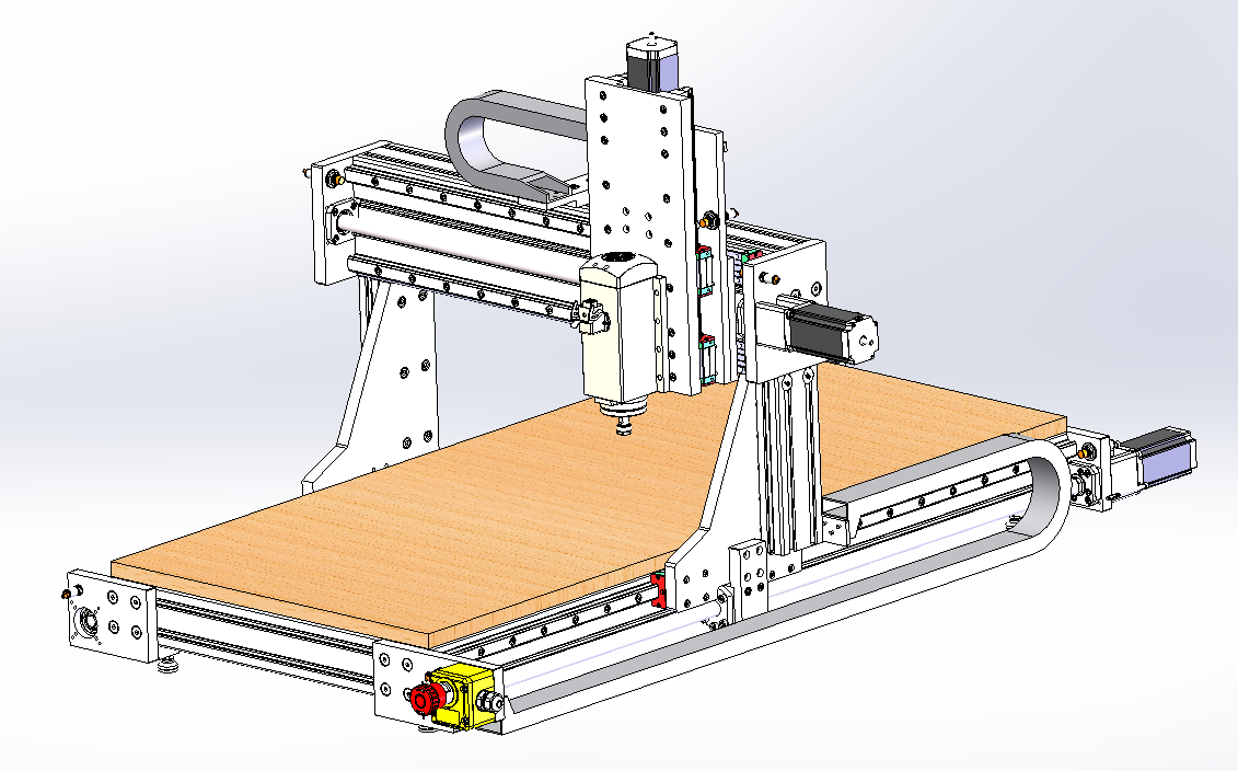

    I'm currently looking to build a 4'x4' router to cut aluminium, wood and plastics.
    My current (very) unfinished scheme looks like so
    My initial plan was to use slaved motors on the x axis but after thinking about homing switches and dropping steps I'm thinking of linking the two sides with a timing belt. More thinking required here though
    I'm a mechanical engineer by background so my main worry about the design and build of this machine is the electronics.
    With this in mind, after putting together the rough scheme for the mechanics, I parked that and my main focus for now is getting the electronics built.

    My first reaction is that 36V is a bit on the low side for a machine of this size. Something nearer 65V with drivers and appropriate motors to match would give much better performance.

    Neale - Good shout with the power supply being on the low side. I bought that stepper kit before really knowing anything so its probably not what I would go for ir I was buying again. I'm planning to get it up and running with the power supplies I have but will probably look into putting a larger one in.
    The mechanical design has gone through a number of changes and fluctuating goals but I've now got my mechanical design to a point where I am generally happy with it. Losing access to a workshop or garage has meant the size of the machine has needed to drop quite a bit. I've just recieved the 80/20 extrusion for the chassis and the aluminium plate has mostly arrived for the X and Y axies. This has all come as remnants and offcuts from eBay.
