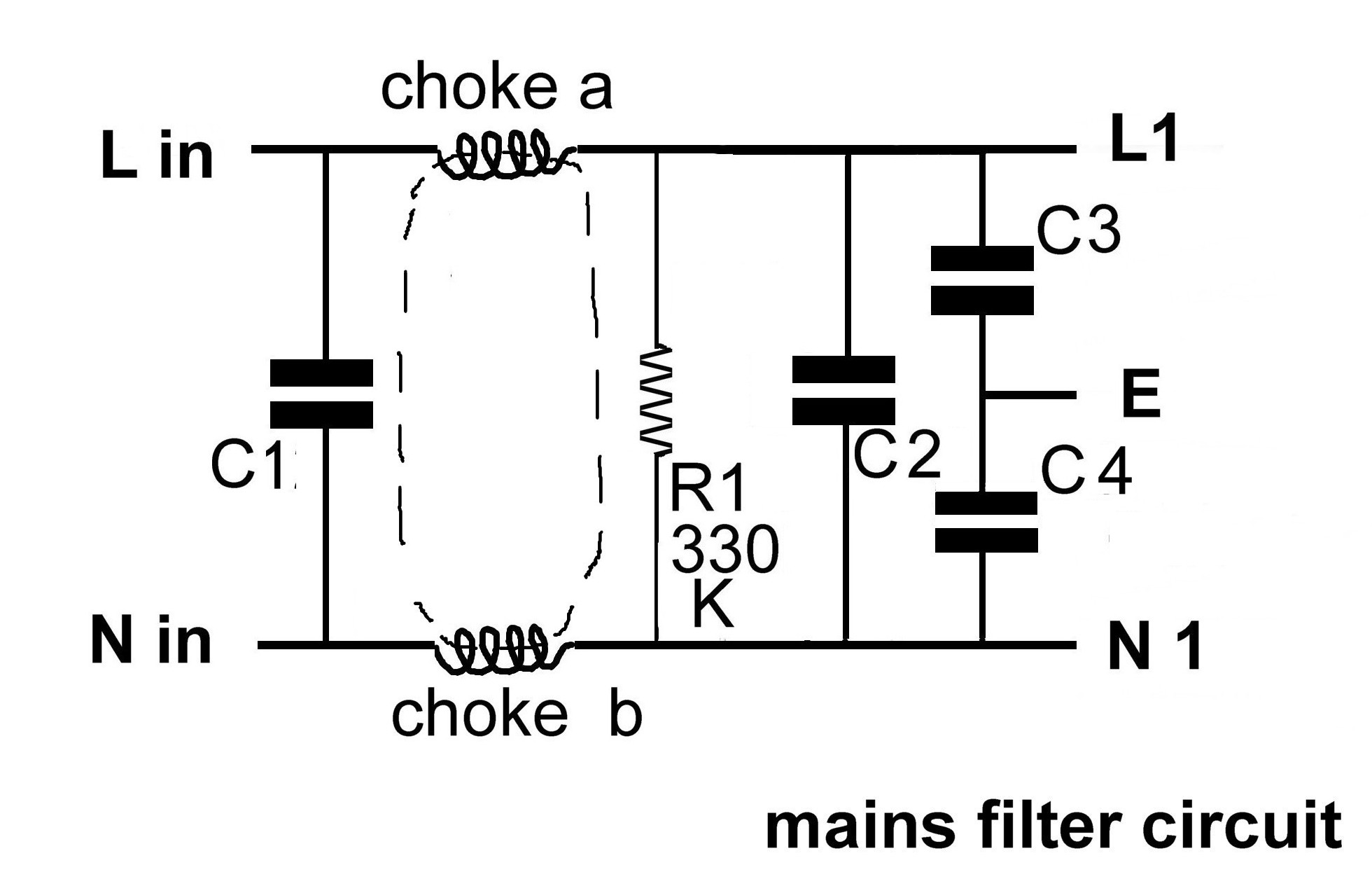

    the EMI filter could be like this
Name:	mains filter.jpg
    the choke has a low impedance at the mains frequency but
    a high impedance to the high frequency noise your trying to block
    the capacitors are just the opposite
    a high impedance at mains frequency and a low impedance to high frequency noise
    so the mains supply passes through uneffected but any high frequency noise between live & neutral are short circuited by capacitors C1 & C2
    any noise between the supply lines ( live & neutral) and earth will pass through capacitors C3 & C4 to be grounded
    the filter may be potted in a metal enclosure

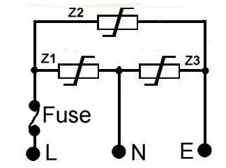

    if VDR's are added to provide transient voltage protection like this
Name:	VDR network.jpg
    you need a fuse in the live connection as VDR's very often go short circuit when they fail
