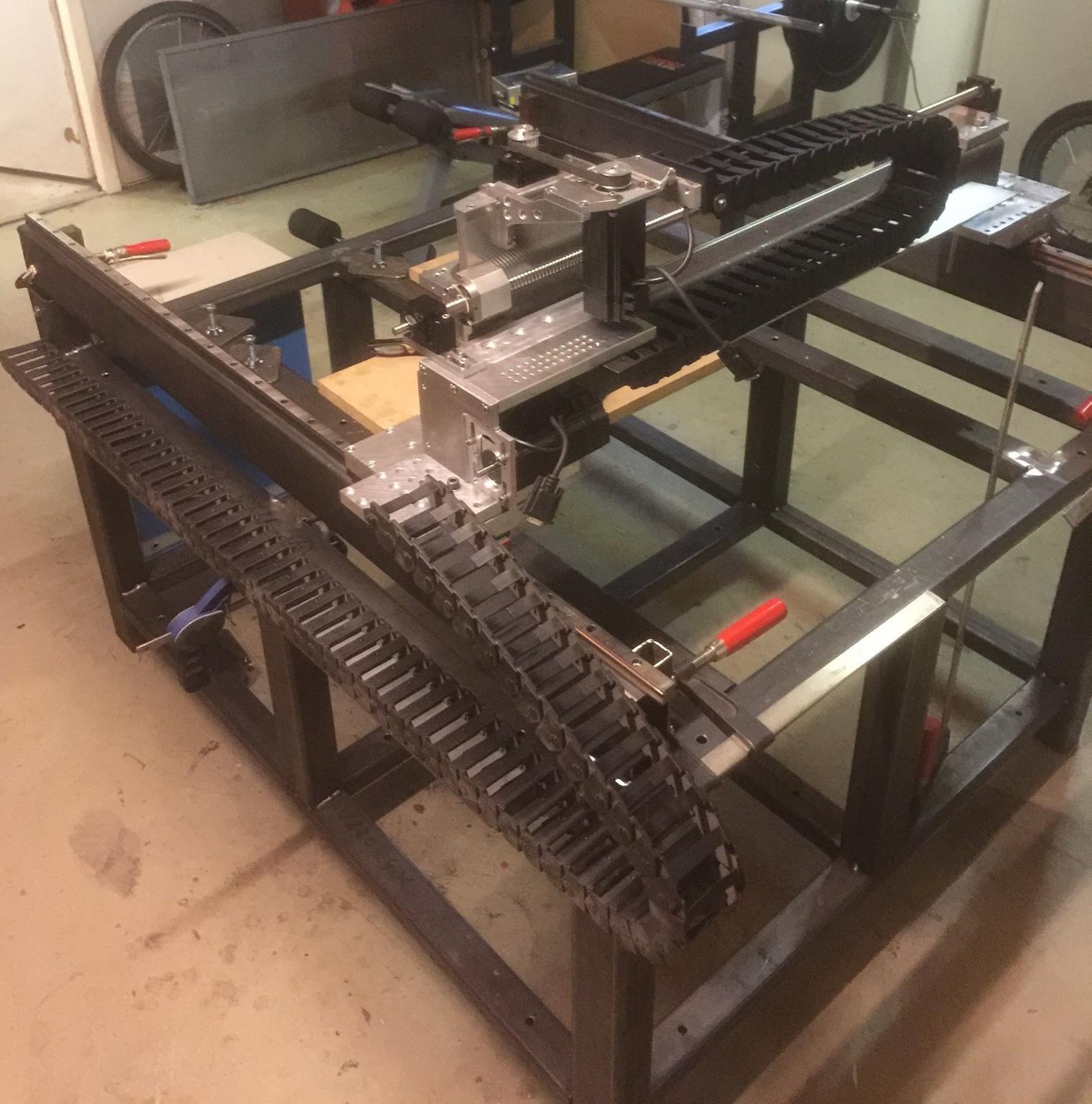

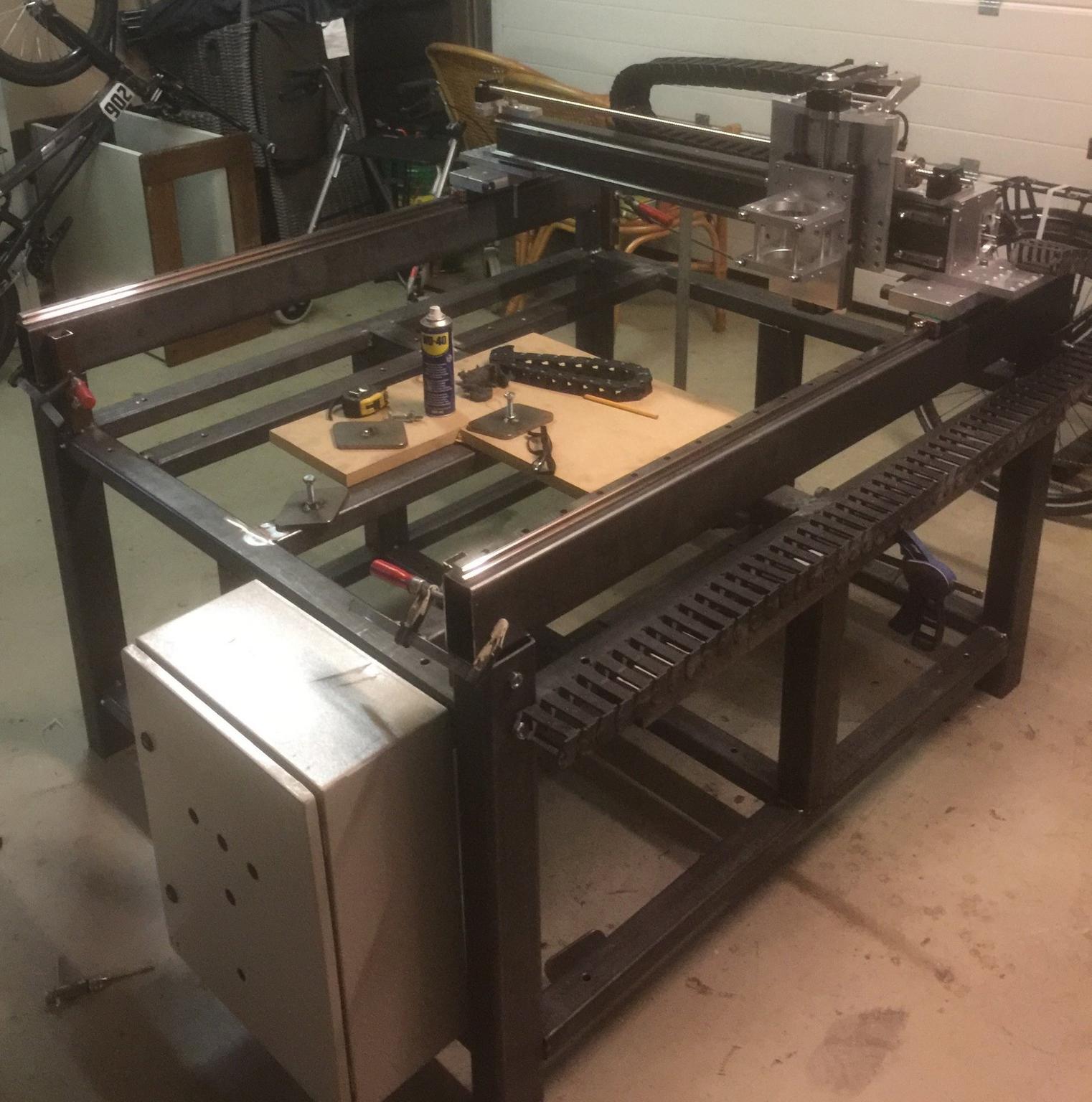

    did do some work on my router today and z,y axle ready but now thinking what to use for the y axle.
    Ballsrew or rack and pinion.
    Did use ballscrew sometimes niw and di now know if ball and screw is better .
    give me your opinion please
    grt frankClick image for larger version.

    Hi, I use a ball screw, but if I decided to use a rack pinion system now.
    Two accurate reasons
    - Long spherical screws will easily cause resonance problems
    - Step motors don't like fast turns. The ball screw 1 rev is only 5mm, but the GREAT TORQUE (1605 screws)
    if you use an servo motor I would take a ball screw.
    sorry for my english
