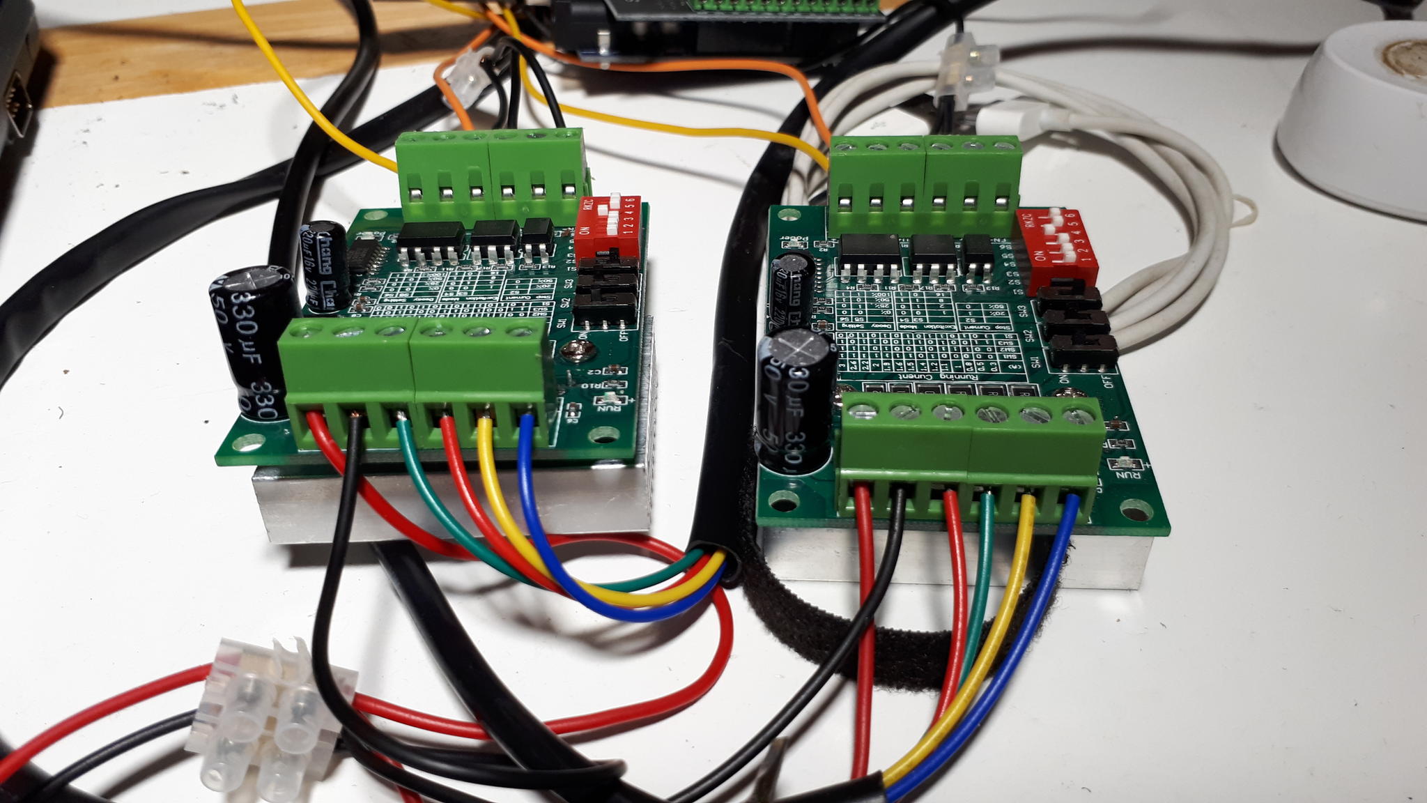

    I use GRBL Panel + arduino its not rocket science believe me if I can work it out anyone can and it totally free. If u just want to g-code sender it works on Raspi. all I have is 3 TB6560's connected to an uno power supply and shitty old dell laptop - works fine - took me about an hour to configure it all and set the steps etc using YouTube video's
