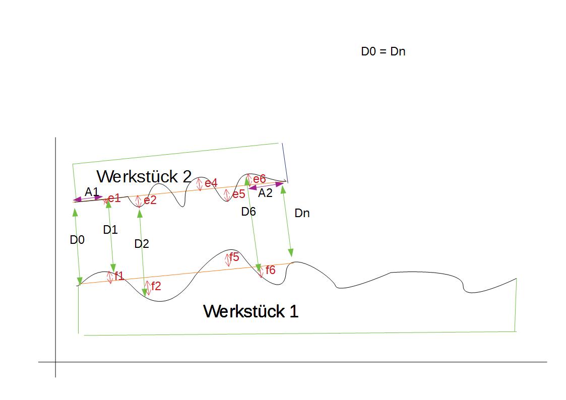

    Hello and sorry because i allready asked some question about cheaper ways to straighten my linear guideways. But I had an idea where I wanted your opinion on. So in my case I have a linear guideway of 4m but it can also be smaller for my idea. I want to have it as precise as possible. A straight line reference is too expensive for my hobby project. So I had the idea to buy a Granite tile by the size of 1mx10cmx1cm. I won't know the error of it of course. So my idea is by using a dial indicator to align it at 0 on tip (M0) and end (Mn) of the Granite. Now I would take measurements (M_i) every 5 cm. Every M_i will consist of two errors A_i from the Granite and B_i from the linear guide way. So that I could write for the first measurement M1=A1+B1. For the last one I could write Mn-1=An-1+Bn-1. Now when I flip the Granite and align it again to Mf0=0 and Mfn=0. And i would get Mf1=An-1+B1 and Mfn-1=A1+Bn-1. Now I would have 4 equations with 4 unknown. Which I can solve. Does that work? I am aware that you can buy linear reference second hand cheaper. But my question is more of theoretical interest.

    I think that you have forgotten one variable in each equation. You have shown each measurement as the sum of two errors, but you need another variable in there which is the "correct" distance. For example, if this is Cn, then you should be writing M1=A1+B1+C1. Unfortunately, when you flip the reference surface, you then get Mf1=An+B1+D1 - as the surface will not be the same distance away. In any case, I suspect that there is at least one more unmeasured/unmeasurable variable involved.

    Now I had to think about it ;-)
    But In my understanding D=Df would do the trick. Because You can choose D freely. Honestly I also suspect another unknown. But I don't see it ;-) Maybe some kind of cosine error. But it shouldn't be large. Actually I have a drawing for it. Werkstück1 refers to linear guideway and Werkstück2 to our referenceClick image for larger version.
