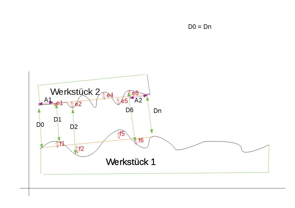

    Hello and sorry because i allready asked some question about cheaper ways to straighten my linear guideways. But I had an idea where I wanted your opinion on. So in my case I have a linear guideway of 4m but it can also be smaller for my idea. I want to have it as precise as possible. A straight line reference is too expensive for my hobby project. So I had the idea to buy a Granite tile by the size of 1mx10cmx1cm. I won't know the error of it of course. So my idea is by using a dial indicator to align it at 0 on tip (M0) and end (Mn) of the Granite. Now I would take measurements (M_i) every 5 cm. Every M_i will consist of two errors A_i from the Granite and B_i from the linear guide way. So that I could write for the first measurement M1=A1+B1. For the last one I could write Mn-1=An-1+Bn-1. Now when I flip the Granite and align it again to Mf0=0 and Mfn=0. And i would get Mf1=An-1+B1 and Mfn-1=A1+Bn-1. Now I would have 4 equations with 4 unknown. Which I can solve. Does that work? I am aware that you can buy linear reference second hand cheaper. But my question is more of theoretical interest.

    I think that you have forgotten one variable in each equation. You have shown each measurement as the sum of two errors, but you need another variable in there which is the "correct" distance. For example, if this is Cn, then you should be writing M1=A1+B1+C1. Unfortunately, when you flip the reference surface, you then get Mf1=An+B1+D1 - as the surface will not be the same distance away. In any case, I suspect that there is at least one more unmeasured/unmeasurable variable involved.
    As an alternative, how about buying a length of, say, aluminium bar the cutting length of your machine. Clamp it as parallel as possible to the axis, and take a light cut off one edge. Then flip the bar by rotating along its long axis, so that the cut surface is now on the other edge, so to speak. Then run a dial gauge in place of the tool along the cut edge. I think that theoretically this will then read twice the rail alignment error at each point. Haven't tried this myself but I have been thinking about problem recently. First thought was to cut two identical bars as above, then flip one, push them together, and check the gap between them. I really need to do something like this on my own machine, but I'm too busy using it to find time to tune it!

    But In my understanding D=Df would do the trick. Because You can choose D freely. Honestly I also suspect another unknown. But I don't see it ;-) Maybe some kind of cosine error. But it shouldn't be large. Actually I have a drawing for it. Werkstück1 refers to linear guideway and Werkstück2 to our referenceClick image for larger version.

    You stated in your previous post that you had a length of heavy duty aluminium 1500mm long and an acurate machined surface that was straight to within 0.004mm if memory serves, use this to adjust your rail, i did explain how to do this some time ago as this question has been asked countless times, start fixing the rail from the center work your way alternately towards each end, you will then in your case have a section of rail 1500mm straight to the given accuracy of your reference gauge, you then use your secured section of rail as a datum for setting the remaining unsecured section of rail.
    Sorry when I asked the question again. I had to give back the Aluminium. As my rail is set now. But my question was more out of theoretical interest.

    One quite simple way to set rails straight is with a stretched wire. Together with a cheap digital microscope (Get one with electronic cross-hairs) off the net. Alternately an optical microscope can be used with a cross-hair reticle. Mount the microscope on a rail slider on the already positioned rail beside the stretched wire you have mounted in your machine frame already positioned in line with where the rail will be placed, best you offset it say 20mm to allow access to the rail screws.
    The procedure is simple. just work your way along the rail centering the microscope cross-hairs on the wire as you go.
    You will need to make up some sort of mounting for the wire to position it accurately. One end will be fixed one end will have a large weight attached to it.
    The weight is normally calculated to b about .75% of the breaking strain of the wire. http://www.roeslau-draht.de/fileadmin/user_upload/Downloads/music3B_Zb_2.pdf
    Thinner is better mine is .17 Round not hex.
    This is not a new technique Wire alignment goes way back in time. It is still used to this day.
    https://www.google.com/search?rlz=1C...iz.tTYd1bOv-T0
    Accuracy of 0.001" is obtainable over long lengths.
    Gravity will affect the vertical plane, to check the flatness of your rail mounting surface the Catenary sag of the wire will need to be calculated for various positions along the wire. Think of sagging power lines. https://www.google.com/search?q=cate...hrome&ie=UTF-8
    Over less than a metre the sag is very small.

    Haha great that sounds perfect. Especially the stack of washers. Thank you for the inside information. I know a bit of computer vision so I think I will go with the optical approach instead of the electrical contact. With an automatic edge recognition I could easily read out the error. Only downside now for me with the Röslau wire seems to be that it is transparent but it should be fine. Do you remember the pulling force/weight? If not I will find out.

    The weight was a 4140? 200mm dia gear blank 35mm thick I never did weigh it by calc about 11kg
    Roslau blue label carbon steel wire is not transparent?

    thx. I will follow your approach then. The wire on the photo just appeared to be transparent.
