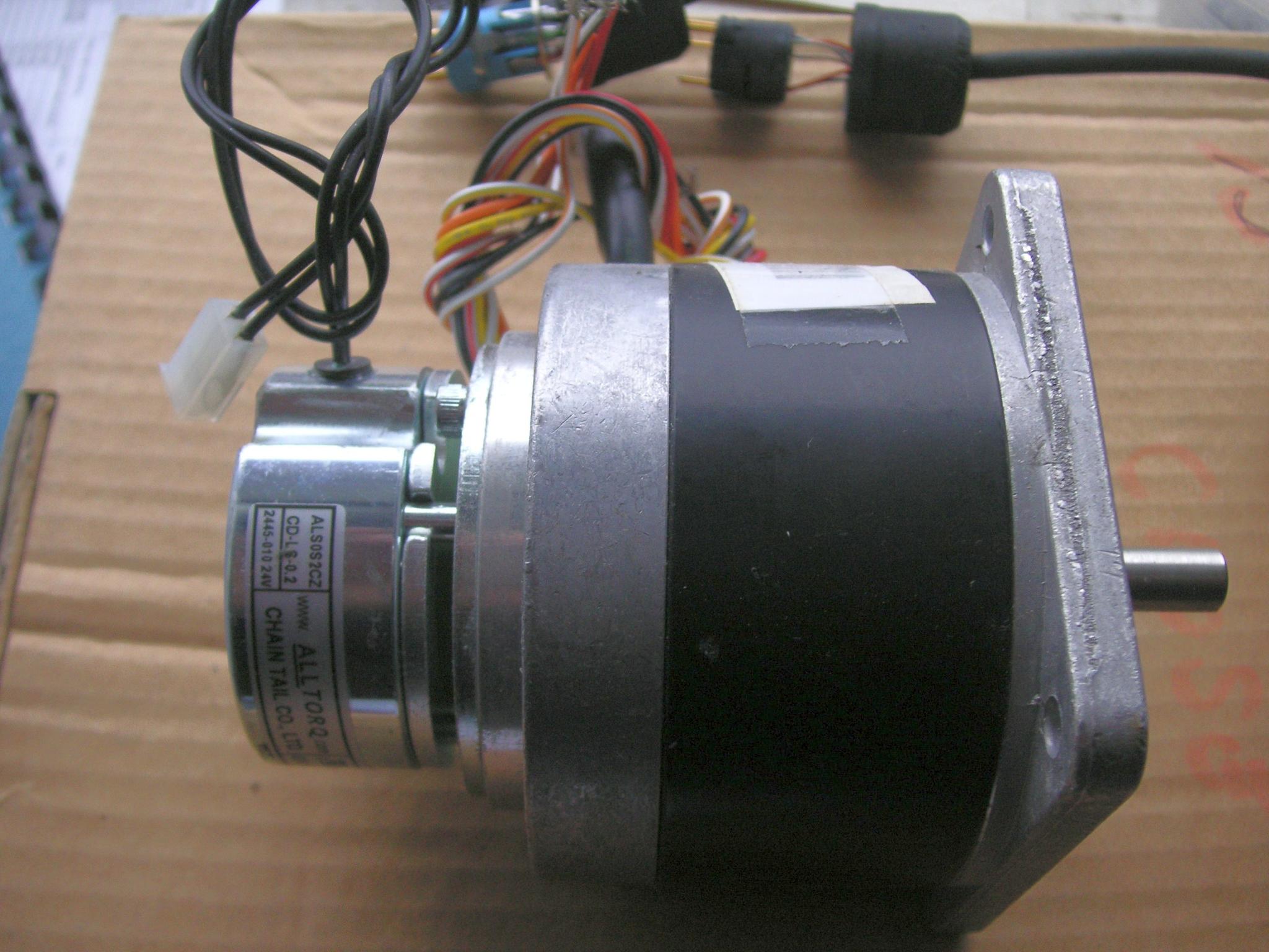

    This statement is incorrect. When a stepper is not energised it can free wheel and will when the Z is heavy. Some machines have an electric brake on the Z motor for that reason.

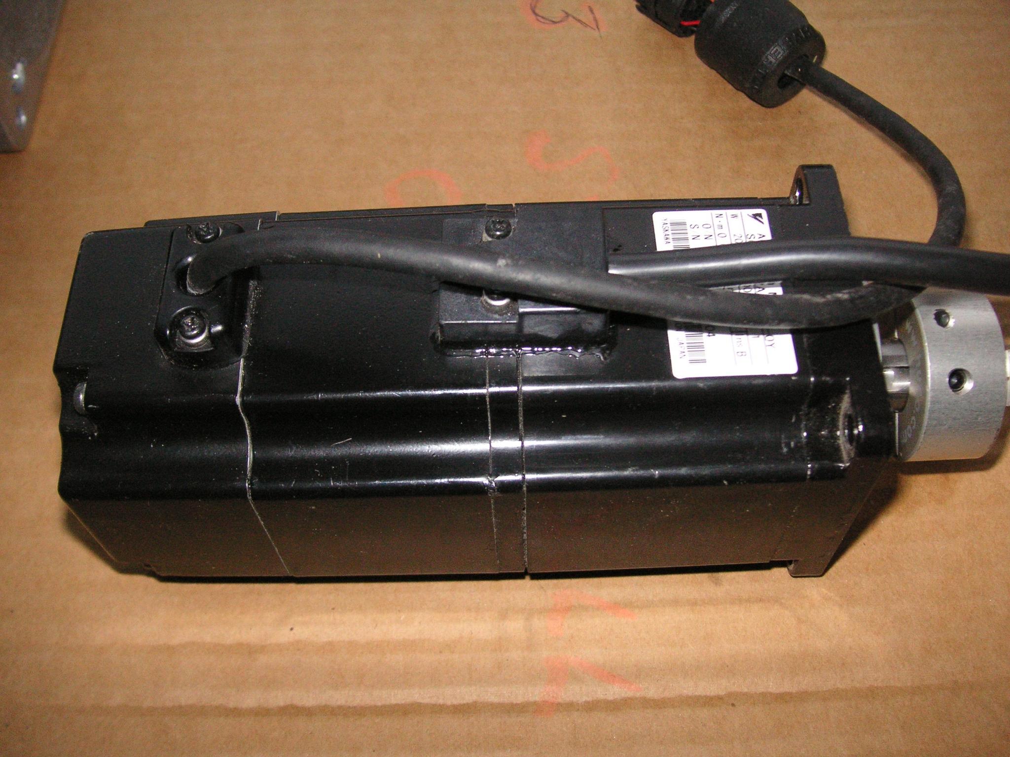

    He's using a servo, so it's not relevant.
    What you really need is a servo with a brake.

    As pics
Name:	Stepper with brake.jpg

Name:	Servo with brake.jpg
