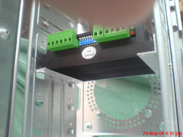

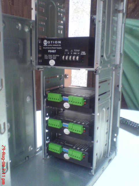

    Gentlemen: I'm profoundly thankful. I followed your instructions and proceded to troubleshoot each component until I found that one of the two memory cards was apparently bad. Now I have video. Note: I removed all the cnc components I had attached to the case and built a separate box for them. Again, thank you!
    Sent from my LGMS210 using Tapatalk
    Great stuff, really pleased you got it sorted and thanks for letting us know!
    I think moving everything cnc related to a new box was a good idea, I was going to suggest this as space did look very limited in the PC case, though I have done this myself in the past and can understand why one would go down that route.
