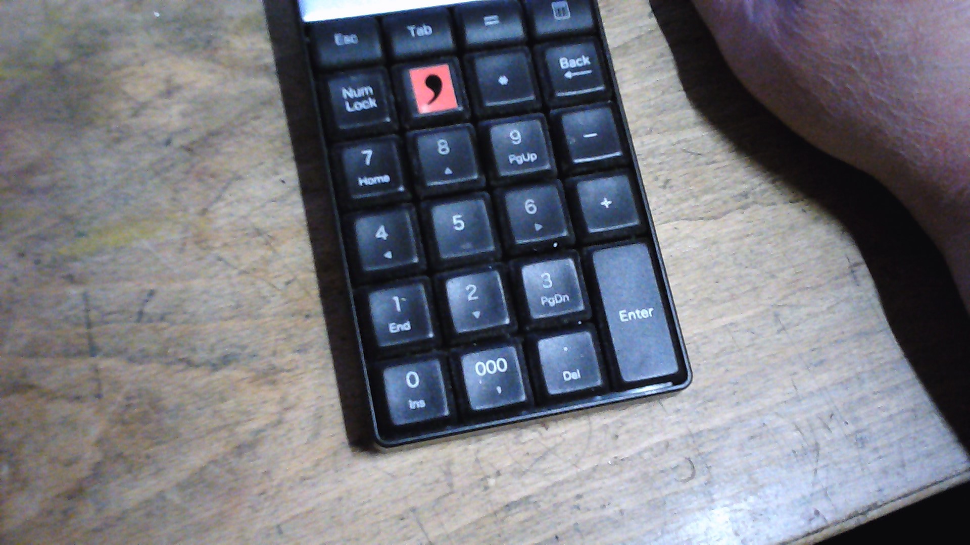

    I have a wireless numeric keypad which I use for jogging 4&6 for the X axis 2&8 for the Y axis and 3&9 for the Z axis the latter is Page up and Page down
