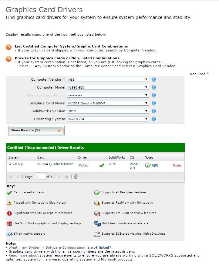

    M1000 is listed and is fine - this is mobile workstation
Name:	MSI SW spec.PNG
    my concern is related to desktop workstation with i5
    Simply do not want waste money on higher card if I won't use its potential.
    I'm aware your concern is with adding an m2000/m4000 which is why I suggested looking at the benchmark results for those cards, to get an estimation of the difference they make on otherwise similar systems.
    I know it's not the answer you're looking for, but thought it might help give you a rough idea.
