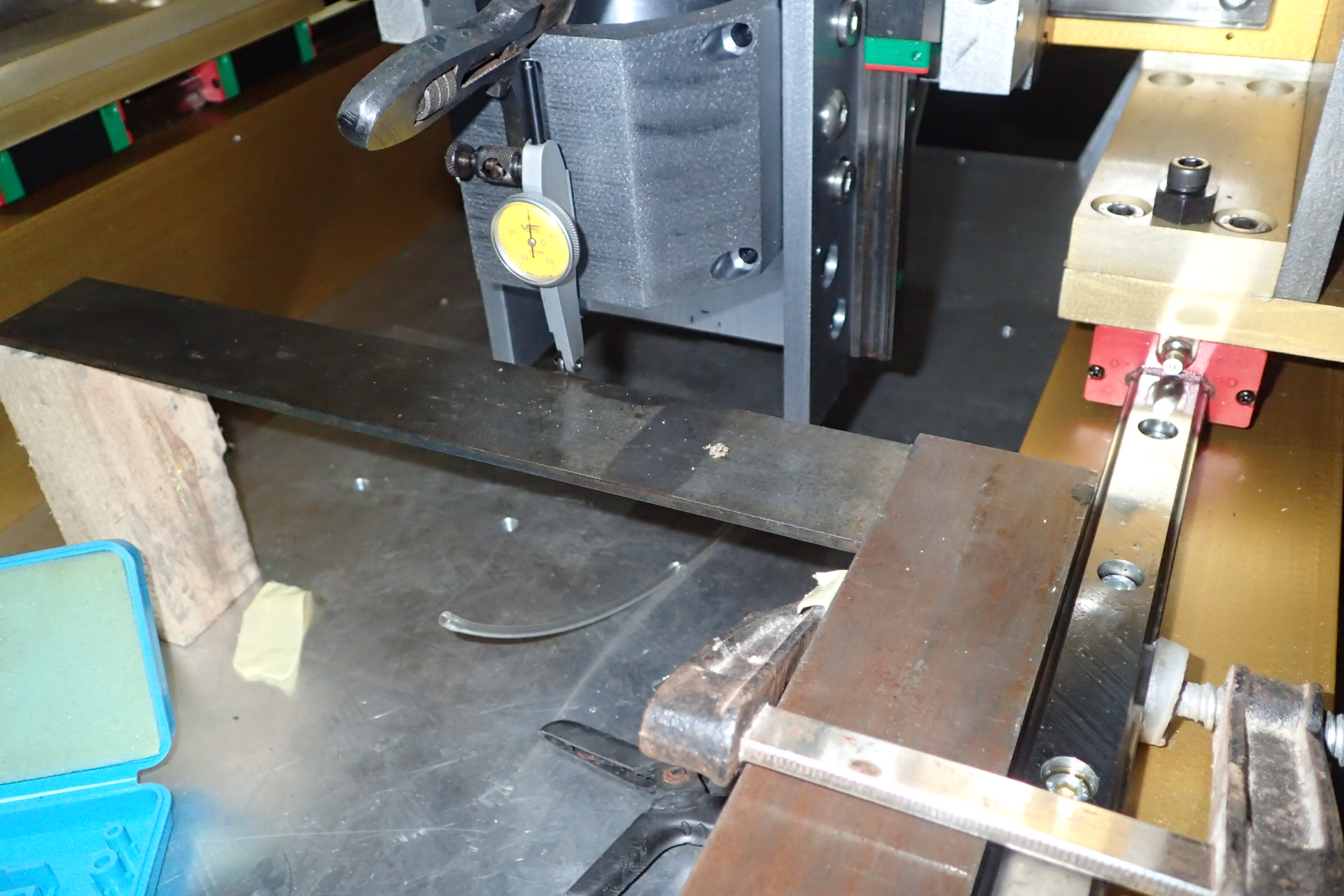

    Not having any CNC machining capability until it's made, I'm having to "bootstrap" the process, apart from one or two pieces that I need to get laser cut, it will all be done using the trusty Elektra Beckum chop saw, a drill press (Axminster ED16B2) and my little lathe. First job was to fettle up the saw and make a decent clamp for it:
    With a new blade fitted and a few minutes true-ing it up it goes through 15mm plate like a knife through butter. Squareness is about 0.25mm across a 125mm cut, and with a wee drop of WD40 to help the cutting, the cut ends are smooth as a b******s bottom.
