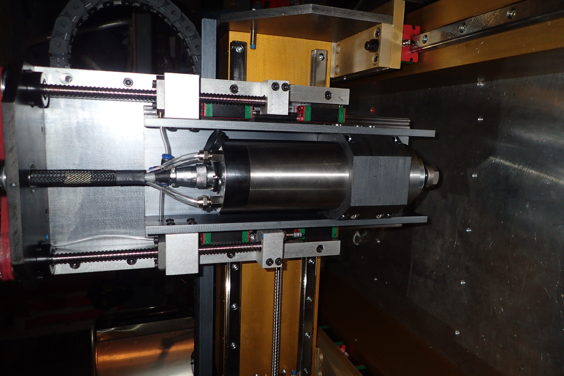

    After much swearing at the rather arkward connector I've got the spindle installed

  10. #48
    To be honest, it wasn't just a desire for neatness :blush: Having painted myself into a corner with feasible belt paths on the Z-axis I came up with the idler-with-the-cable-through-the centre idea. Problem was, the cooling pipes tended to have a bit more friction through the bushing than I was comfy with - the cable braid is a lot more slippy and makes everything move a lot more freely .

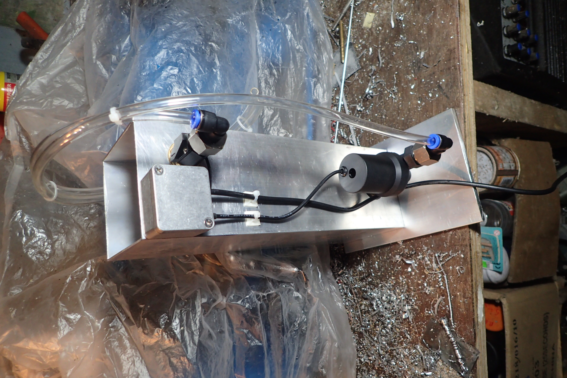

    The spindle of course needs cooling water. After a long and fruitless search on the Bay of fleas for a suitable flat sided metal pot, I made one out of a bit of 100x100x2 ali tube that's been at the back of the workshop for ages. Add a pump + flow switch and everything's cool
    You might want to add strain relief to that, it's just a short circuit waiting to happen. Also not a good idea to pump heat into the wire which is what the water pipes will do, esp on long jobs.
    Strange Z-axis design. Why did you feel the need to use 2 ball-screws and have the linear rails side-mounted.?
