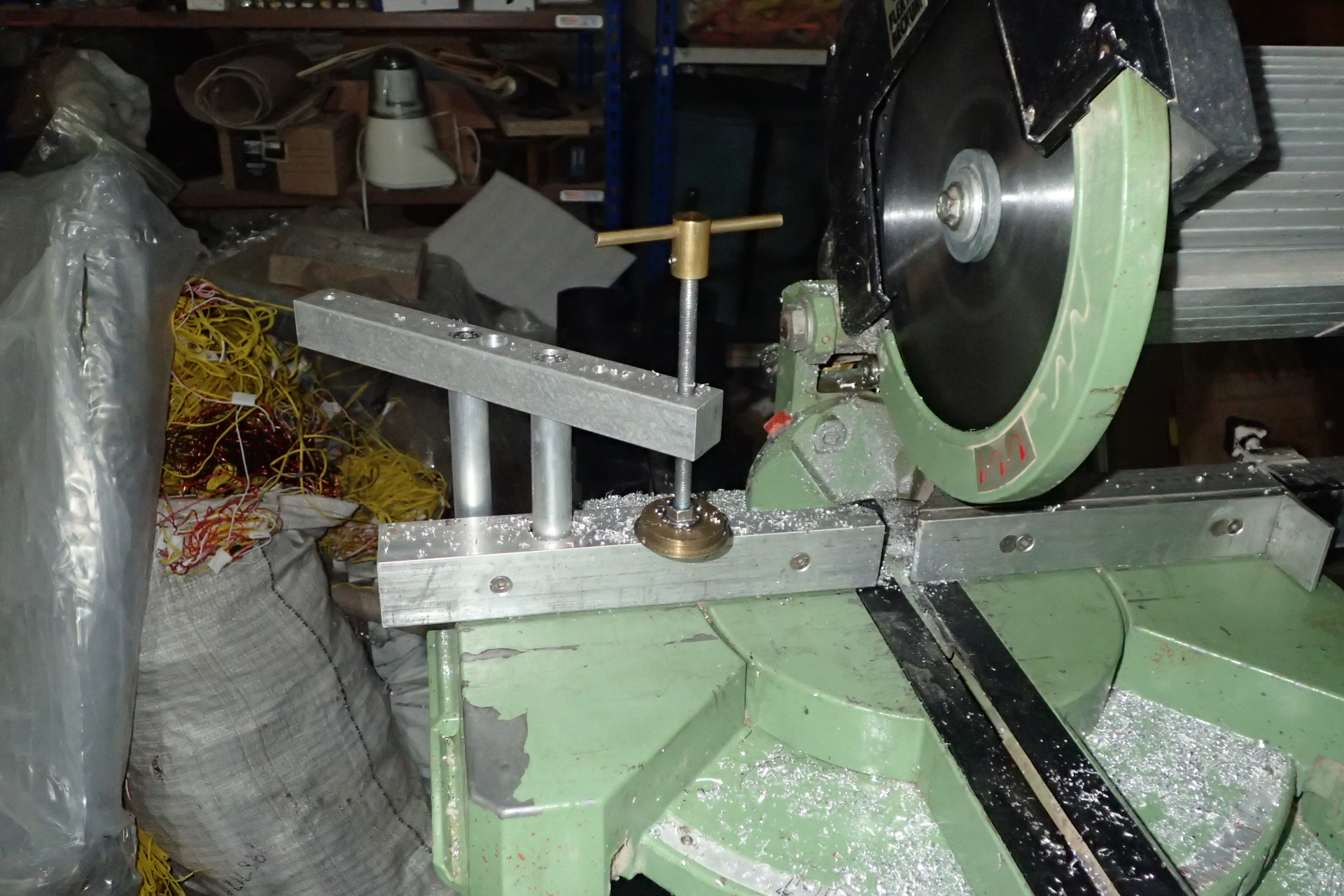

    Not having any CNC machining capability until it's made, I'm having to "bootstrap" the process, apart from one or two pieces that I need to get laser cut, it will all be done using the trusty Elektra Beckum chop saw, a drill press (Axminster ED16B2) and my little lathe. First job was to fettle up the saw and make a decent clamp for it:
    With a new blade fitted and a few minutes true-ing it up it goes through 15mm plate like a knife through butter. Squareness is about 0.25mm across a 125mm cut, and with a wee drop of WD40 to help the cutting, the cut ends are smooth as a b******s bottom.

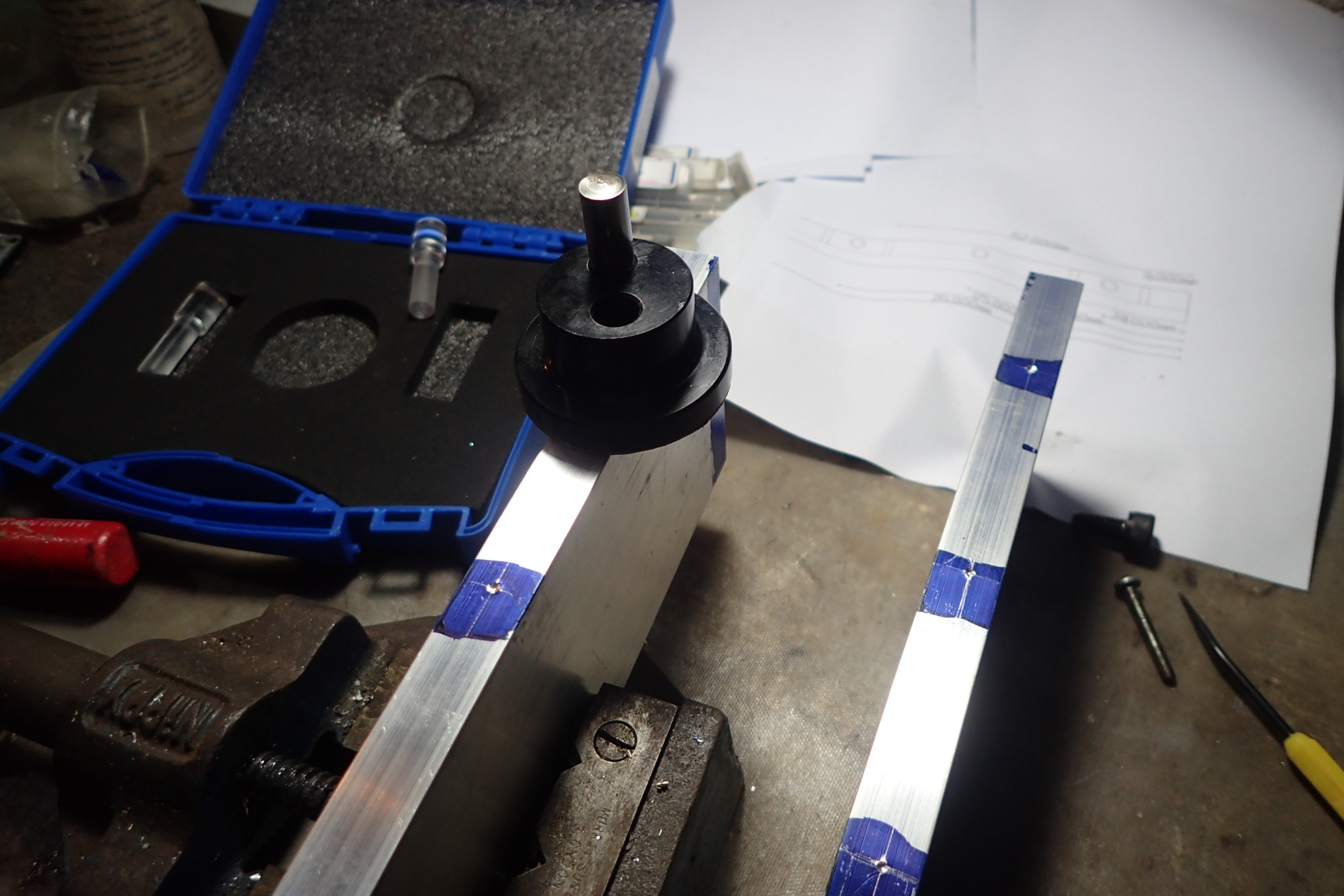

    First parts to make were the carriage plates for the Y axis (please note I denote X & Y from the point of view looking down at the front of the machine i.e. the X-Axis runs L to R along the gantry):
    here's marking them out using the trusty optical centre punch:

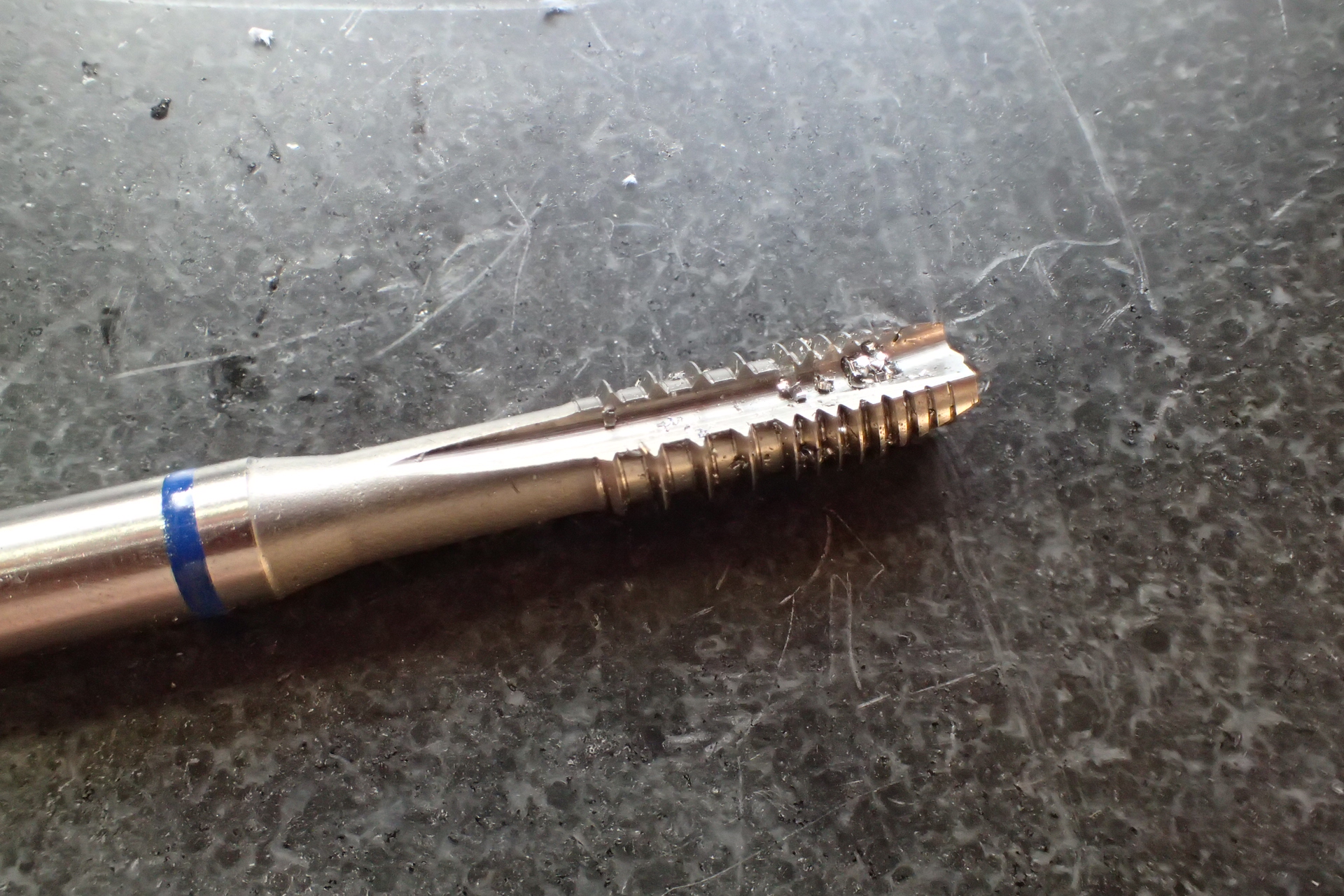

    talking of tapping I soon realised that there were going to be A LOT of holes to tap and if I wanted to save a lot of time (and avoid w*****s cramp!) machine tapping was the way to go. Tapping machines looked a tad expensive for the moment, thought about changing the motor of the pillar drill to give a quick reverse function, but some bits were on a couple of weeks lead time.... then I tried one of the Europa tool interrupted-thread spiral point taps:
    These seem to require a lot less tapping force than anything I've tried before and seemed hence offer up the option of tapping with a cordless drill (which convieniently has a torque limter to stop breaking taps, and a reverse to extract them). In order to keep things straight I added a circular level to the back of an old drill, using the pillar drill and a length of tool steel rod to get it properly level whilst the glue dried.
    Nice bit of customisation! I've taken to using a guide for my taps to pass through; find a block of something (wood, aluminium) that is about as thick as your tap is long, minus 1cm and the length of the square drive section. Using the pillar drill, put a guide hole through the block - diameter to be as close fitting as to your tap as possible. Now you can place this block up against the surface you're going to tap, passing the tap through for the first bit of the hole - hey presto, nice and straight tapping every time.

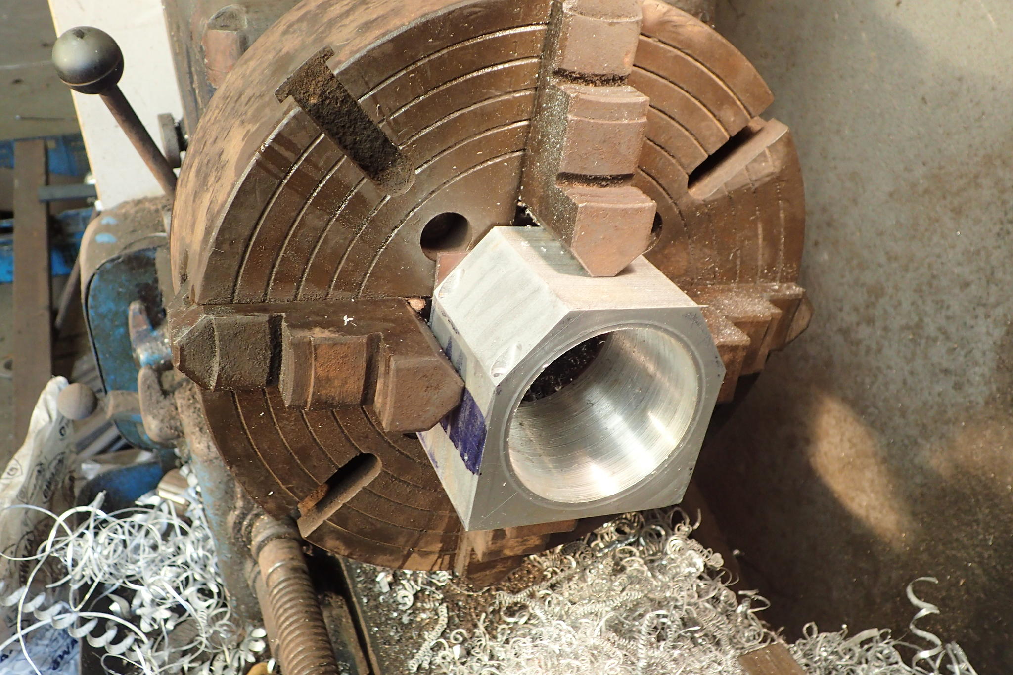

    I've got most of the pieces machined up now and waiting for the dozy anodisers to do their stuff on some of the beams - whilst it's obviously a home built machine I wanted it too look vaguely OK and I don't really have the space for some 3ft long anodising batths at the mo. Today I finished off making the spindle clamp, I'd cut the outside profile and done the holes a few weeks back, but I've been waiting for a friend to have some free time so I could use his mighty steam-powered lathe to bore the hole. Here it is after putting a 30mm drill through to start things off: And yes, that's a 300mm chuck and it's a heavy lump!
    Then it was something like 3 hours gentle boring out, with a few minor hiccups and several Km of swarf - here's the end result:
    The internal finish wasn't quite as good as I'd hoped as he had a rather limited range of boring bars and with 80mm of tool sticking out from the toolpost there was a certain amount of resonance going on; never mind, no-one will ever see it, and as long as it grips the spindle I'll be happy.
    The reason for making the spindle clamp was initially because I couldn't easily source an 85mm part OTS, then it kind of led to some lateral thinking about how to implement the Z axis with good strength and minimum width - all will be revealed soon when I start putting it together

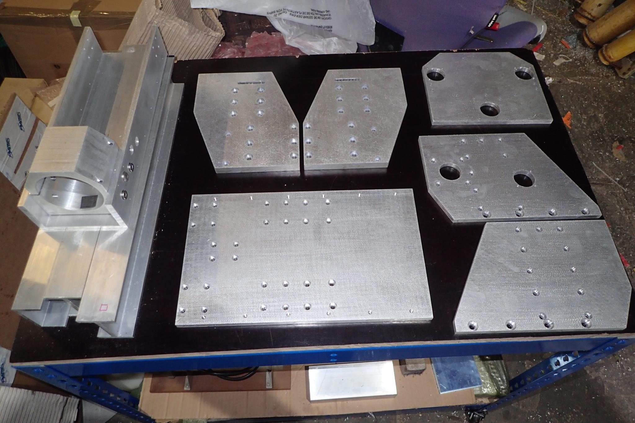

    I've been cracking on with stuff the last few days, here's a pic of some of the parts:
    From LHS clockwise we have Z axis slide with clamp sitting on top of the bed cross beams, front bed end plates, Z axis top plate, gantry end plates and the Z axis back plate. Just hit a bit of a snag though - the big bit of plate for the top of the bed has been cut well off square by the folk at Smiths - thus even with the 2mm tolerance oversize by the time it's trued up it will be 2mm short causing a few major headaches - I will be bending their ears on Tuesday

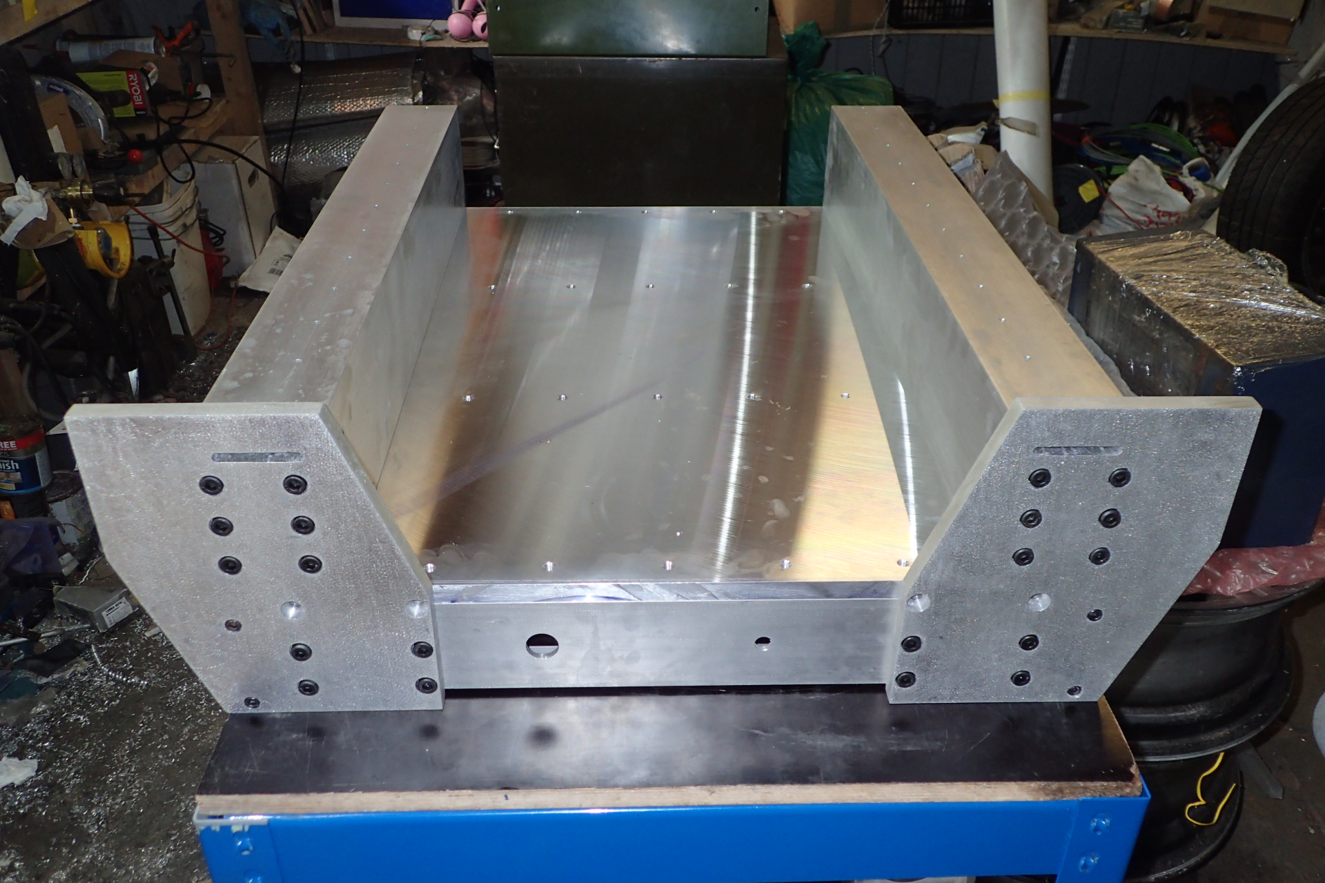

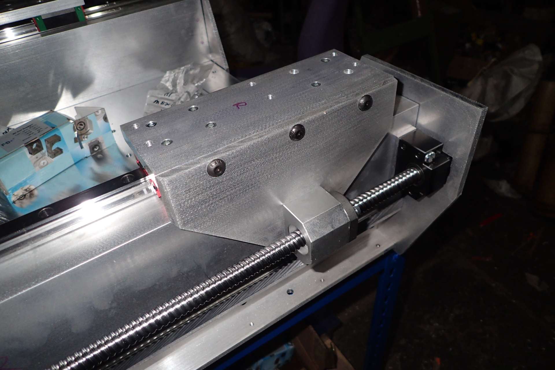

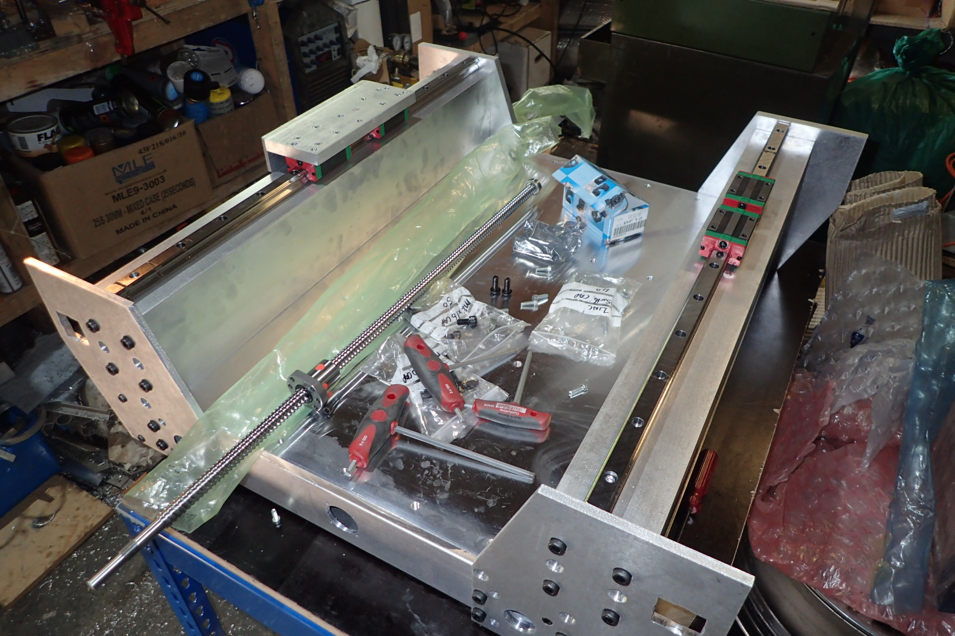

    Yesterday and today I've been assembling the various parts of the bed/Y-axis to check fit before doing a bit of anodising.
    All went reasonably well apart from a couple of screw heads (that need to be moved) fouling stepper motor bodies and a small CAD error on the carriage side plates that I'd transferred really precisely into metal - time to get the file out!
