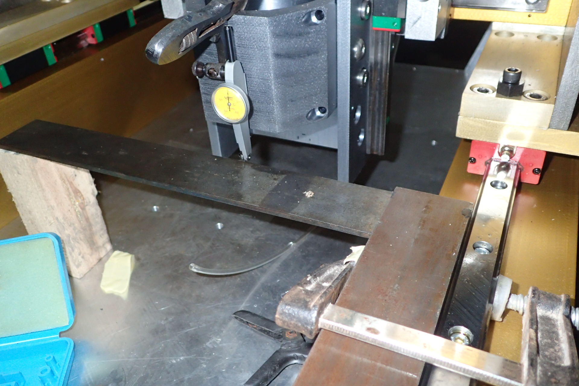

    So I've finally got all axes working. Next job was to square up the gantry; first I got it roughly right by eye and some shoving/using the Y motors independently, then fine trimmed it with the eccentric bushings on the carriage plates using a fine DTI and a large square left by my late father. It's true to about 10u now

    Does the software/motion controller you are using support proper gantry homing/squaring? I'm wondering because you talk about mechanical adjustments but I assume you will still be at the mercy of the homing routine at the start of any cutting session?
  6. #36
    What do you mean by proper gantry squaring?
    Both Mach3 and UCCNC have a good working gantry squaring routine. At homing both axes will move together until one axis will reach the home sensor, then that axis will stop and the other will continue until it will also reach its home sensor. After this, both axes will move back off the sensors and the homing/squaring is finished..
    I think it is also possible , with a macro, to add an offset distance between the sensors if it is difficult to adjust the sensors distance for the gantry squaring.
  7. #37
    That's pretty much what I mean by proper gantry squaring - the software understands the hardware configuration and does the right thing with both ends of the gantry. The main thing that prompted my question was that the previous post described very accurate mechanical squaring but I wasn't sure how that tied into the software-initiated homing which would be used for normal operation.
    I've been using Mach3 for a few years now but I wasn't aware that it understood the concept of master-slave axes. I use Mach3 with a CSMIO-IP/M and it's the motion controller firmware that takes over the homing function from Mach3. Unfortunately that firmware does not include the ability to square a gantry during homing - in effect, it just runs both master and slave in synchronism and you have to find another way to square the gantry. In fact (as someone pointed out on this forum a while ago) you can go into the CSMIO config menu and disable slaving. I then use a specific homing macro that homes X and A simultaneously; both ends of the gantry move to their home position but you do need to separately adjust the two homing sensors so that the gantry is square when it is homed. Once homed, you reconfigure slaving and it all works fine from that point on. Assuming that you don't hit e-stop or that anything serious happens, the gantry retains its "squareness" for the rest of the session, even if rehomed the usual way.
    However, you have made me think a little more about this, and I suspect that because I separate X and A for homing, I could use the Mach3 homing offset parameter on A to provide the squaring correction more easily than trying to tweak a proximity sensor. I'll look into that.
