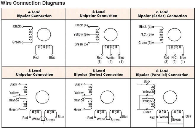

    Hello Gustavo! Welcome to the forum!
    There are three types of connection for a stepper motor, unipolar, bipolar series and bipolar parallel. Nowadays most are wired bipolar parallel because they give best performance. Compared to bipolar parallel, the biplolar series has the same torque but it drops twice as fast at high speed. This gives half the maximum usable speed of a bipolar parallel. The unipolar wiring has the same speed performance as the bipolar parallel but only half the torque to start with. Old motors were wired unipolar as the drivers was easier to build and cheaper.
    Unfortunately with 6 wires you are unable to go bipolar parallel.
    Paul.
    edit: The 50 V drivers are a limiting factor for you regarding speed. Probably you will want to go half coil for better speed even with lower torque. But I'm only guessing as I don't know any details about your CNC build.

    To make things more clear, with your 6 wire motors and bipolar drivers you have only two possibilities. Bipolar series or half-coil.
    With bipolar series you get better torque at very low speeds. It could be useful for a 4th rotating axis for example. Since in bipolar series the rated inductance will increase four times you will need a lot more voltage (than you have) for usable torque at higher speeds.
    Since you need some decent speed for your 1 m travel, I think the half-coil is the better choice.
    With the voltage you could go up to 20-25 times the rated voltage. If you are using unregulated PSU I would not go that close to the max. 50V.
    In half-coil you need 3A and in bipolar series 2.1A. I think the rated current is RMS but I'm not sure.
    Paul.

    Great Paul, clear like water. I buyed the wrong motors Lol.
    Thank you, I will use a regulated power supply and half coil config as you recommend.
    I can do the math with that info. I need to know what and why do what im doing.
