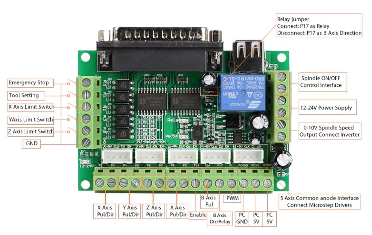

    Hello, I got a question about choosing a breakout board for my cnc. I bought a uc300eth motion controller, along with 3 dm542t drivers, now I just need the breakout board. I've seen a lot of 5 axis boards that are relatively cheap, but they say they're for Mach 3. My problem is that I can't actually find any boards for Uccnc instead of for Mach 3/4. Does it actually matter though? Are breakout boards specifically configured to a single software somehow? Or can I use a Mach 3 breakout board for Uccnc? I understand that motion controllers are specifically configured to their own software (ie- Uccnc won't work on a warp 9 smoothstepper since smoothstepper is configured to Mach 3/4). But is this the same case for breakout boards???

    Hi jtar,
    Mach is compatible with uc300eth.
    UCCNC is exclusive to UCx controllers.
    What version uc300eth do you have? 5lpt?
    I have that one and used the cheap 5 axis board.(2 of them)
    Mine came with the PP flatcable, port 2 and 3 are standard compatible with those.
    The 5 axis bob is 1 on 1 compatible on port 2 and 3.
    There is no software in the bob.
    i had a budget consideration, and would rather have had ub1 bob icw uc300eth.
    Hope this helps.
    Grtz Bert.

    It doesn't matter if the eBay seller lists it as "Mach3" BOB. I am using this one (have two in my machine):
Name:	BOB - 5.JPG
    It is the same type as driftspin above uses. It costs less than $10 and it works well since I bought mine over two years now.
    Anyway, UCCNC requires the use of controllers from CNC Drive.
    My take is that its all a matter of 0's and 1's and if the board has enough connections and you assign them to the functions you need there ought not to be a problem.I used the much maligned DB25-1205 board that came bundled with my Long's motor kit to run with LinuxCNC and it works.I might not be able to produce parts at the rate of a large furniture factory but for a hobby machine I have no complaints.
