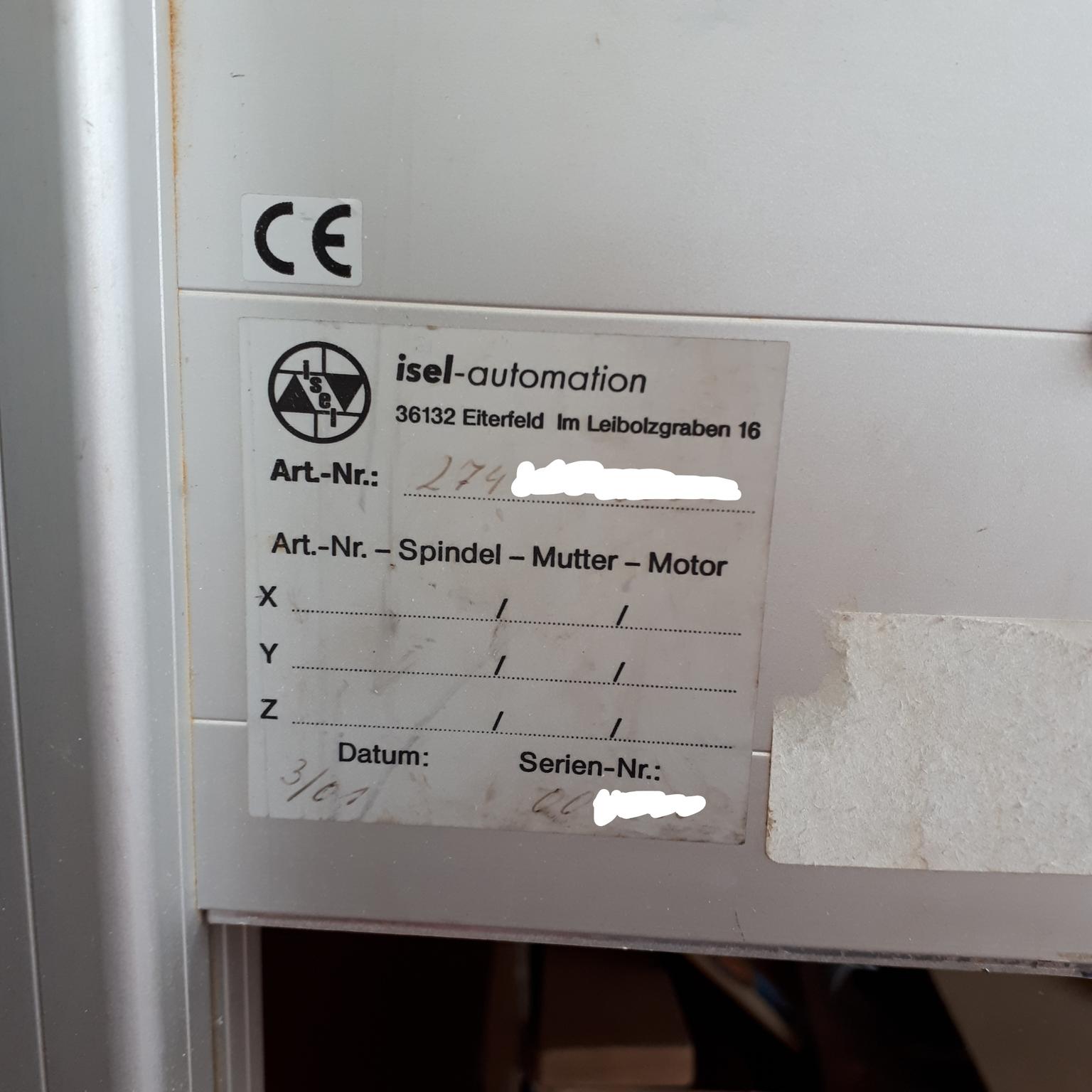

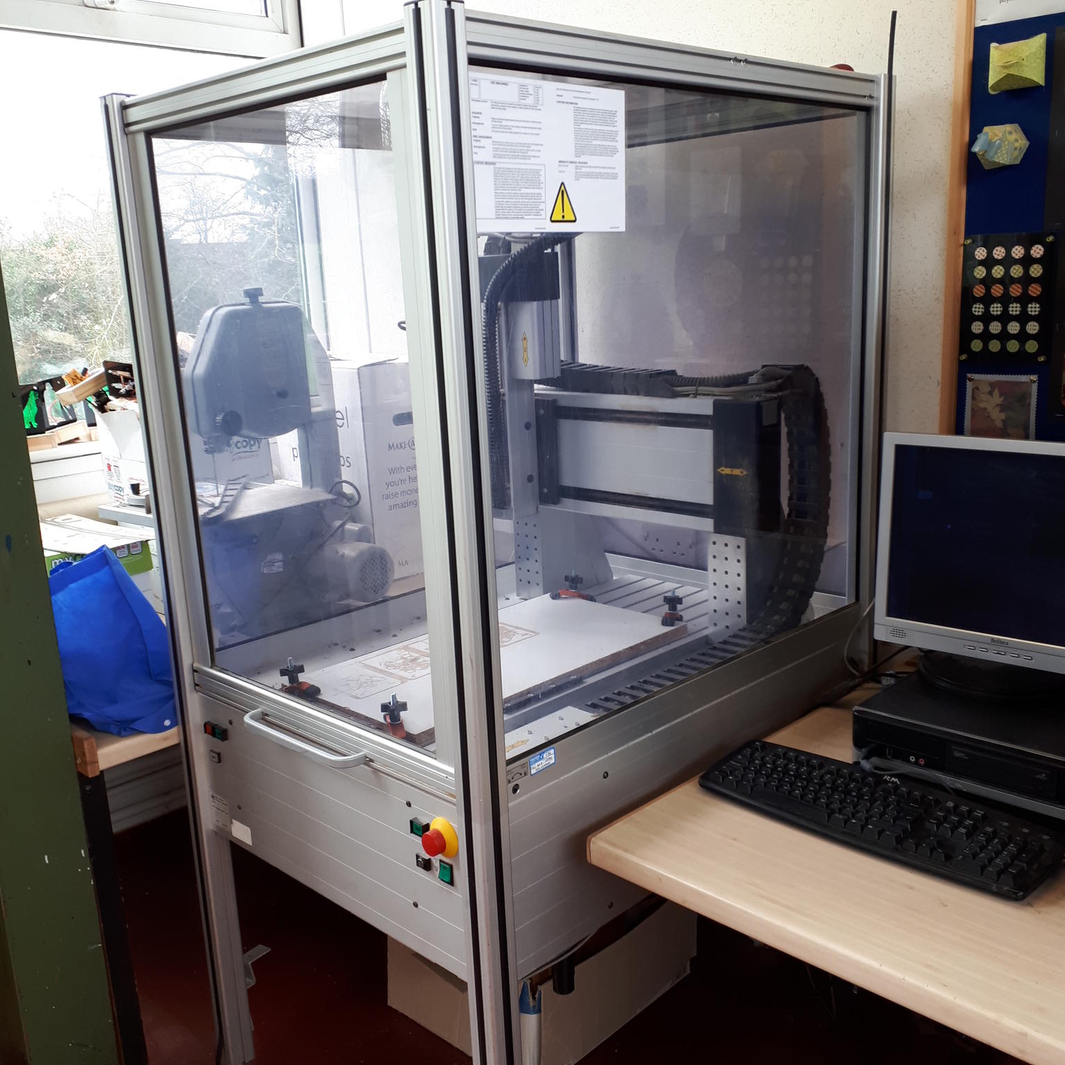

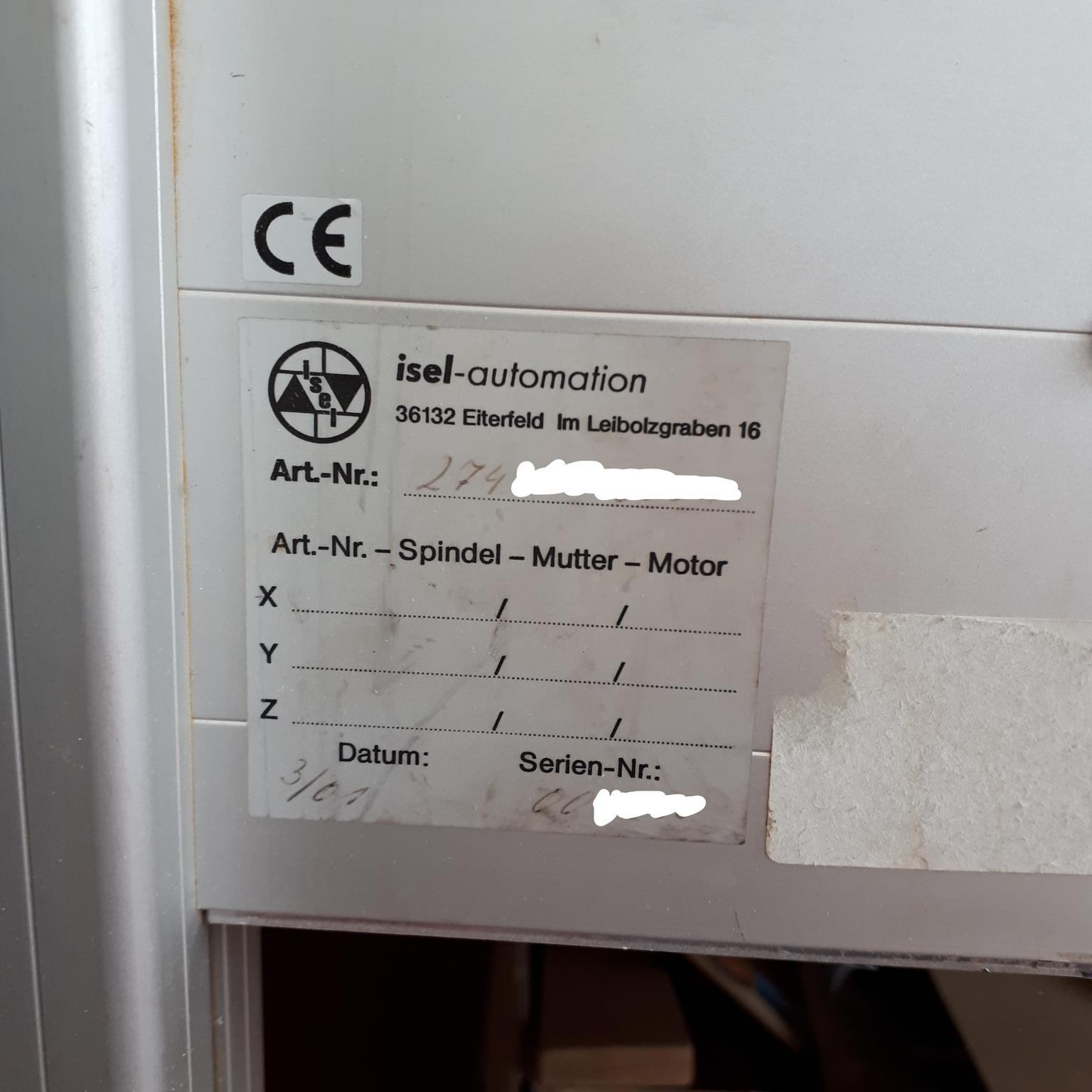

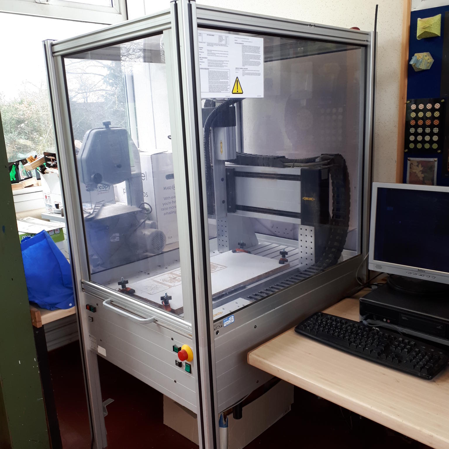

    I have attached photos of the machine. I think it is a genuine ISEL machine - I am buying it from a school who have are the 2nd owners. Click image for larger version.

    Thanks John,

    It may require you (or be easier for you) to take strip out the electronics back to the axis drive motors, and re-introduce stepper drivers (assuming stepper motors), BoB and maybe PSU. It's not difficult and for the tiny price that you're paying for the machine you'll get a capable machine for very little outlay.
    Re-using the existing electronics? - get some control-box images as previously suggested.
    the machine looks like it is worth the money without the electronics
    the base of the machine is large enough to house the electronics
    if it has a RS232 serial connection to the PC
    I expect it has a motion controller that only works with propriety software and would not work with mach 3 or 4
    the devil is going to be in the detail but
    replacing the existing motion controller with some thing like Warp9's Ethernet SmoothStepper (£55) could be an option *
    if you can re use the existing stepper drivers and power supply
    ( *a generic breakout board connected to an old PC's parallel printer port will be cheaper)
    the spindle motor speed control used will determine how easy it will be to re use the existing spindle
