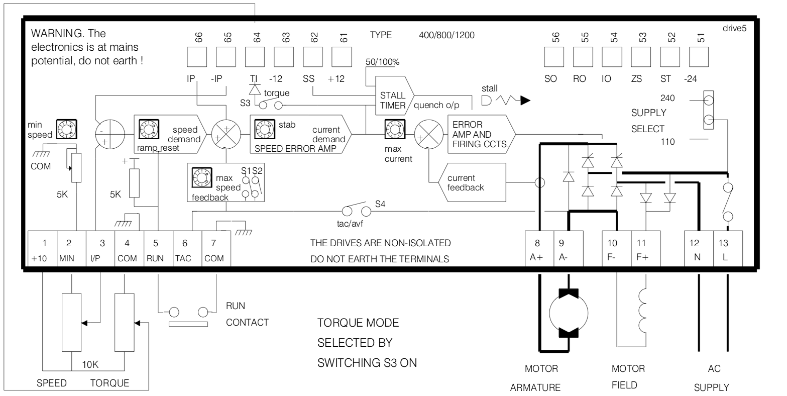

  5. #13
    Now I am confused. Pins 16 & 17 (spindle on/dir) go from BOB to spindle 5 board but it's the sprint that starts the spindle and I can't see how the sprint gets a signal to start the motor.
  6. The Following 2 Users Say Thank You to ngwagwa For This Useful Post:
  7. #14
    My guess?, and it is a guess... the Sprint is configured such that a non-zero demand on the analogue input starts the spindle-motor. That short-cuts the need for a FOR/REV control.
    Doesn't work for the Chinese VFD. You still need to source the spindle relay outputs through the BoB (and optionally through the Spindle V5) to the VFD
    What's happening with Pin 5 of the Sprint controller?
  14. The Following 2 Users Say Thank You to Doddy For This Useful Post:
  15. #18
    Com and run have just over 9 volts all the time
  16. The Following 2 Users Say Thank You to ngwagwa For This Useful Post:
  17. #19
    Quote Originally Posted by ngwagwa View Post
    With the pin-out as-shown in the manual there should be approx 5 volts between COM and RUN.
    No shorting link between COM and RUN? With power off (and discharged for 20 minutes) what's the resistance between COM and RUN?
    This is all a bit of a distraction to explain why the Sprint/Spindle Motor doesn't need a separate signal from the BoB - it's kind of irrelevant - as above you need to source a motor-run from the BoB/SpindleV5
  18. The Following 2 Users Say Thank You to Doddy For This Useful Post:
  19. #20
    Have now found out there is a jumper removed from the BOB which disables the onboard relay and enables the port used for the Spindle 5.
  20. The Following 2 Users Say Thank You to ngwagwa For This Useful Post:
