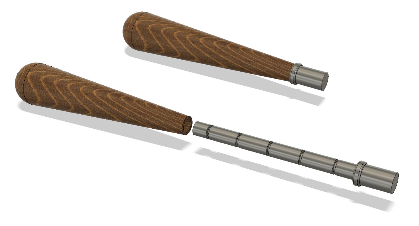

    i am designing a handheld tool. i am needing to adhere the wood to the metal stem.
    as you can see (i have cut parts of the metal so as to trap some of the epoxy.
    however, is that even necessary?
    and as far as the bore size goes for the wood - how much room/tolerance should i provide for the metal stem to fit?
    regards -
    jón

    Most good quality 2 part epoxy's will do the job. Use the slow setting ones they set stronger and give you more working time. A couple of grooves will be more than enough to stop the rod pulling out although I would recommend some flats on the metal if there is going to be any torque on the metal just in case. Rough sanding or bad turning techniqe would probably improve the adhesion of the epoxy. A good trick is to warm the metal and epoxy which will make it thin and runny. Maybe a thin groove the length of the rod will help the epoxy out when you push the rod in otherwise if it's to tight you'll never get it in. Don't forget to use properly seasoned wood otherwise you'll have problems. Some Danish oil would be a good finish (a couple of coats Rustins ) Alternativly you could use a thin super glue the fit between metal and wood would have to be close but not dead tight and just let cappiliary action soak the glue down the rod. One benefit of the thin super glue is that it soaks into the wood and helps strnghten it. How much tolerence you'll need you'll have to try out viscosity of the glue is going to vary. Whats the tool for ?

    All the above is sound advice - all I'll add is to make sure the metal part is properly degreased, otherwise adhesion won't be great.

    thanks for the information and clarity andrew. considering that i have 0 experience in this field - could you take a moment and possibly suggest which 2 part epoxies i might best use?
    the tool will be used as a roller - as it will be pressed down. there will be no pulling of the metal per say.

    Adhesive wise, I'd use a Polyurethane Adhesive Sealant, they are used to fix vehicle body panels and windscreens and are flexible enough to withstand a lot of abuse whilst providing a firm hold in an application like yours.

    I use EA40 from Smooth-on. NEVER had an issue with that. Very good epoxy.
    West systems is also very good.
