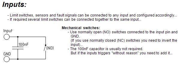

    Hi sorry if this is in the incorrect place, but i have built a Cnc machine all ali but i have a fault with the estops
    the cable for the motors is all shielded but the Estops are not, they use five core telephone cable.
    i think its the Earths .
    i have a filter before the vfd which is plugged in to my garage socket, the vfd is out side of my control box and then the wire to the spindle which is shielded.
    the motors have shielded cable but are not earthed. the top and bottom of it is i am crap at electrics and need to know what to earth and what not to earth
    and where, if some one could point me in the right direction that would be a great help.
    I use Estlcam Cam software
    with and Arduino
    Nema 23 Longs
    Longs DM542A drivers

    The motors, spindle, and VFD all put out quite strong and varying magnetic fields, which induce small voltages in the cables around them. The VFD can also pump electrical noise back into the mains supply, which can also cause problems.
    As magicminer says, you can use shielded twisted pair cable for your E-Stop line which should help to reduce the influence of the inducted noise.
    Magicminers other suggestion was to put more cable distance between the VFD and the control system power supply, which will slowly attenuate the noise. A 5-way plug doesn't really do anything - its cable length, and if possible filtering, that will impact this.
    At the moment, your signal is probably on (2.5V-5V) or off (0-2.5V) - meaning the noise only has to be ~ 2.5V to cause major headaches. If you increase the voltage on this line to 12V, the noise has to be on the order of 6V to cause the same problems. If you have an oscilloscope, you could measure what the level of noise is.

    Hmmm, Mega = Arduino Mega?, based on the AT MEGA 2560 MCU, still runs at 5V, but the on board regulator will provide the 5V required by the MCU. The I/O remains, however at 5V. AndyUK touches on ways to improve noise immunity, but with an Arduino-based system (and 5V logic) your best bet is to use opto-coupled inputs with a 12V (plus) input drive system onto the optos. The Arduino as-is is likely to be susceptible to noise.

    i have been told that i need to put a 100nf capacitor as per the diagram and that should work,
    thanks for the help i will get some two core shielded cable as well.
