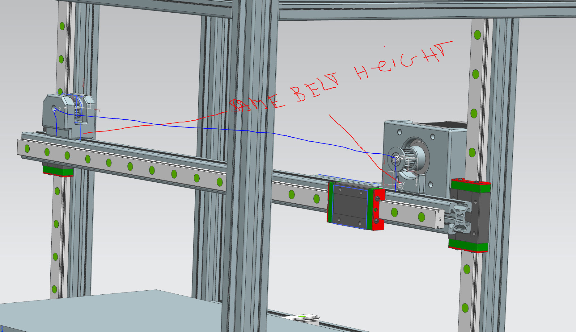

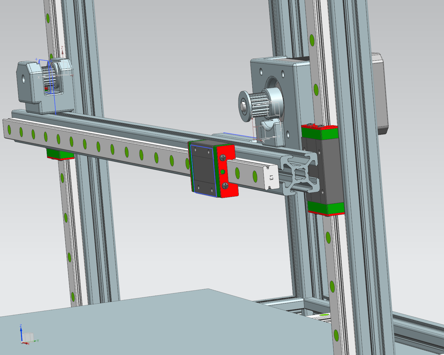

    Then i said to my self: but it needs a double side beams for the gantry so its more rigid, does not vibrate and you could lift it and move it without need to adjust it again Then it looked like an almost finished half aquarium. So i said to my self- aluminum profile is not so expensive so better for 20 -30 euros more i make it so that if desired sheets to be bolted to profile and printer enclosed without any further modification or extra box needed.

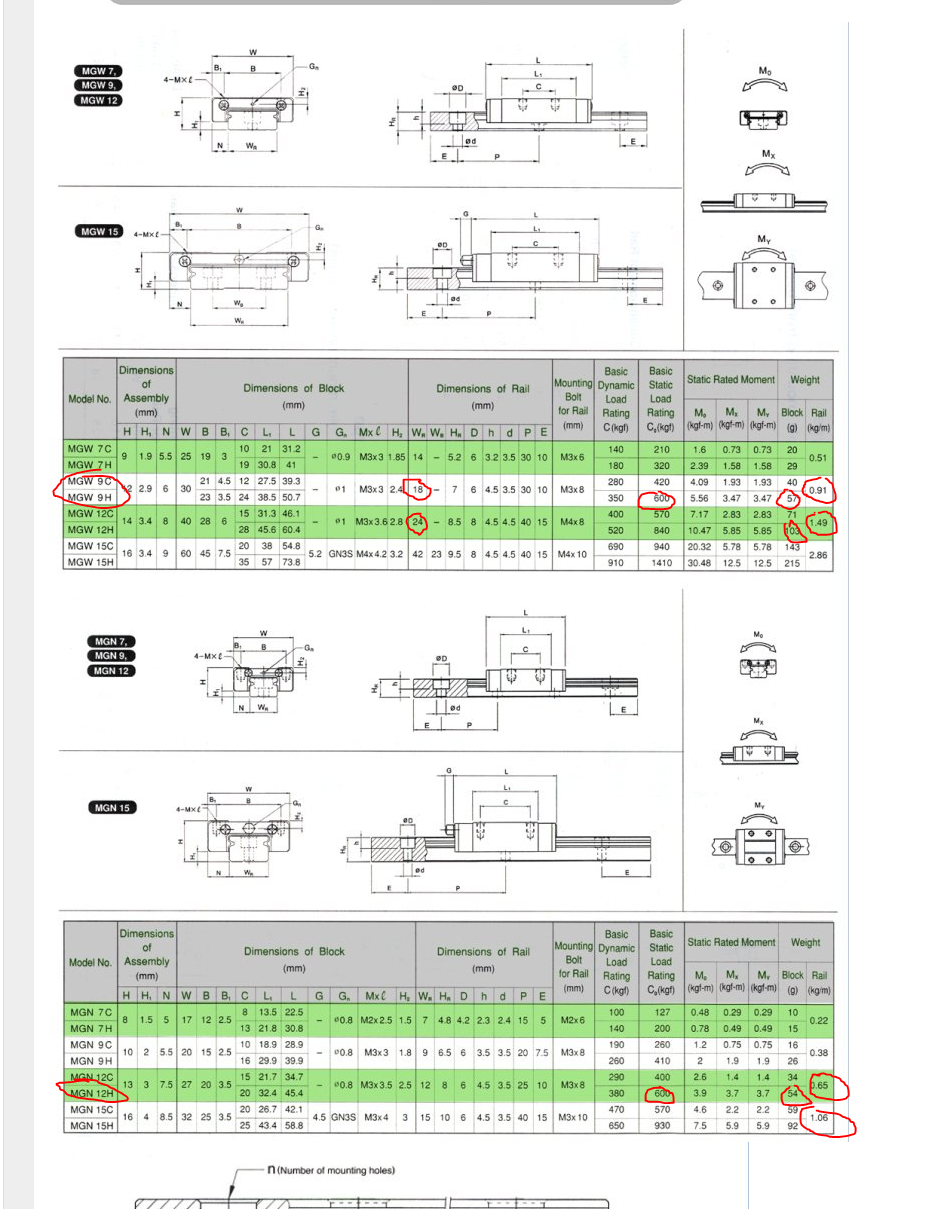

    2. The bearings.
    8mm unsupported rods do the job if bearings are quality and shafts are hardened. The printer i borrowed is around 700euro and its rods are not hardened so they are scratched already, and my friend has that from a couple of months On the other side 10mm bearings and rods could be better. Also all this talk about acceleration and printing speed. This printer here starts vibrating after 40mm/sec which according to me is the top speed that should be used. We will see the original Prusa, but what i am saying here is that 3d printing guys obviously dont know a s%^^t about rigidity and the only thing that saves them is not using the printer to make money or staff that must be precise.
    Not the case here. I intend to make money using that printer selling prints , especially after spending any money on it, and i want micro detail precision and repeatability. Obviously supported rails Hiwin. I have Zero doubts here.
    It was interesting to decide which Hiwin exactly the 9, 12 or 15 series. I am a big fan of the MGW series which i believe is the best for laser and plasma machines using single blocks
    As you see above at the snip, rail width and especially weight were main consideration as obviously 9, 12, 15 both normal or wide will work . But i believe 12H block and rail 12 size will work best as a compromise between block length, block weight, rail weight for printers up to 500x500x500 cubes.

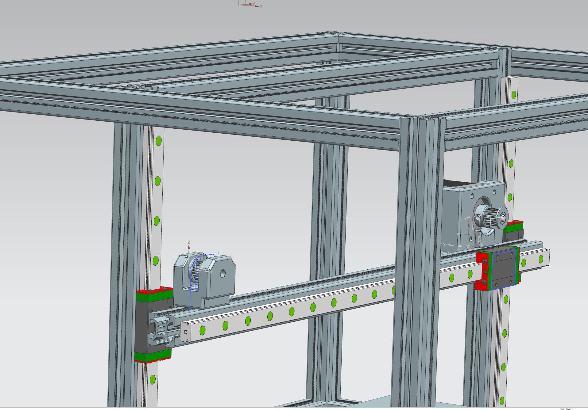

    3. Aluminum profile - 20x20
    why:
    -price 1/2 than 30x30
    -enclosed structure
    -rails size and especially the bearing block size is similar
    Aluminum profile and linear bearing size and type choice was also influenced by the fact that this printer will be able to move at servo driven speeds and the Bowden type choice.

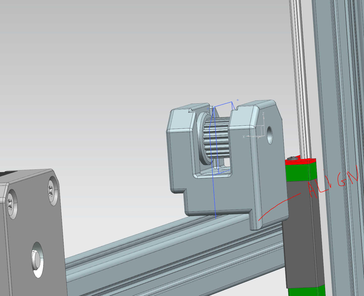

    In reprap tradition i decided to design it so that parts could be printed or milled from aluminum, without any further change to their design and withstand the scrutiny even of a hard OTT like myself, so thats a bit of a challenge here. Mostly cause i am still getting to know the plastics, but i printed here first parts today and i am quite happy. Needless to say - nothing flimsy or dubious.
    Obviously once i finish the design i will open source it, but that does not mean that anyone can change it and achieve sth mediocre instead of a truly professional printer. Time will show if i will make it so good that the design itself discourage any changes as an unnecessary waste of time.
    6. All parts must be self aligning to perpendicularity and maintaining same distances without the need of special tools when mounting. At most 1 precision square to be needed.
    check pictures bellow.
    7. All must be inside the envelope of the frame, no motors outside, etc,. So if one desires to enclose it by himself very easily, and keep warmth, noise, etc. there. Obviously the electronics have to be placed wiselt, so i think for now to be under the bed, isolated from the heat of the enclosure.

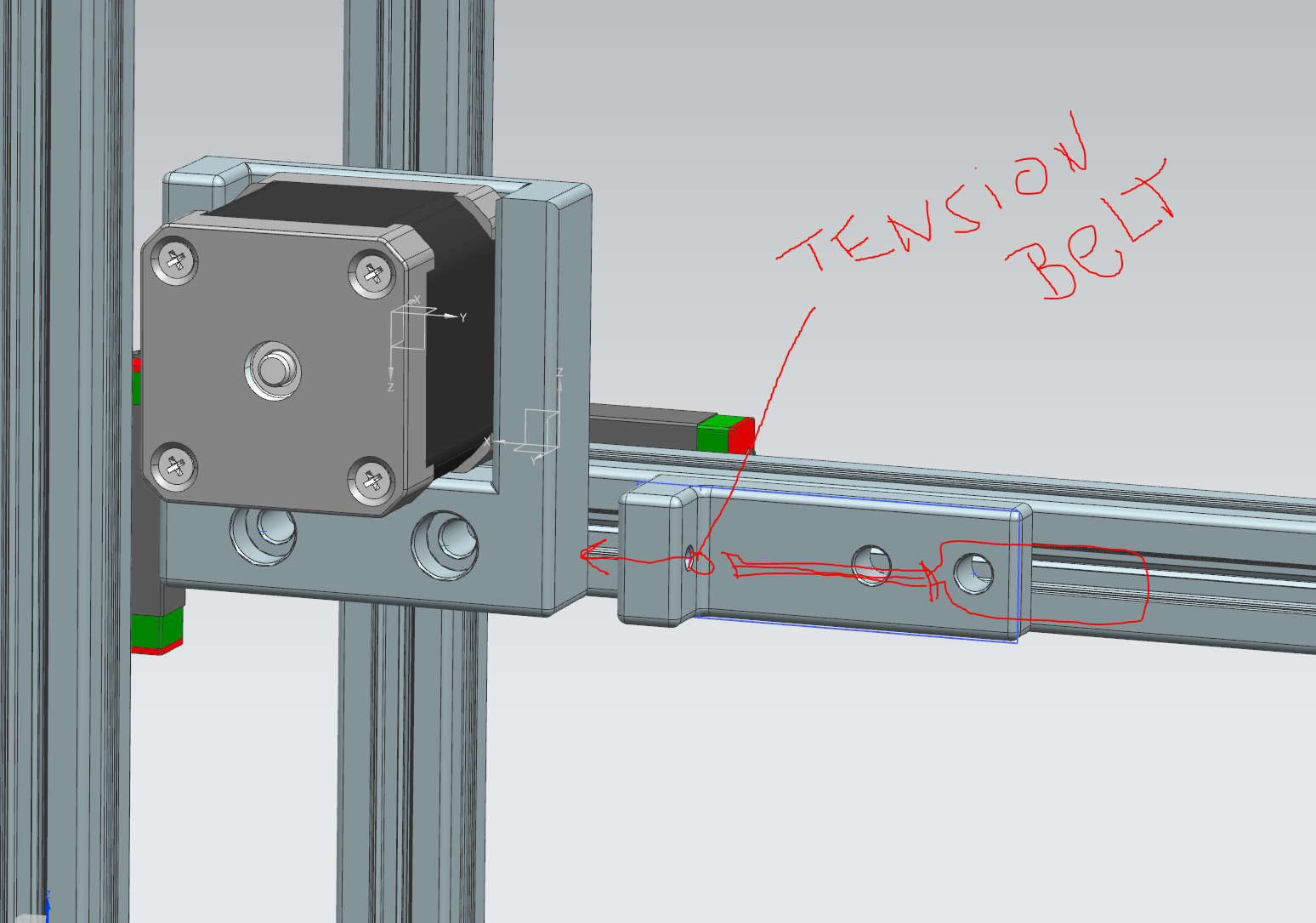

    8. Bells to be tightened to specifications easily, means each belt has to have screw tensioner. But hey, not tlike the ones i have seen, that are so flimsy and move the belt around when reaching speed.
    9. machine will be fully parametric, so design will not change at all up to 600x600x600 cube. Just lengths.

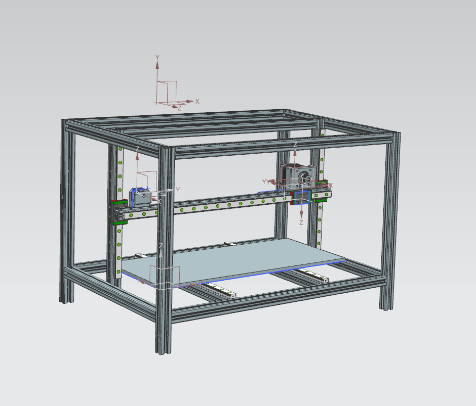

    10. last but not least: the type of design. After much consideration Core XY designs, moving Z table and so on. Let me tell you. The simplest is the best for me. Moving table, double gantry z . I am quite happy to argue and explain why. If you have questions. But its a fact and no changes.
    11. Work area size 400x200x(200-300-400)

    So here are some picture of what i have done till now, ignore rail lengths , that will still have to be adjusted so all to fit inside ,all is still in a sketch phase:

    Boyan,
    there is only one extruder worth using. It is also worth going direct drive on such a large build.
    The Bondtech extruders are E3D compatible so at least that is a good start.
    https://emvioeng.com/shop/3d-printin...ndtech-qr-3-0/
    You will need to heat the bed to allow adhesion and reduce warping. Think about how you are going to acheive this on a 6mm surface.
    The rest seems legit
    looking forward to seeing what you get up to.
