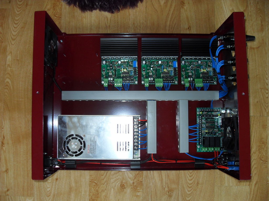

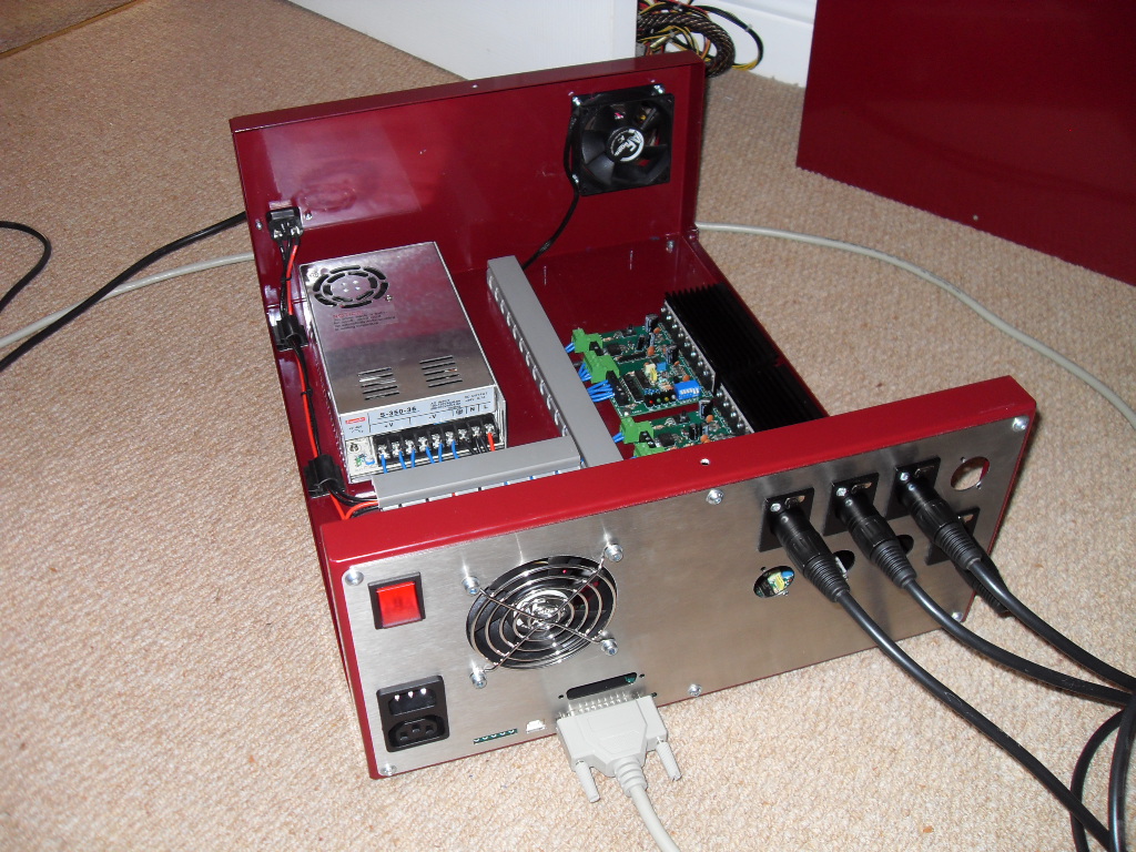

    I used 5A Driver50's for my machine (Router) with 3 x 3.1Nm (5A) 23 size steppers, got the whole electronic kit from Roy (DIYCNC) which also included a 36V PSU and breakout board for just over £300. The only thing you will need is a box to put them all in, I made my own but one or two people use PC cases, wiring them up is a piece of cake. Check out my build log which may give you a few ideas. [ame="http://www.mycncuk.com/forums/showthread.php?t=1058"]My Build - I blame you lot for this....! - MYCNCUK[/ame]
ID:	936   Click image for larger version.

    All you will need is a box to put it in, not a very big one either by the looks of it!
    But if you do go for something that needs more wires then don't worry about it, wiring drivers, steppers breakout boards is a lot easier than you think. Wiring by numbers most of the time, took me an hour to get mine up and running on the bench and that was my first attempt!
