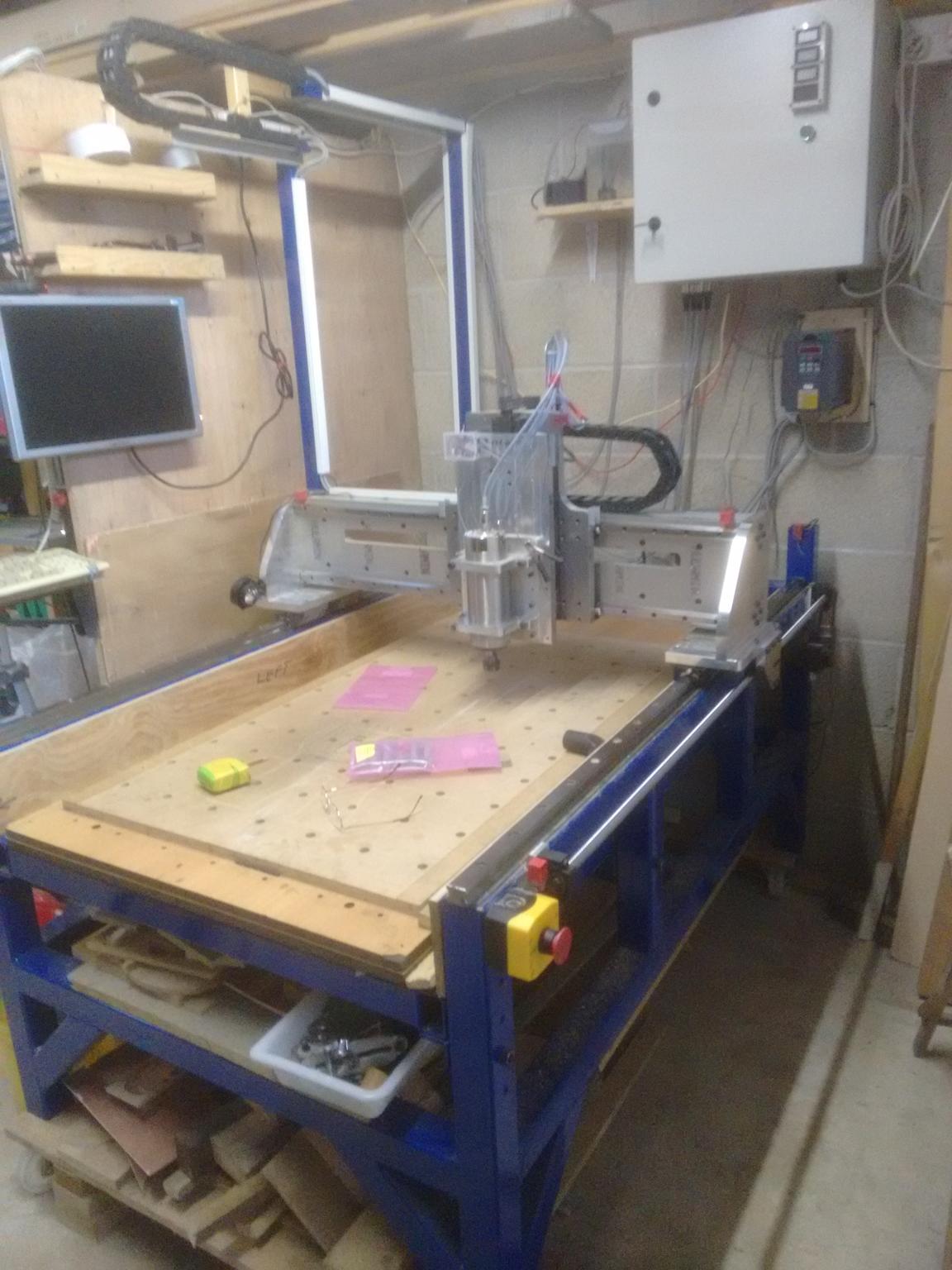

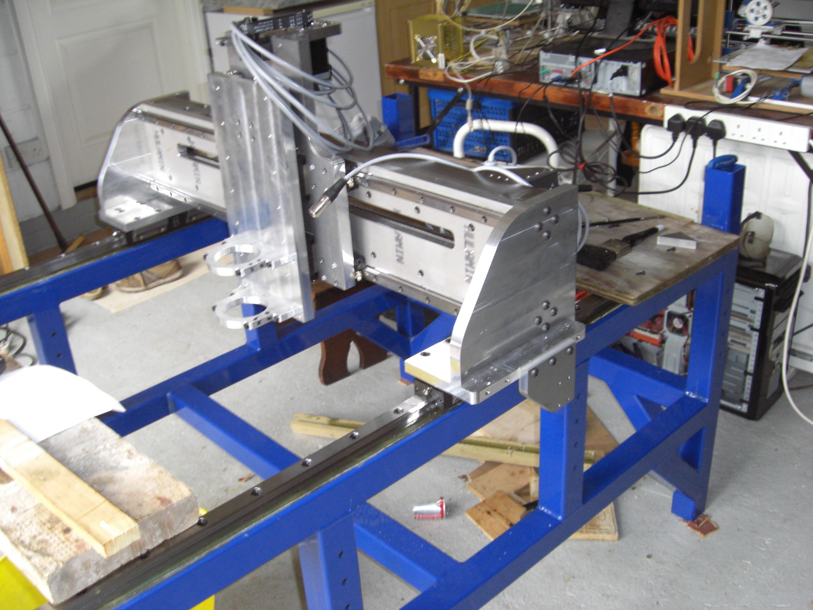

    If I understand correctly you are building a 1200x600 router. if so I personally think you are going way over the top with nema 34 motors and way over the top with the 1000Kva toroidal my router is 1600x1000 using nema 23 and a 500kva toroidal . running 68 v. I can easily get 10mtr/min rapids.
