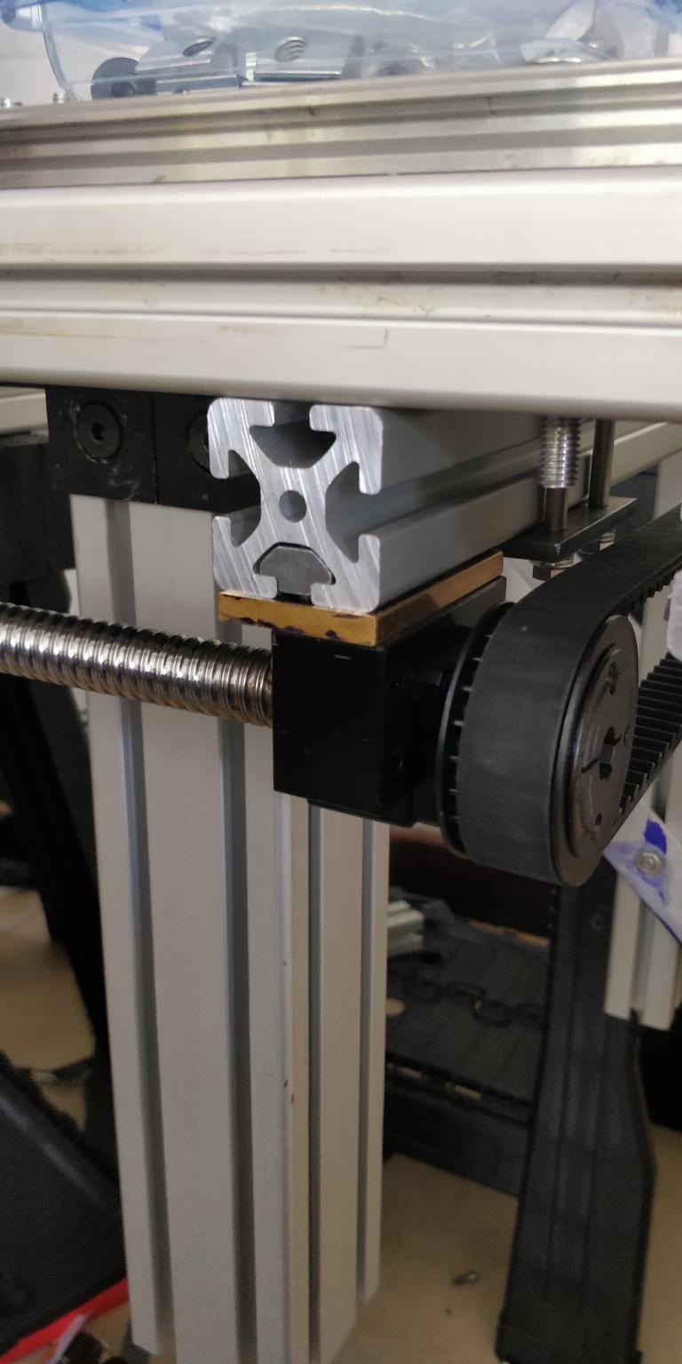

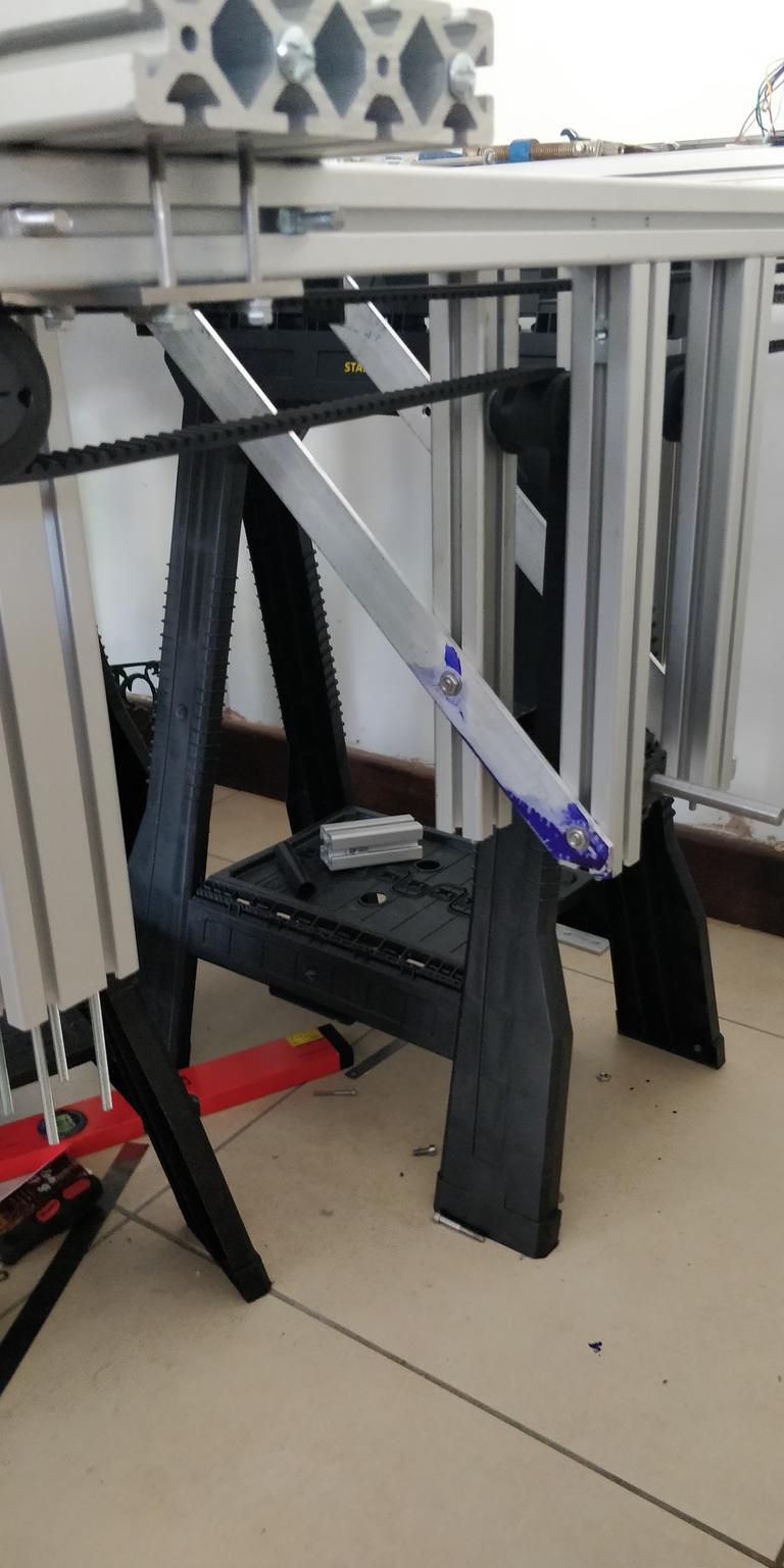

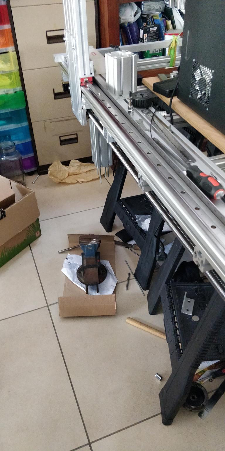

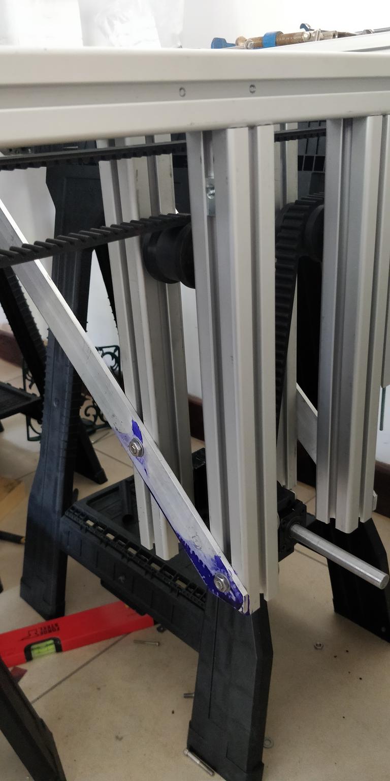

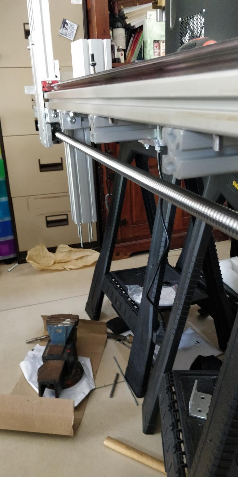

    Hi my name is Chris and I am new to CNC. I don't have an engineering background but I have always been interested in engineering and manufacturing.
    I am bullding a 4' x 2' cnc router moving gantry design. I'm aiming to cut wood plastic and occasionally aluminium. I know I've made some purchasing mistakes such as 5 mm pitch ball screws that means it will run slow but I've decided to live with this. As far as the build goes the mechanics are nearly done and i have purchased three low inductance nema 34 stepper motors for x and y (motors for moving gantry will be slaved). I have a nema 23 for z axis. I'm aiming for direct drive of the ball screws. I have already purchased a CS labs IPM controller. Next task is to decide between Mach 3 or 4 and to buy suitable stepper motor drivers and a power supply.
    Inevitably I would welcome any advice on my build. Thanks in advance ....Chris

    If you use toothed belt drive from your steppers to your ball screws you can get the movement speed you want with pulley ratios.
    I don't have a gantry machine, but if I did I'd couple the screws with pulleys and a belt to eliminate any chance of them getting out of step ;-)

    I have got it rigged at the minute with a crude belt drive to drive the gantry ball screws (so i can move gantry up and down with a power drill while im building it). I have considered running it from one motor but when i move the timing belt (20mm wide 8mm tooth pitch) manually there seems to be to much resistance. Hence why im thinking of direct drive and slave method. If i do choose the latter im thinking of putting a thinner timing belt at the far ends of the ball screw just to mechanical sync the ball screws in addition to electronically slaving the motors (this would be a safety / gantry allignment consideration).

    Excuses It helps to see pics. Its not a good idea to have a belt joining the two screws and then using two motors . Either 2 motors or 1 motor with one belt over both screws.

    Hope you can see these pictures of my machine that i have attached.

    Its not freestanding yet i'm waiting for some box section steel to arrive.
