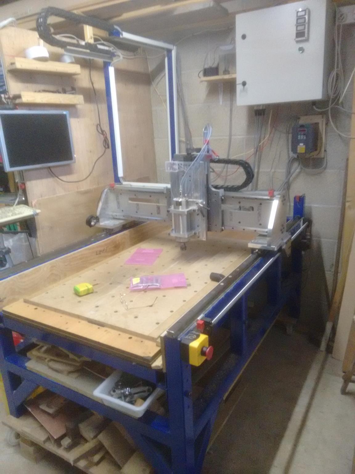

*head in hands* My mother-in-law has the same rainbow drawers - just seeing them makes me nervous about what her next 'job card' entails.
Looks like you've made some serious progress there - and your workshop is far tidier than mine I can assure you!! What are the dimensions of the machine? Looks like its got a decent amount of Z clearance.
As Clive mentioned though, you may find that a single beefier motor (I'm thinking Nema34 > 8nm) will be more appropriate with the belt drive. If they're physically connected, you won't loose sync between the screws, and you don't want to get into a situation where the motors are fighting each other.
Dropping the slave motor potentially frees up an axis and saves you buying another motor driver - it might also make a homing routine less confusing!

Z axis travel is about 130mm. I can adjust the clearance by sliding the assembly up or down the gantry uprights (the benefits of extrusion). Ive built it so I can either use a belt as you suggest or slave it without any new modification. I think your right about using the belt. Only issue is I've only got 4.6 Nm Nema 34's. I could give it a try and see if one can move the gantry ok. If not Id have to splash out on a bigger stepper motor and then id have 2 spare motors.
The Following 2 Users Say Thank You to chillybo For This Useful Post:
15-04-2019 #13
BTW its a 4x2 foot machine (roughly)
