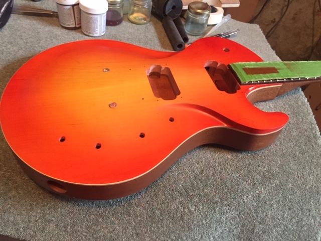

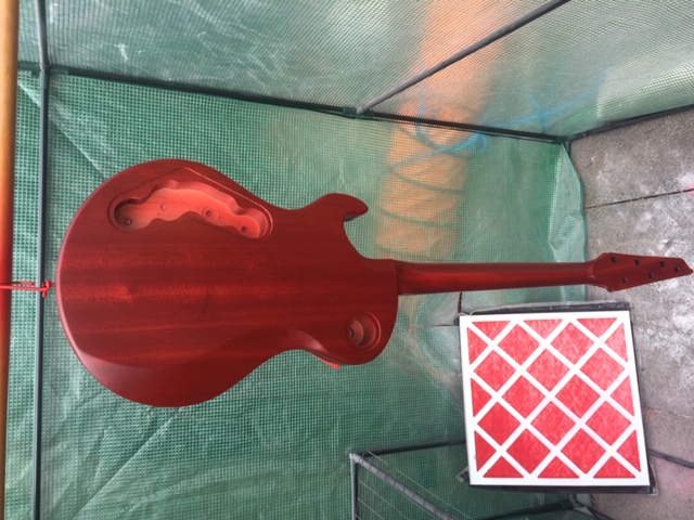

    Thanks Chris,
    A little over my head! I'm certainly no CNC expert, my work to date has stopped at the CAD point (using CAM only for inlays and fret slots). I know I'm probably putting the cart before the horse but I need a machine that will be capable of working in a way I understand - I've clearly got a lot of learning ahead of me.
    Worst case scenario, if I can at least automate template production I will already be way ahead. My latest design takes me a couple of weeks to manufacture by hand - I'm not expecting it to jump off the CNC ready for finishing:
    If I can cut the time down to 1 week I will be happy, but I need a machine that will bend to my needs rather than vice versa.
