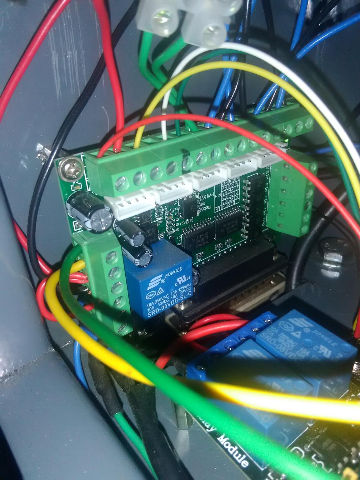

    I've attached (or at least tried to) a pic of the motor controller board (any help identifying it appreciated)
    The problem is I have no electrical diagram or means of identifying the board to ascertain how it works.
    There's 240v ac in and dc out, then there's a ribbon lead which was previously (incorrectly I think) wired to a potentiometer.

    Can you post a pic of the underside of the PCB as well please - then I can probably work out what the circuits doing.

    You're right - Pins 1+2 look to be the local +V supply from the on-board switched-mode PSU, and pin 4 is the ground. Now, pin 3 is connected to the cathode of the opto-isolator (U4), with the anode pulled up to +V via R5 (4k7?, can't make out band 3/4, think its [4][7][0][10^1]... could be wrong) - the output from the opto isolator heads off to the vertically mounted control board - which looks to be the brains of the speed control. That basically means that pin 3 is pretty much all you can use to control the motor - it could be basic PWM, or some other form of digital signalling - unclear, and would need images of front and back of vertical board to even begin to guess). What it almost certainly isn't - is any form of analogue control on the pin-3 input, so I'd bin the pot. I did wonder if the pin-3 was an spindle encoder feed-back input but the absence of any other connector would tend to suggest not.
    Connecting 3-4 spins the motor?, yeah, can see that. So presumably it is a PWM input. What you need now is a PWM controller that generates an inverted output (e.g. more "Space" than "Mark" as the demand increases). The problem is that it's hard to guess what the PWM frequency should be to generate the M/S signal. Something like that would be easy to knock up on an Arduino if you have the inclination - and would allow you to explore the speed range easily. That'd be where I'd be heading next in the absence of any data on the board. You could instead experiment with (I assume you're using Mach3?) the PWM output from the BoB (if available) - don't use the analogue output. Or, re-map the Mach PWM output pin to an unused axis on the BoB and use that to drive the PWM input to the speed controller.
    You say you can get the motor to Start AND Reverse?, there must be some other control/switchgear to support that - this only allows a variable 0-XX VDC to the supply, so it should be unidirectional. Is there other switchgear? (heading off on a tangent since this doesn't really address the speed control issue).

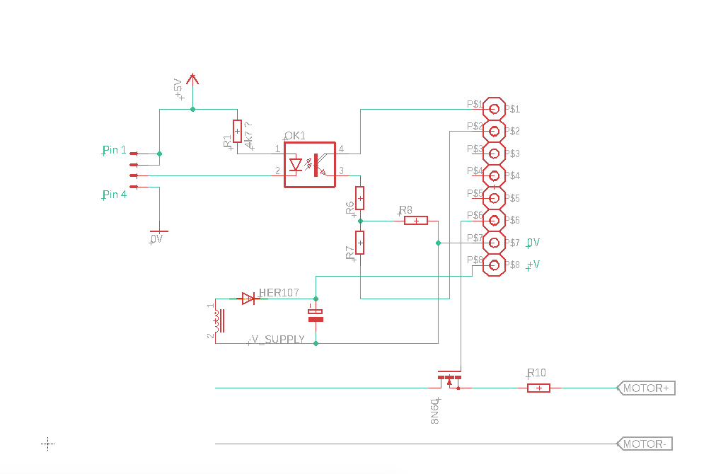

    Rough-arse sketch of the signalling around the ribbon...

    It's only a partial schematic after the opto-isolator, what I'm trying to get at is that the only control you have is the signalling between pin 3 and 4 of the ribbon - that's where you have to introduce a digital PWM signal.

    The direction is switched via relays on the other board (I assume as they click when direction is programmed), the voltage from the breakout board when I mdi input s240 m4 is 0.5v, then at s500 measures 1.0v, at s1000 2.0v etc etc.
    Are you advocating connection of the + PWM lead from the breakout board go to wire 3 and the other pwm to wire 4?
    I did say electrics are not my field!

    Okay, I don't know your BoB - but looks pretty generic. That makes me think that the "outputs" from the controlling PC will be buffered with the two large chips (74HC244s?) - they'll be able to drive the PWM output low enough to activate the opto-isolator, and so *should* work (or at least not blow anything up). Suck it and see. My other comment was thinking that if, and I don't know about this, but if the BoB doesn't output the standard PWM pin out, but instead only provides the resulting analogue drive, then instead of trying to route the standard PWM, use the other outputs that are associated with the typical 4/5 axis drives on the BoB - as these are easily available (and from within Mach its easy to remap the PWM output to any pin).
    My conversation about arduinos is simply to take an unknown (mach) out of the equation to help better understand how to drive the speed controller, but I'm presuming - perhaps too much - that that's in your interest/comfort zone. It's nothing to do with CNC but would be a great way to test the board in (almost) isolation.
