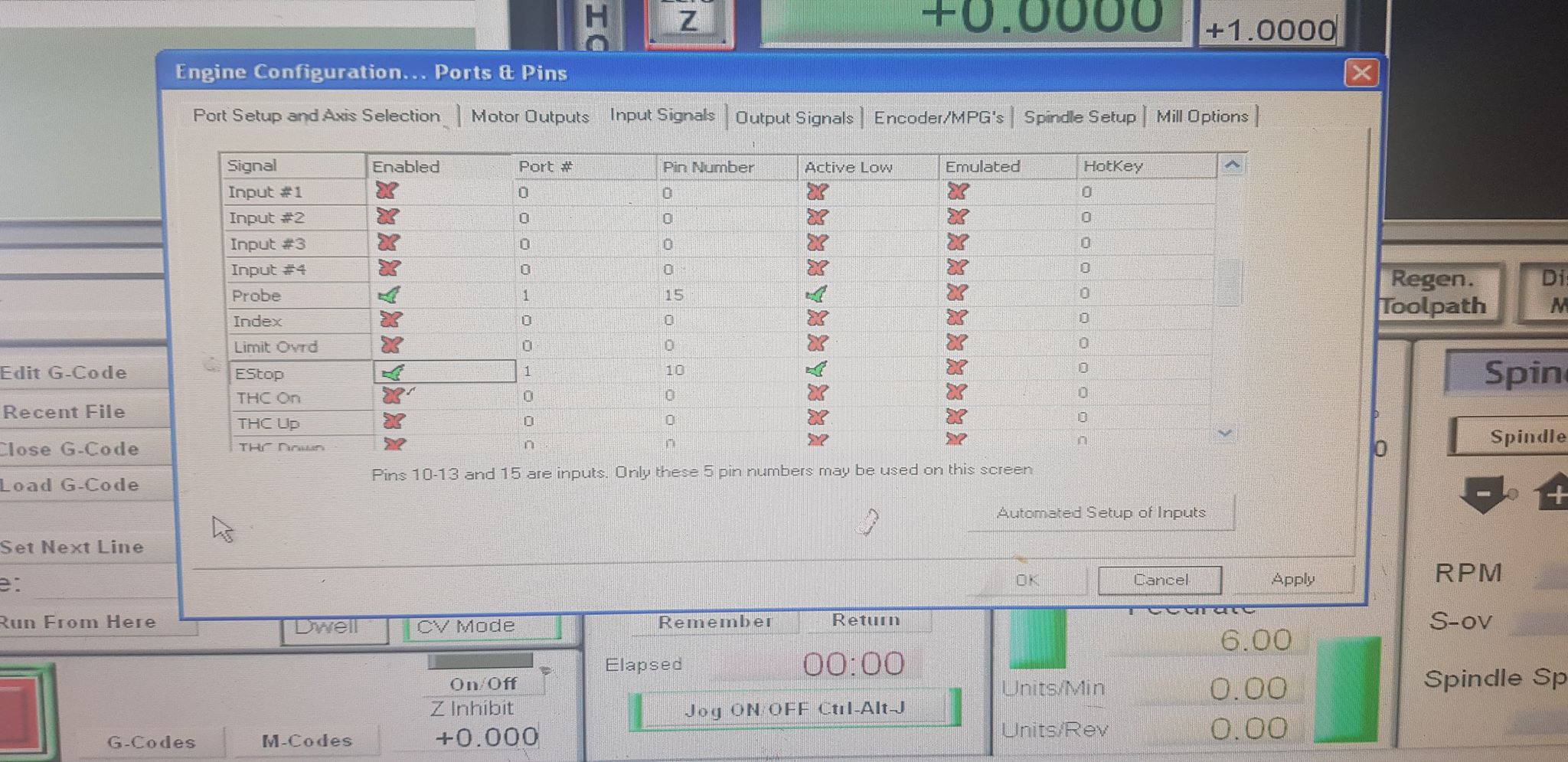

    E-stop was working prior to a re-build and install and now is deciding not to work as required. Mach 3 is not detecting any inputs on pin 10 or pin 13 respective to how I have said pin input allocated.
    I've got 5.5v between pin 4 and pin 10, then once I break the circuit via the e-stop It drops to 0v which shows it works fine.
    This is the pin allocation within mach, I've got one side of the e-stop wired into ground and the other into pin 10 and set to active low.
    Can anyone tell me am I looking at an issue within mach or a hardware issue.

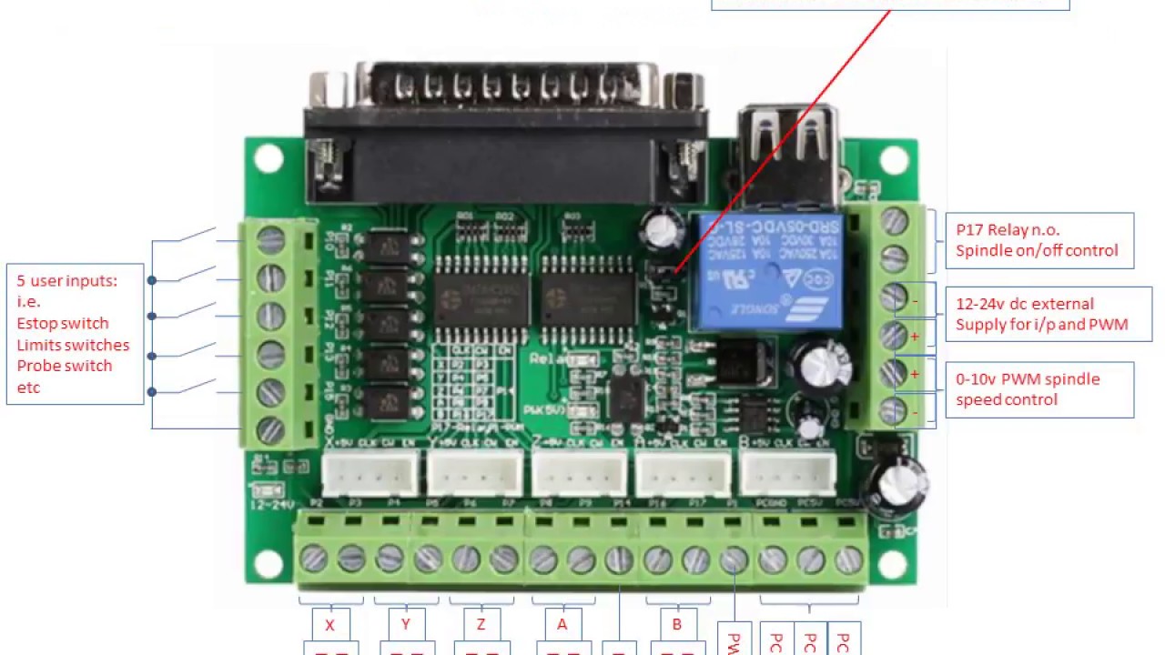

    If you go to the Diagnostics screen in Mach3 activating estop should cause a port 1 pin to alter state and the Emergency indicator to come on. If that is so you are wired up and configured correctly. I have this BoB, but unfortunately I am not able to confirm P4 is the appropriate place to take 5v as it is installed in a control box which is not easily accessible. I believe that the p10 input floats to 5v and only needs a connection to, or disconnection from, GND to activate.
    While I think about it, is the 12-24v power connected ?
    If you need the BoB manual, you can download it here:- https://www.dropbox.com/s/gfq4isvihn...rd-EN.pdf?dl=0

    You have not answered Rob's question re the 12-24v on the bob also do you have the correct port set in Mach3. Should the e-stop be connected between grd and pin 10

    Well it seems you don't wan't to answer questions. No one has a crystal ball. re. "I've got 5.5v between pin 4 and pin 10," I don't think that is the correct place to get the 5v The inputs should show about 5V between a pin and ground. The reason for asking if the 12-24V is connected is that the inputs pins won't work without it.

    Hello! Well I didn't rewire any in but I've just done so as an experiment and they trip the stop function no problem. So that got me thinking, I'll try wiring 24v straight across the E-stop and bypassing ground and that works fine so I've got that wired as such now to trip the E-stop.
