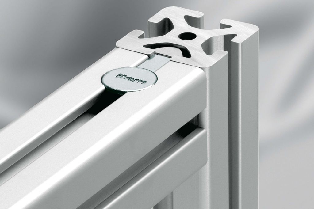

    I watched @routercnc's build on YouTube and his design served as much of the inspiration for this design. The design currently has a base made from 80x80mm heavy aluminium profile, with 100x100x5mm steel SHS to support the x-axis rails. The 45 degree bracing is 40x40mm heavy aluminium profile, and the t-slot table is 20mm thick and comes from the same company as the rest of the profile (item, there's a local distributor in Australia I have a quote from).

    Do you need to end feed sheets into the machine? If so the 45deg braces in the corners of the open end - one end could be deleted and a single horizontal connection made between the upper steel sections instead. Stiffness would still be good be access improved. Depends how you want to use it.
    Also will you drop long bolts through the steel upper section as per my build? I made custom thread inserts which ran in the lower extrusion for the bolts to go into. If this is your first machine can you make these?
    Also this needs clearance holes in the upper section for the bolt heads to drop through so draw these in to make sure they miss the rail fixings.

    I don’t specifically have a need to end feed sheets in at the moment, but it’s probably a good idea to cater for it if it doesn’t impact the stiffness.
    Regarding attaching the steel, I considered long bolts but I’m thinking of using these fasteners with the t-slot nut removed and screwed directly into a tapped hole in the bottom of the steel.
