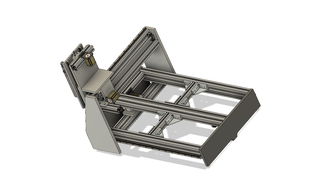

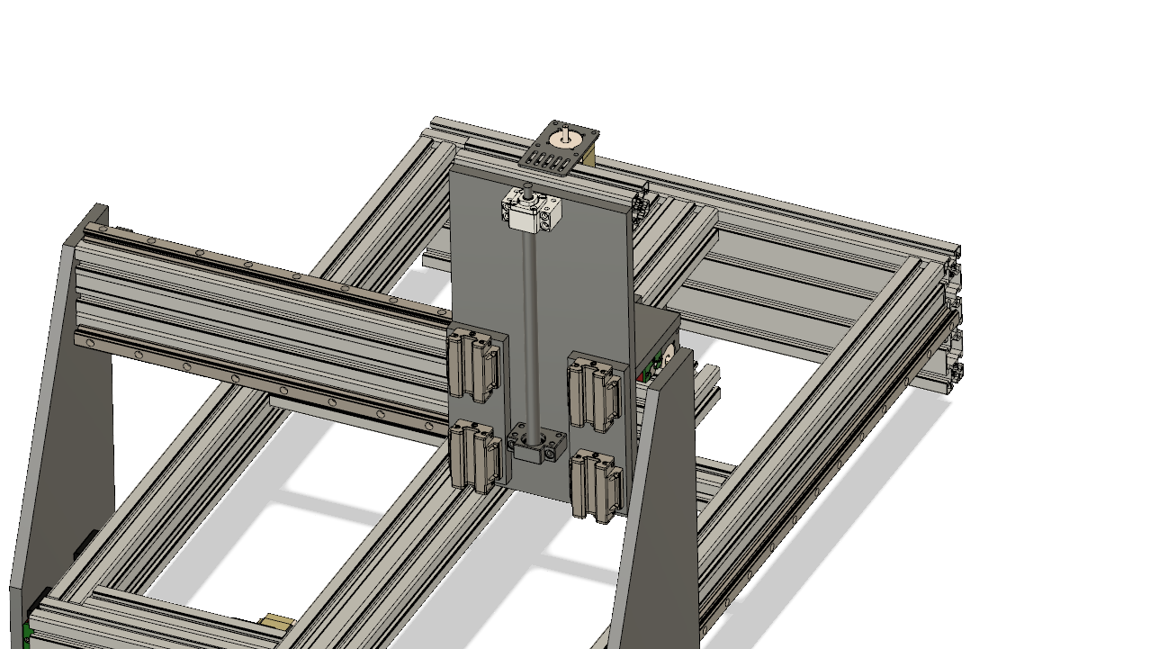

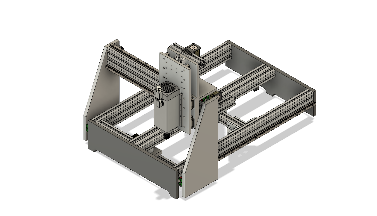

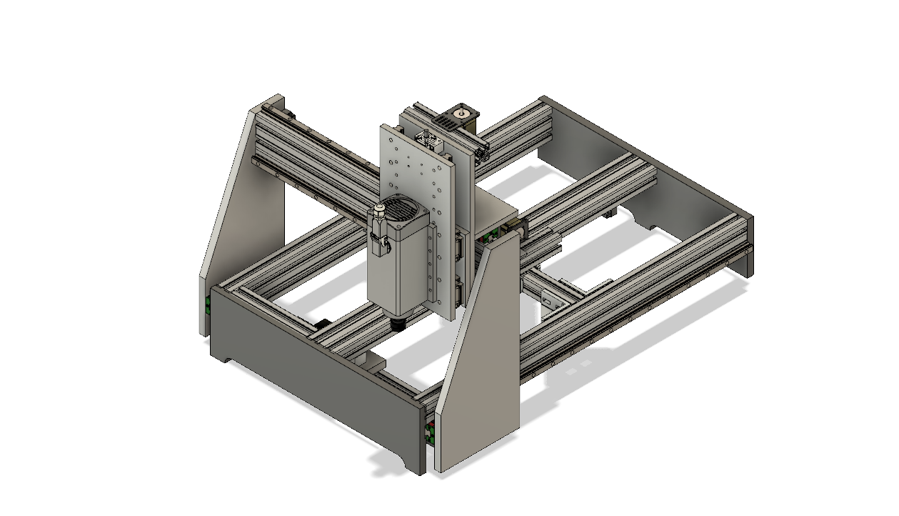

    Made a few minor updates based on the useful comments to date:
    Upped the side plates from 15mm to 20mm (I've changed my mind about using reinforcement ribs here - seems like these might increase the risk of snagging on something or someone whilst the CNC is doing its thing)
    Changed the front and back from extrusions to solid 20mm plates. Added 3 foot-like features to these so the base of the machine is basically a tripod to prevent it wobbling on the workbench.
Name:	Moving Gantry v3 - smaller v19.png
    Added some heavy duty steel brackets to the centre of the bed - I can't afford the cost or weight of a solid aluminium bed so this is my compromise. It'll all be connected to an MDF sheet lying on top of the bed structure with a 2nd MDF sheet on top of that as a spoil board.
Name:	Moving Gantry v3 - smaller v19 2.png
    Most everything else will be achieved using long screws into the extrusion cores, attaching them to the various plates.
    Won't be able to machine my big plates on any CNC I can get access to but I am hoping to get access to a Bridgeport mill so I can at least drill all of the holes in precise locations (assuming I can figure out how to use a Bridgeport!)

    Quote Originally Posted by bluesking View Post
    If you can't get access don't worry. You'd be suprised at how accurately you can place holes "the old fashioned way" using a surface plate, height gauge and optical centre punch.
