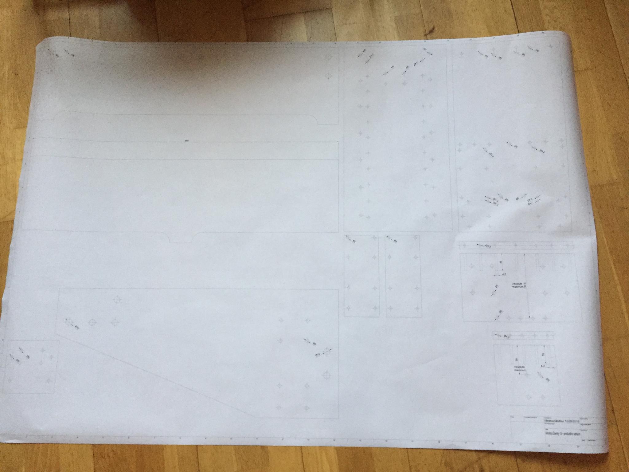

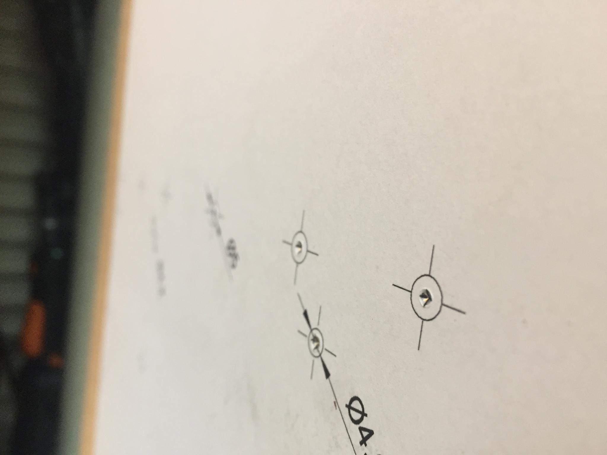

    So a short update on my build. Things are going slower than I would like. I have gathered almost all of the components I need but am still waiting on a few key things.
    Last few days I have been working on the various end plates and spacers for the machine.
    I produced a technical drawing containing all the plates from my fusion 360 model. Using the fine-line-style setting when exporting to PDF was important to produce the most accurate output. All fits on a single sheet of A0, cost about £3 to print at a local printing shop:
    Cut everything out and used spray contact adhesive to glue to the plates. Every time I use this stuff with paper I regret it. Horrible to clean up and unnecessarily strong.
    The design of the my CNC means the actual plate dimensions are not critical. You can see all my plates are cut about 2mm too big from the supplier but this doesn't matter - the key thing is that all the holes are precisely located relative to each other. There are only 2 critical plate dimensions - and these only on one edge, corresponding to the 2 butt joints in the design. Paying attention and gluing the corresponding templates right up to the butting edge should be good enough.

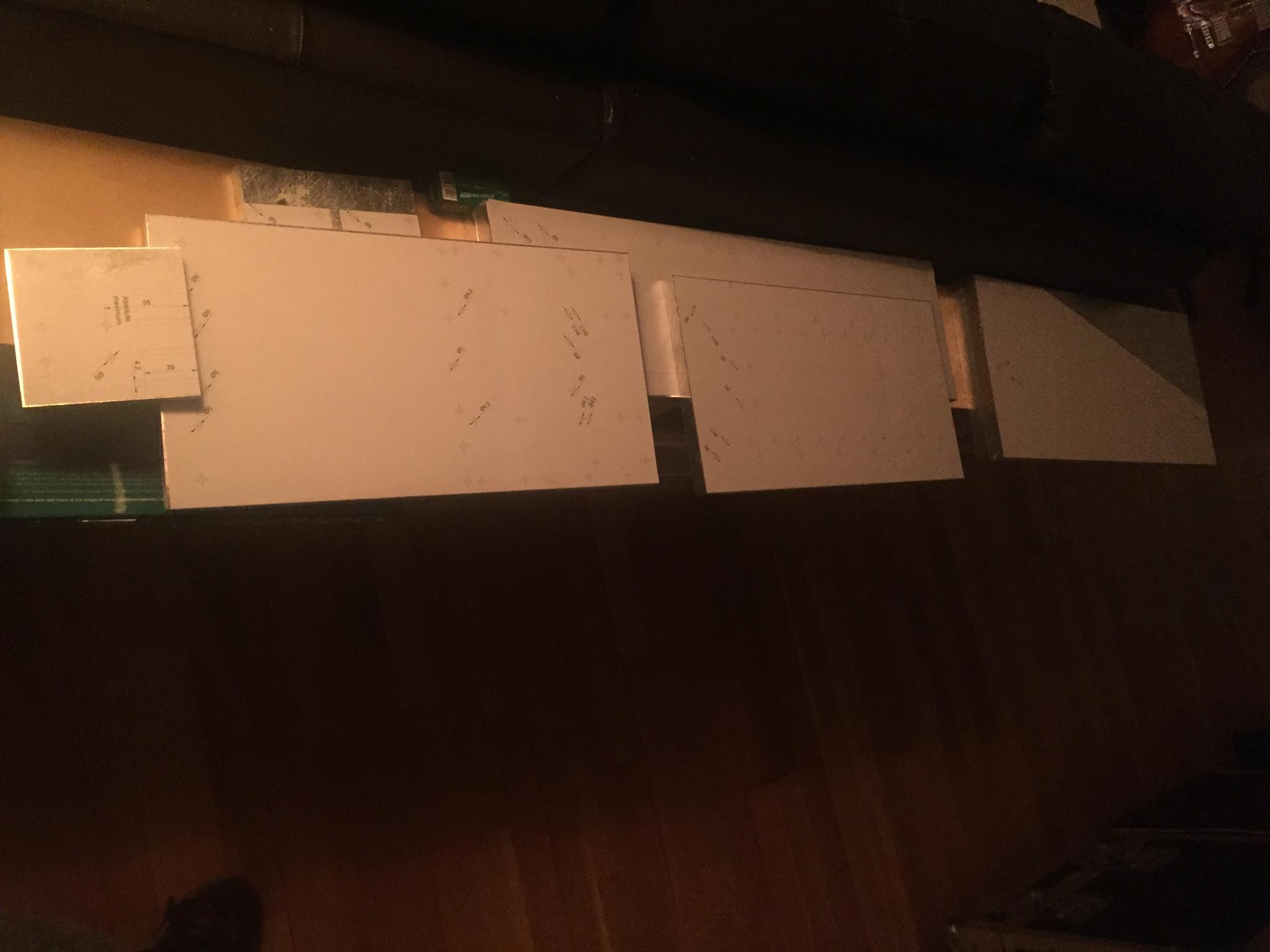

    Heres all the plates with their templates applied:

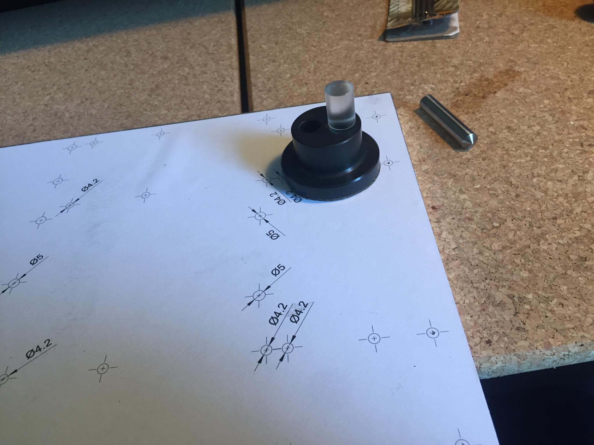

    Thanks to reading Voicecoil's posts, I bought myself an optical centre punch and had a bit of fun using it. Its fun playing with the scope, pretending you're a CNC sniper, hahaha.

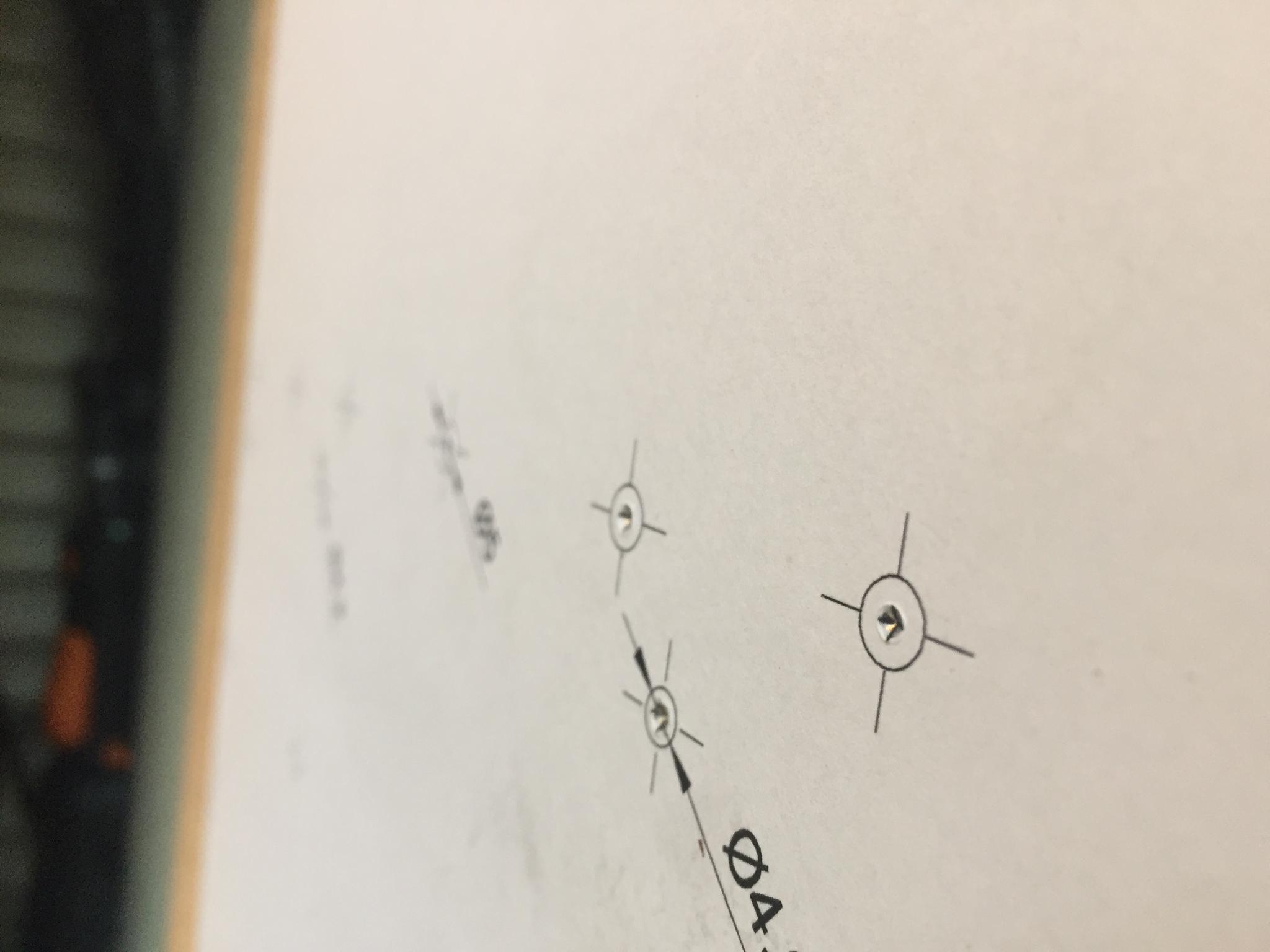

    Silliness aside, the end results look well worth it - best punching accuracy I've ever had, should have got one ages ago:

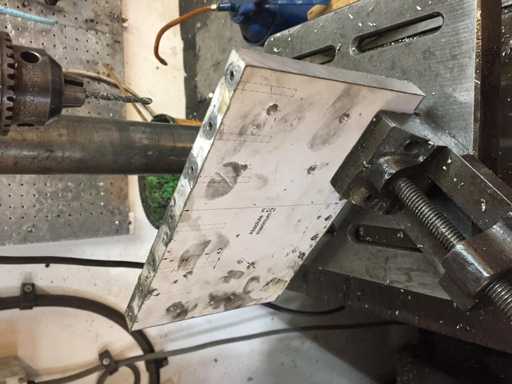

    Following on from my plate design work, yesterday I drilled the various holes:

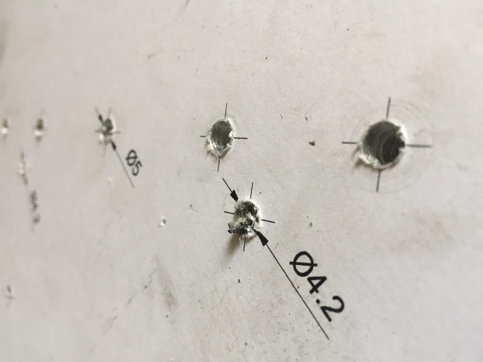

    Everything seemed to go well. I have a mixture of M5, M6 and M12 bolts to accommodate. Many of the holes don't need tapping so I created mostly 5.5, 6.5 & 13mm holes to accommodate the screws.
    I also have a bunch of M5 holes that needed tapping. Here I made a bit of a mistake. Really didn't think it would make a difference so I just used a 4mm drill bit I had laying around. Drilling went well, but as soon as I started to tap this happened:
    My lack of metalworking experience takes it's first casualty! Today I re-drilled all the offending holes and I think I got away with it overall.
    Here's what I have learned:
    1) If you want to use a M5 tap, you need a 4.2mm hole. No getting around this. Maybe 4.5mm would also work, but I didn't even try this as 4.2 worked perfectly.
    2) If you break a tap in a hole there really isn't any way to recover. You try to drill it out, but because aluminium is so much softer than hardened steel, the drill bit wanders around the tap creating a bit of a disaster.
    3) Cutting oil is a mixed blessing. Makes all the work super messy but I think improves results. If doing again I'd drill all the holes dry and use cutting oil just to do the tapping work.
    The one hole I messed up was meant to attach to one of my z-axis HIWIN carriages. I'm hoping I can get away with using only 3 out of the 4 holes to mount this. I think this will be fine so I'm not going to bother buying/making a whole new plate for now.

    Quote Originally Posted by bluesking View Post
    I bought myself an optical centre punch and had a bit of fun using it.Click image for larger version.
    If you bought it online, please could I have the link?
  9. #29
    I got mine from Axminster:
    https://www.axminster.co.uk/axminste...e-punch-100244
    On mine, the crosshair optic is out of alignment :( but the circle/dot optic is perfect :)

    Broken drills/taps in non ferous materials can be dissolved using Alum solution.
    https://www.google.com/url?sa=t&rct=...9aX0rtzdbxJhZP
    Also when tapping go with the recommended size from your Zeus book ie 4.2mm but use a solid(no flute's) spiral tap.
