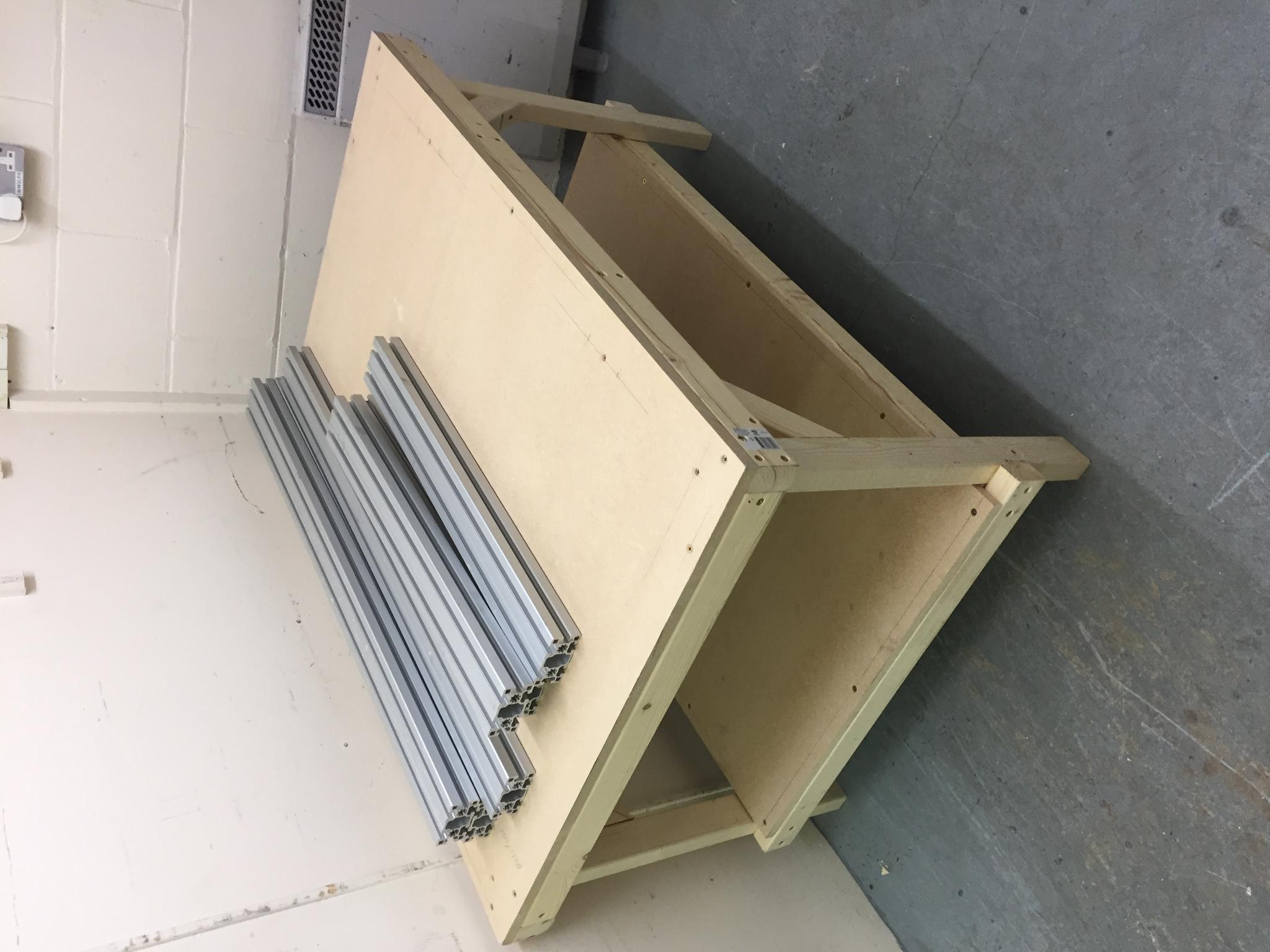

    Hi guys,
    Have not been on for a while as have been busy sorting out my new workspace and stocking up on parts. Thanks for everyone's various messages - don't have time at the mo to answer everyone individually.
    Its all go on the CNC front now my space is sorted and I have all my parts, so I wanted to post an update.

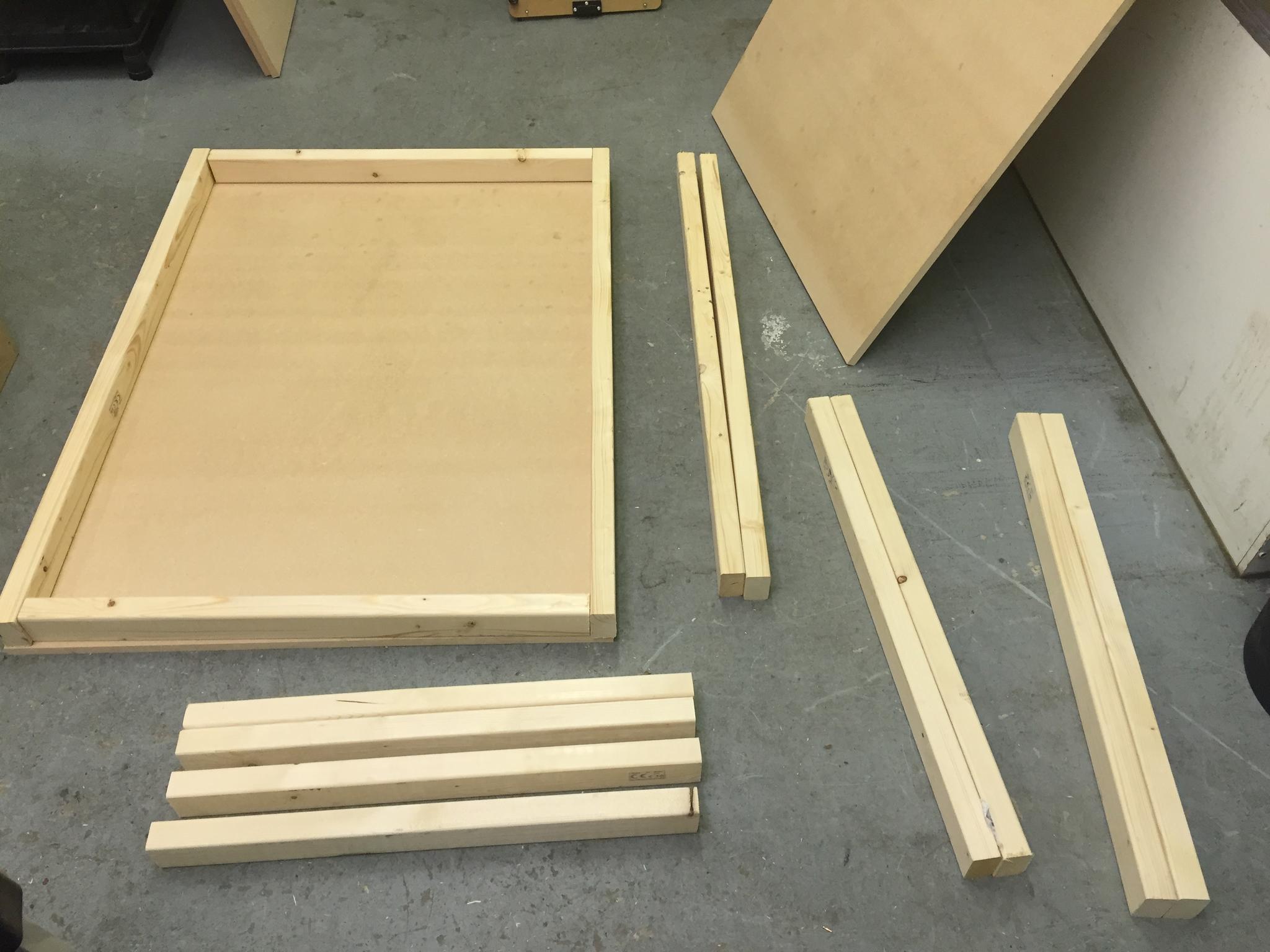

    Today I built a table for the CNC. 18mm MDF & C16 CLS timber from B&Q. About £30 worth of materials:
    1 Cutting to size

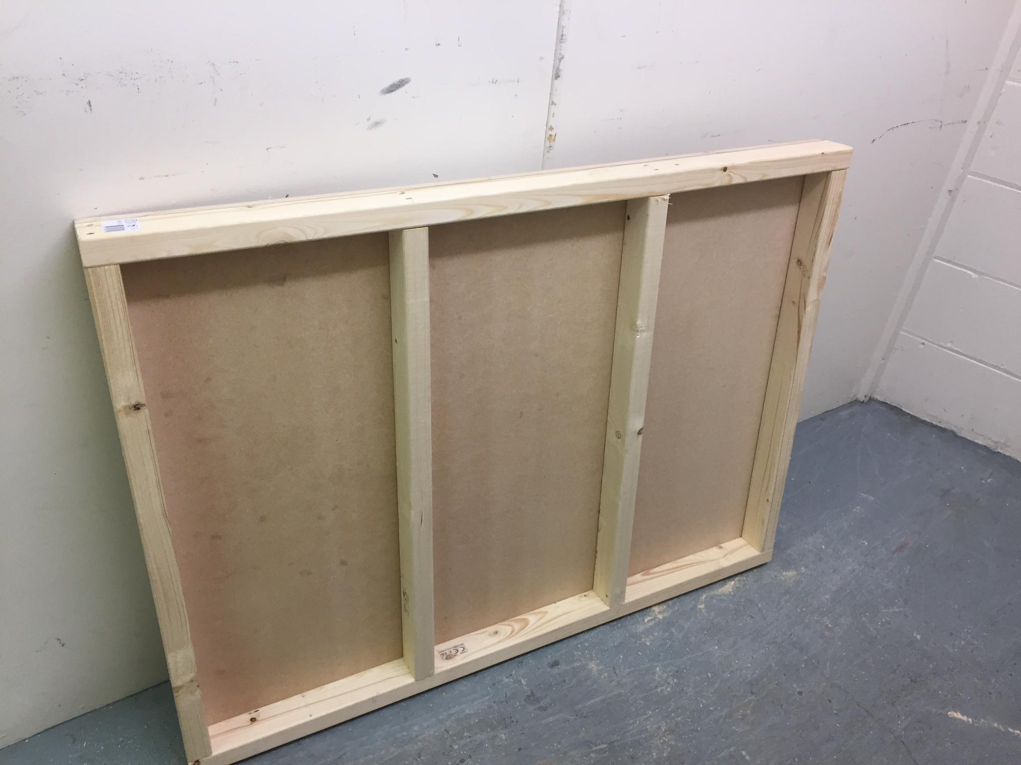

    2 Table top is 900mm x 1220mm; Supported by a timber frame:

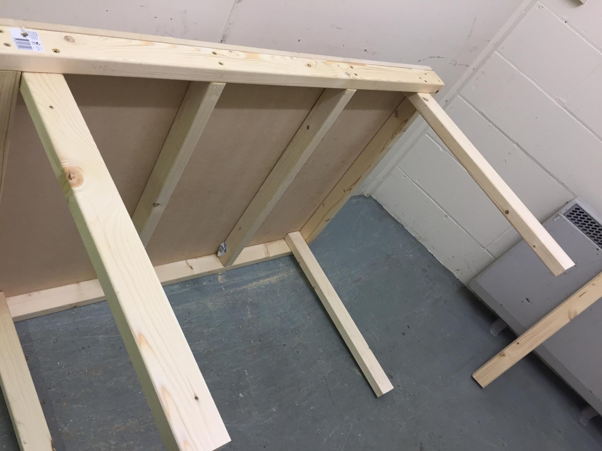

    3 700mm legs screwed on to table top:

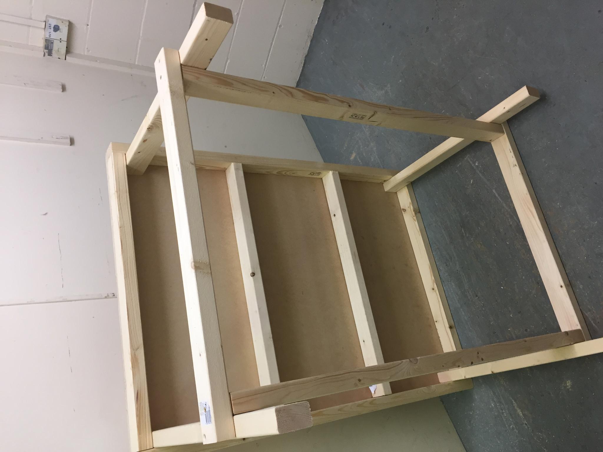

    4 timber base frame for support and shelf:
    5 MDF shelf for base frame, and a few corner supports for increased rigidity (may need more of these in the short-dimension in future)
    Table finished, ready to start assembling the machine itself:
