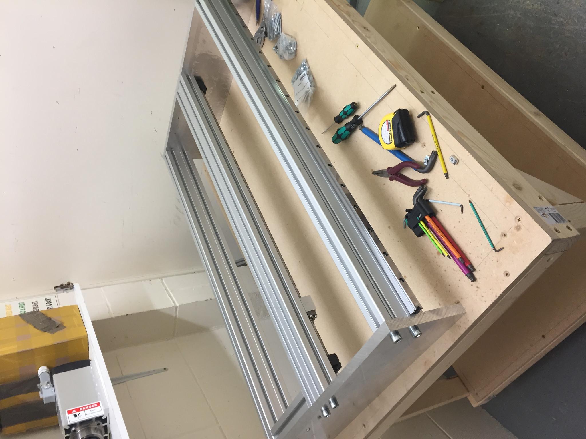

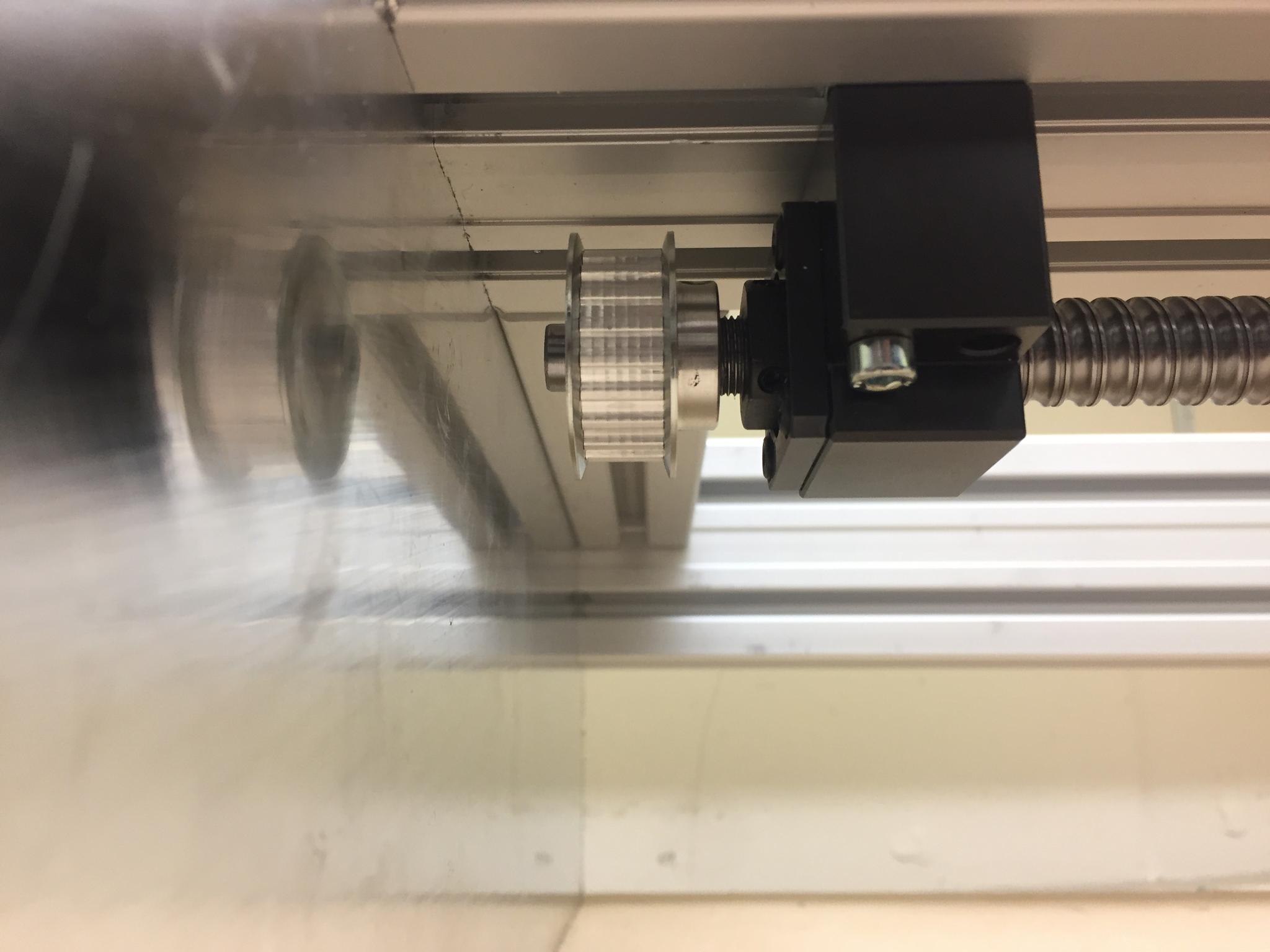

    Thanks Lee. I had a go at aligning everything tonight. Definitely improved. Shimming made a difference but still something a little sticky at the extremes. I then tried relaxing all the various attachment points for the ballscrew but this didn't make much difference. In the end I relaxed all of the big 12mm screws holding the 3 main extrusions. This made a significant difference but if I tighten them all up as tight as I can there is still some binding. In the end I tightened them quite gently and this reduced the binding at the extremes to very low levels and the overall frame still seems very rigid. I'm still concerned its not exactly perfect!
    I don't really understand what you mean by moving the mechanism with one finger. Certainly pushing the gantry, it doesn't move, there is enough friction to stop any linear force from being converted to rotational motion. For the vast majority of the travel I can just about turn the pulley with one finger - is this what I should be looking for?
    I do have a dial calliper and stand but very few places to attach it and not really enough skill to use it. I think I'm going to have to just move on and hope - without any experience it is hard to know if I'm facing real problems or just being picky!

    Thing is, even just running a single hiwin hgr 20 carriage along a single rail (hence no opportunity for misalignment), you give it a little push and it moves, but as soon as you stop applying force it stops - no momentum retained. I think this is due to the relatively high pre-load on the the HGR carriages - they just behave that way. Anyway, with no ballscrew connected I think things behave well overall (see my video above). Connecting the ballscrew introduced the problems - though these have been much reduced now - I just don't know what I am aiming for!
    I'll agree 100% about the HGR20's being a little sticky, but I'd rather they were that way and had no play, than "free and easy" and wobbling all over the place. If you can turn the ball screw end shafts smoothly between finger and thumb then I guess it should be OK - after all, a decent stepper should be giving a good few hundred Ncm torque.
    Thanks for confirming my thoughts about the HGR20s. I think I've got the rails sorted, its the ballscrew causing issues I think. I have got it to a much improved state, but I can't quite "turn the ball screw end shafts smoothly between finger and thumb". Whilst the resistance along the entire travel is now pretty much uniform, there is a little patchiness to the motion - there are occasional slight sticking points which require a bit more force than just two fingers can apply. I mainly test it using the belt to move the ball screw and it all operates ok in motion though from a standing start it can be a little "sticky".
    It may well be fine with the reasonably overpowered servos I will be using. I'm going to leave it as is and proceed with the other axes so I can compare the motions between each axis.
    If its still a problem I can think of only 2 ways forward:
    - widen some of the mounting holes so the major extrusions have a little more "wiggle room" so I have broader alignment range
    - buy a new ballscrew - I worry I may have subtly bent this one during my initial tests and now it will bind whatever I do...

    BTW, did you check the ballscrew for smoothness throughout its' length before mounting it?? As I mentioned in my thread here: http://www.mycncuk.com/threads/12524-gritty-ballscrews , although Fred tries hard to please, his engineers don't always seem to adhere to the old saying "cleanliness is Godliness" when it comes to machining ballscrews. Even the replacement parts he sent me needed a clean, strip down, flush through and re-grease before they were acceptably smooth. Try running (twisting) the sticky portions through a piece of clean tissue and then examine under magnification to see if there's any small flakes of swarf.
    I think you may be right. I need to dismantle much of my machine anyway so best get to cleaning the ballscrews!
