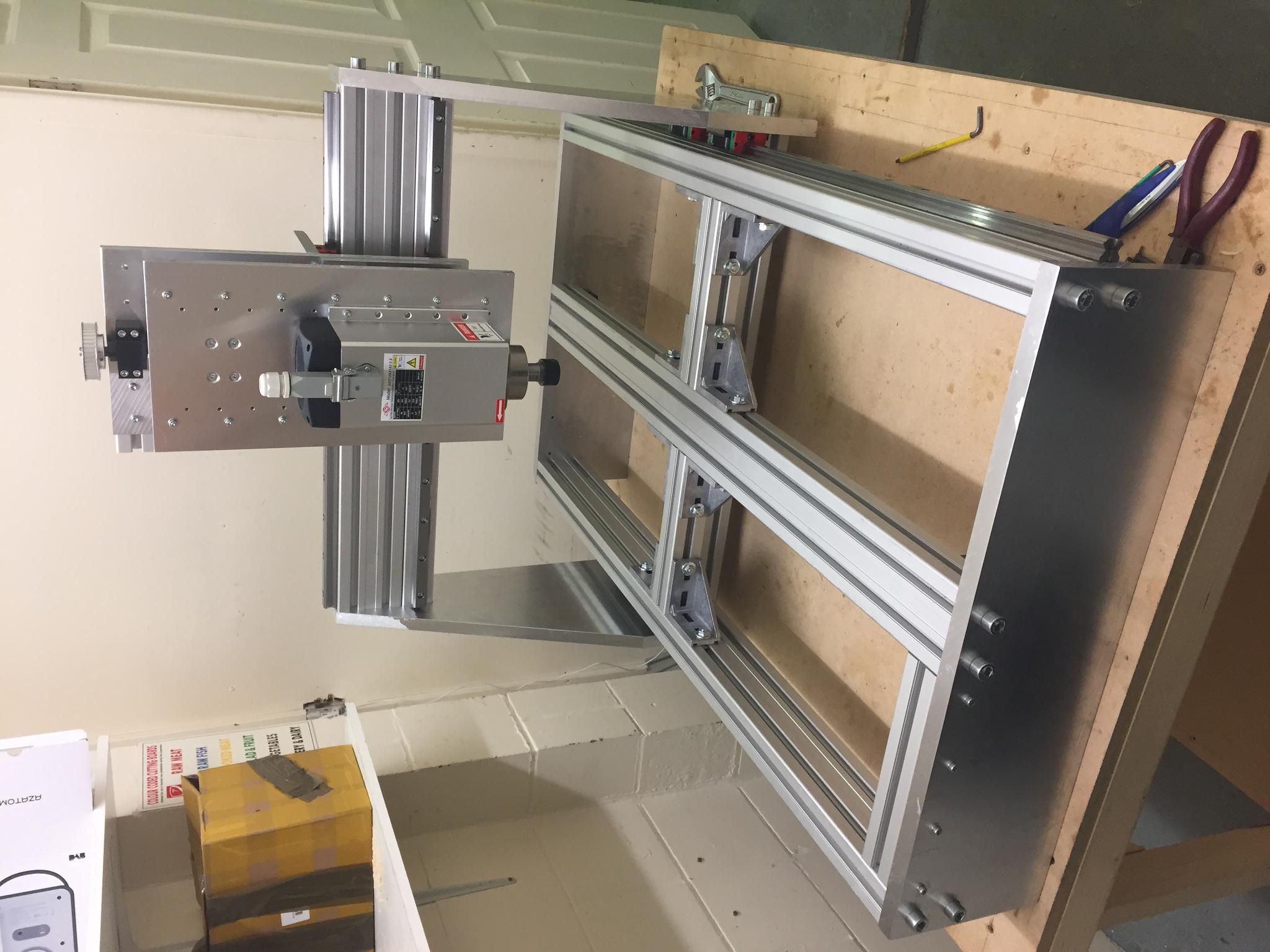

    Equipped with my newly cleaned ballscrews I made substantial progress today.

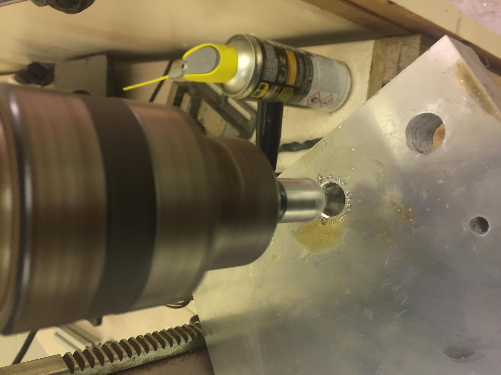

    First I reworked all of the Ali plates. I widened a bunch of holes. The M12 bolts had 13mm holes, now 14mm. The M5 bolts had 5.5mm holes, now 6.5mm. The idea is to allow more wiggle room so I have wider alignment range on all the mechanics. This worked a treat: I no longer need to use any shims, careful and methodical alignment allowed me to find good alignment without messing about with coke cans and tin foil!

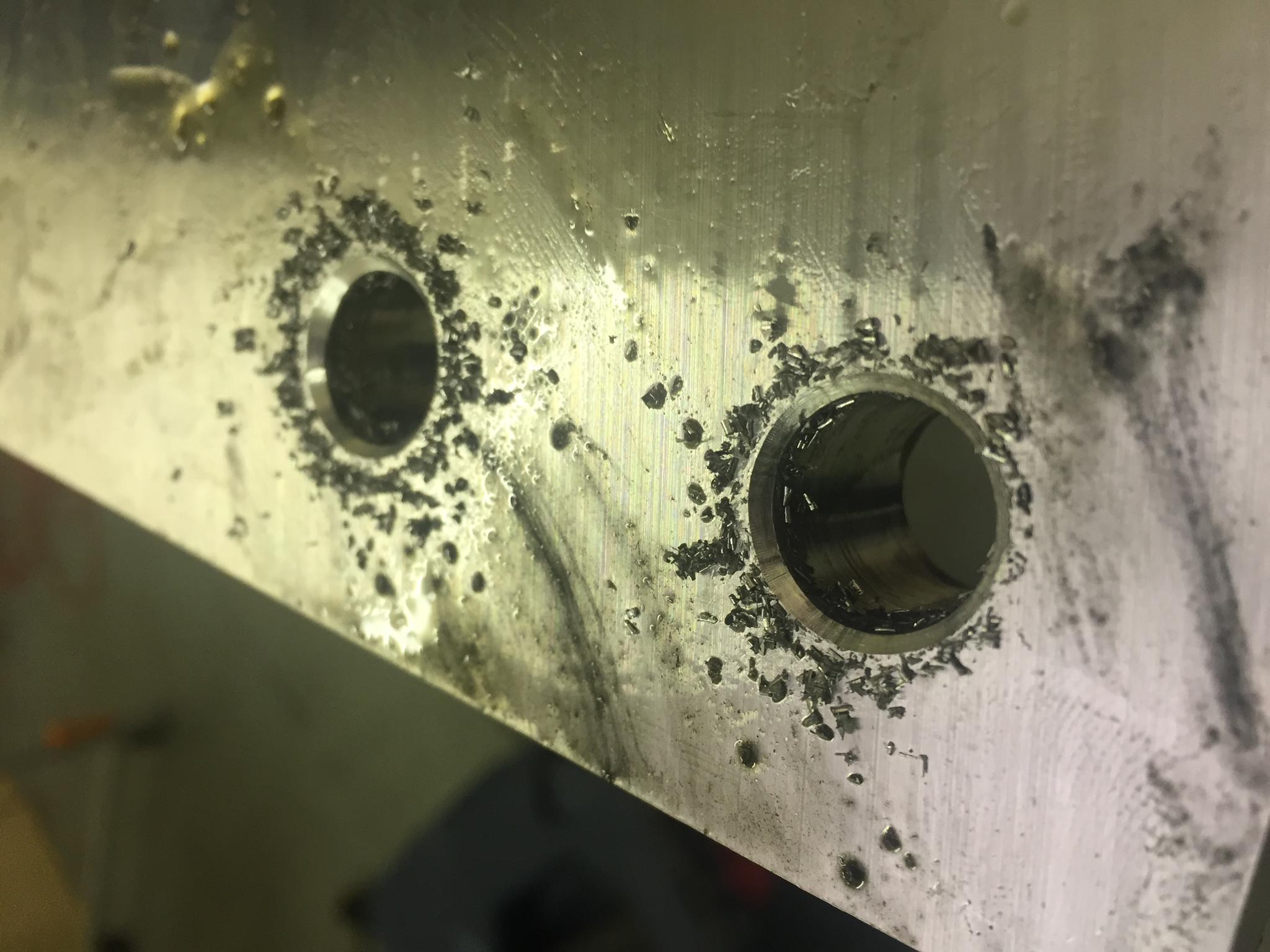

    I then bevelled most of the holes in the Ali Plate. I was worried that the burrs around the holes were messing with precise mating of all the pieces:

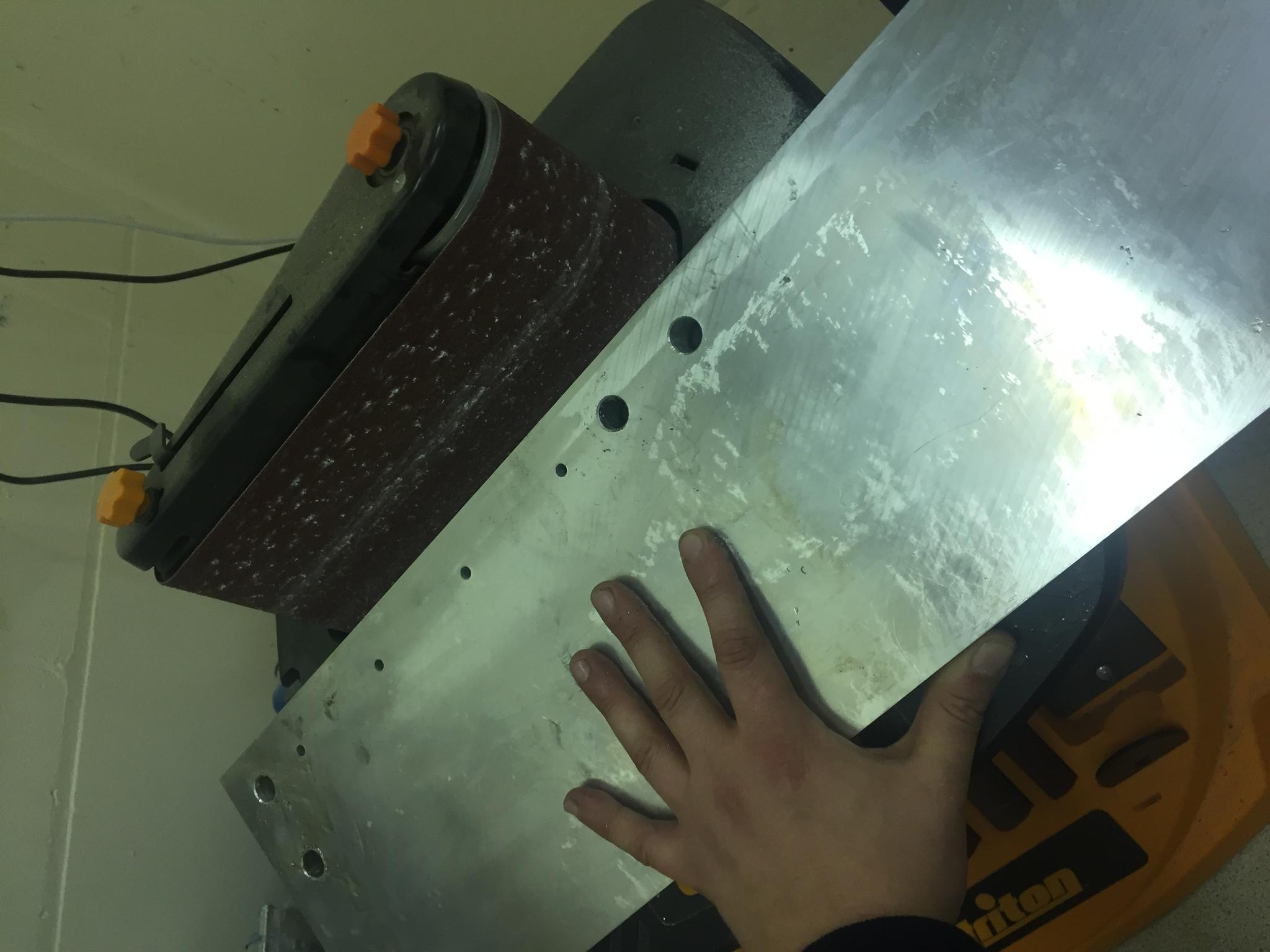

    Whilst I was at it I bevelled the edges of all the plates at 45deg on my spindle sander. I was getting tired of the sharp edges opening up my skin and getting blood all over the machine!

    Here is a current snapshot of the machine, ready for assembly of the Z axis:

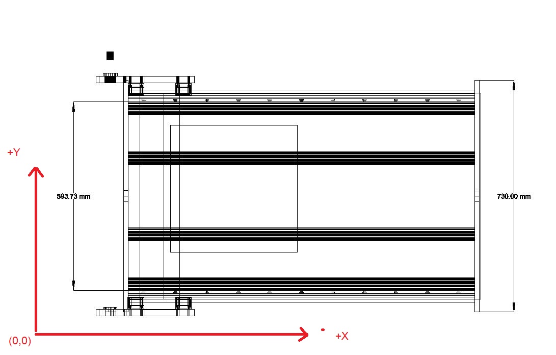

    Looks a treat and a nice build. It is worth investing in specialised shim stock, because it allows you to shim precisely. see here
    Also get you axis nomenclature clear. If you assume that the bottom left corner of your machine (looking top view) is 0,0 then the Y axis is the axis between the gantry sides and the X axis is the longest axis. Z zero is the topmost point of travel on the z axis.
    Now start to work out where cable chain will run. This is something I did'nt do until I was at the same stage as yourself. I had to lash something up but luckily the design had space for aluminium channel to be fitted to support the chains
    Finally for your spindle mounting, also try and design some means of adjusting for tramming the spindle. It will make your life easier. At the moment I'm using shims and it is tedious!

    Surely if you're standing at the front of the machine looking down, (i.e. 0,0 is front LH corner) then this is the opposite to how you'd have X and Y on a normal graph?? I'm with Bluesking on this one :-) Not that it really matters, he's made it perfectly clear what he's doing.
  5. #65
    Most 2D/2.5D drawing packages use the normal mathematical convention that the X axis is L -> R as you look at the paper, the Y axis is at right angles to it. How you orient your paper or machine is irrelevant. My machine is in portrait mode and it just makes it easier to visualise if it is the same as the drawing. My Z zero is at the top of the workpiece, but my Z homes to the top of travel. X and Y homes to Left and Nearest me respectively. I just find it less confusing this way and therefore mistakes are less easily made.
  6. #66
    Hi Guys
    Sorry everyone, this is what I meant - standard landscape graph mode.But I of course it does'nt matter which way you do it providing you know what to expect...

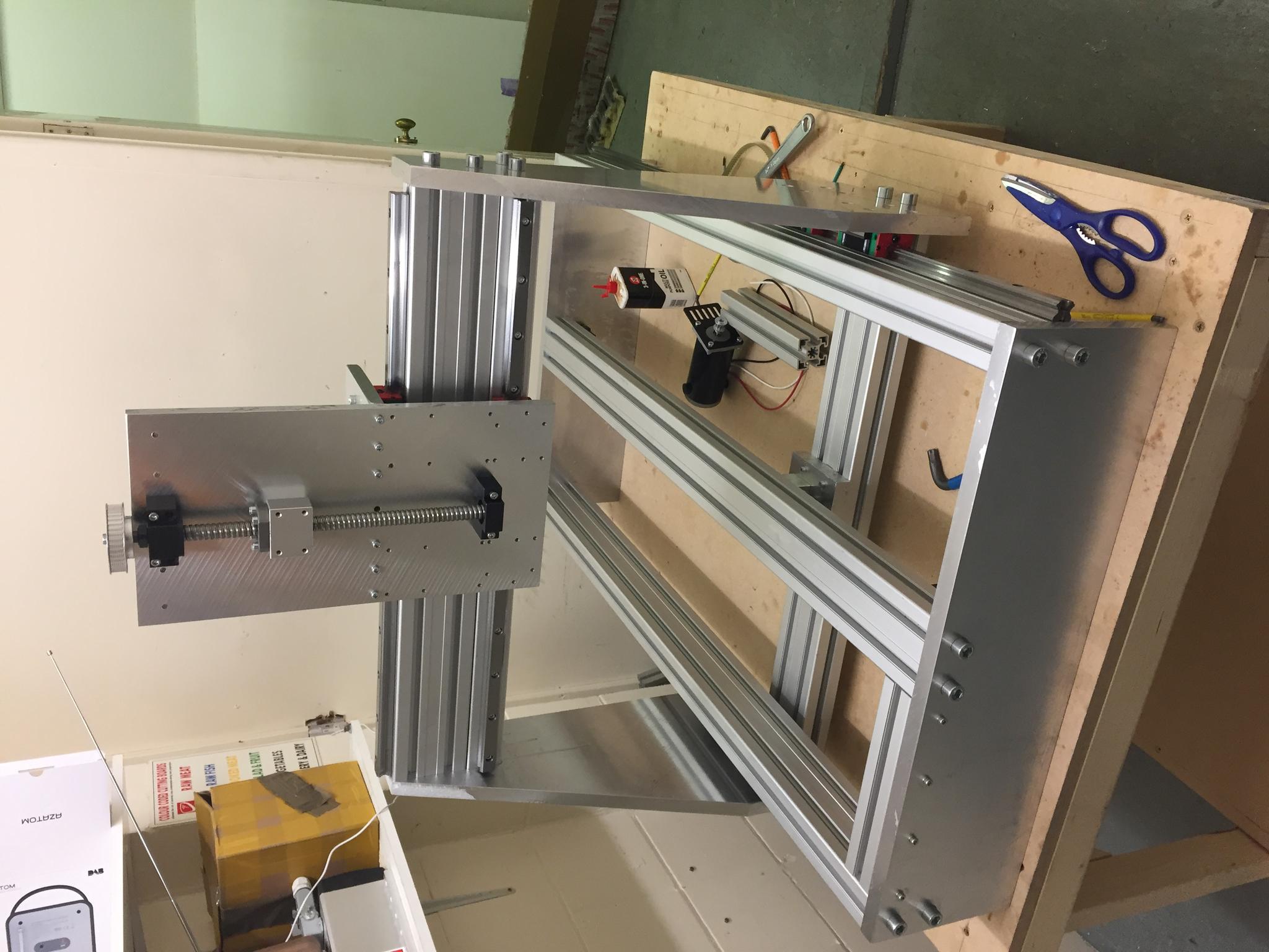

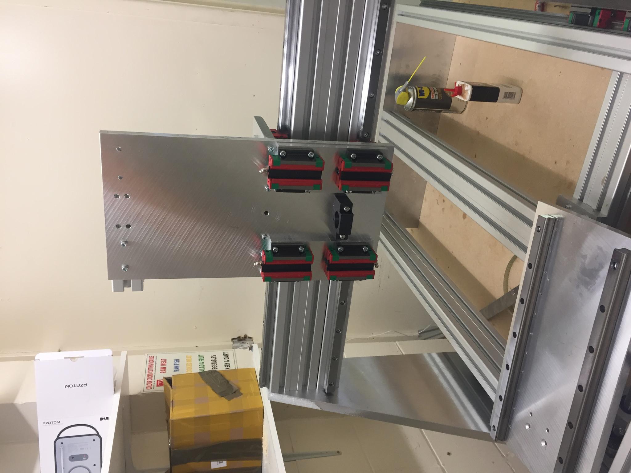

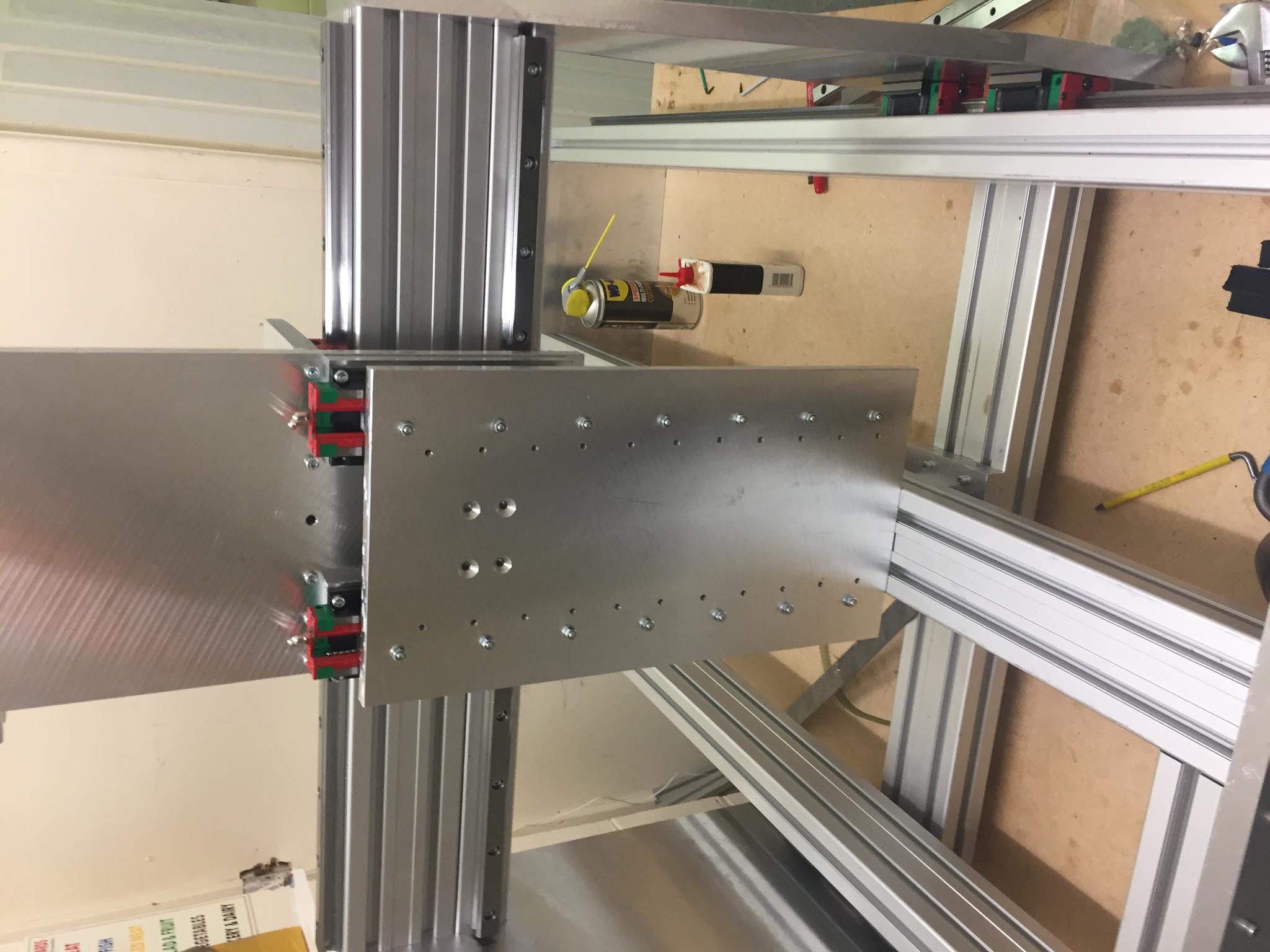

    Z axis build today.
    aligned the hiwin carriages first of all as I can't get to them after anything else is assmebled
    then finalised the fit of the hiwin rails
    then ballscrew aligned and attached the spindle once I was happy there was no binding

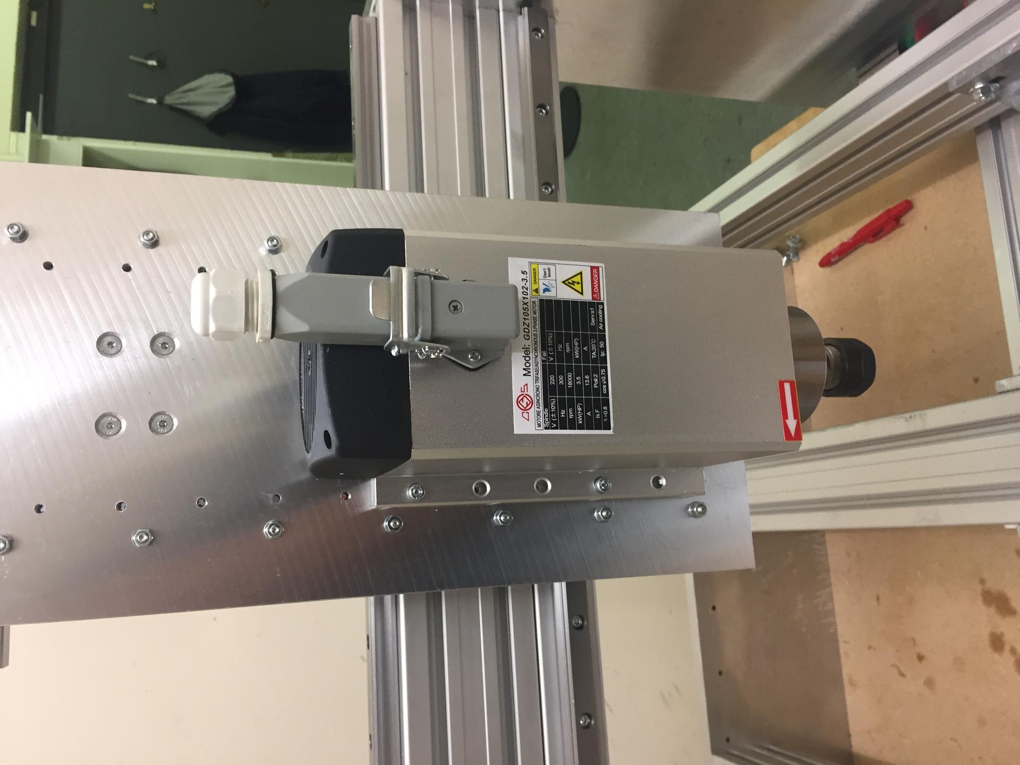

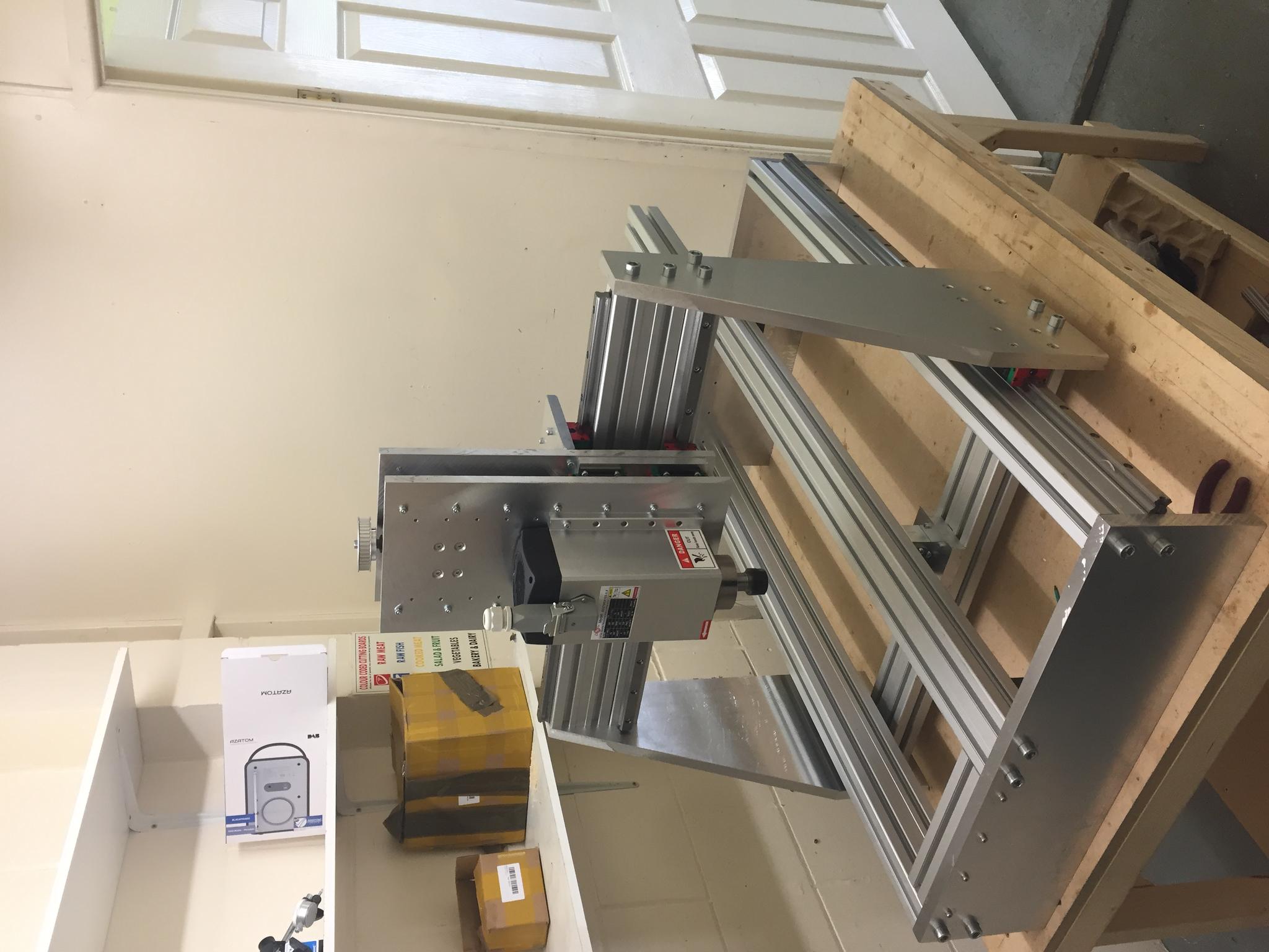

    entire travel moves smoothly, it is easily pushed down by hand, not so much up for obvious reasons. My biggest concern here was that the Z axis would fall under its own weight. Well, I got lucky, there is just enough friction to keep the axis from falling down so I won't need to bother with a brake. Here is a video of how it behaves as it is - this is without the belts/servo connected, so after connection there will be even less chance of it falling after powering down:
    https://streamable.com/z05b9

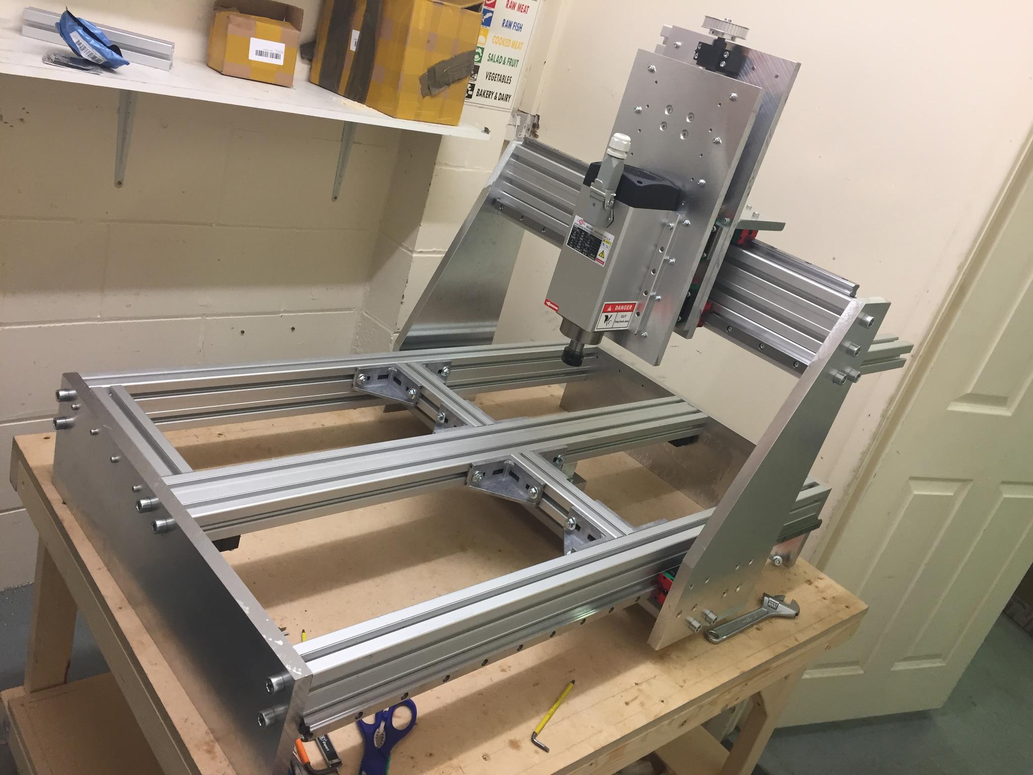

    bolted on the reinforcement struts to the base to improve rigidity - seems to make a noticeable improvement

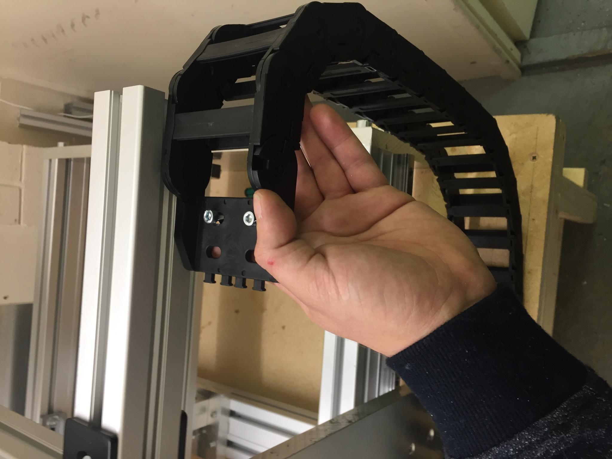

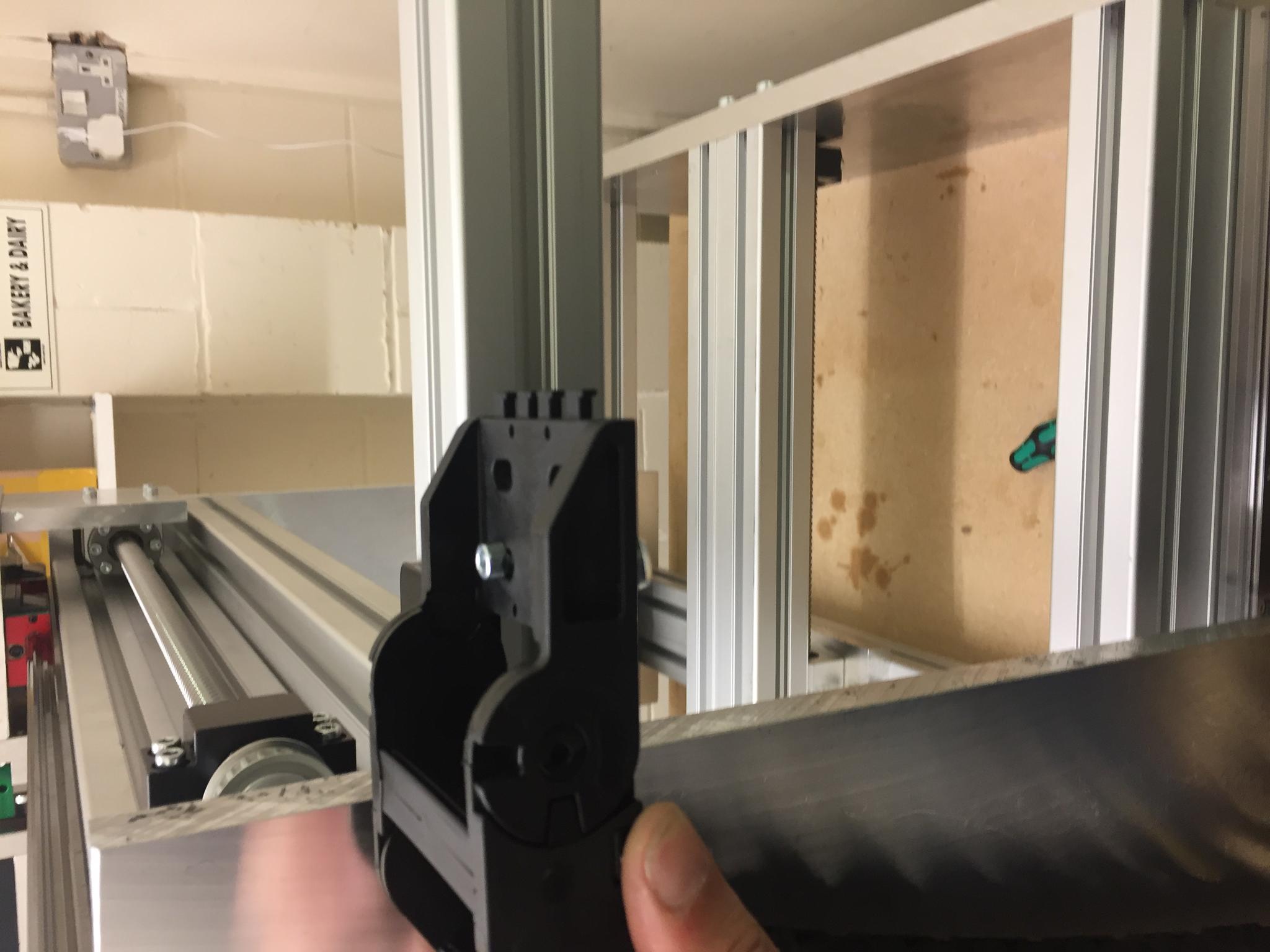

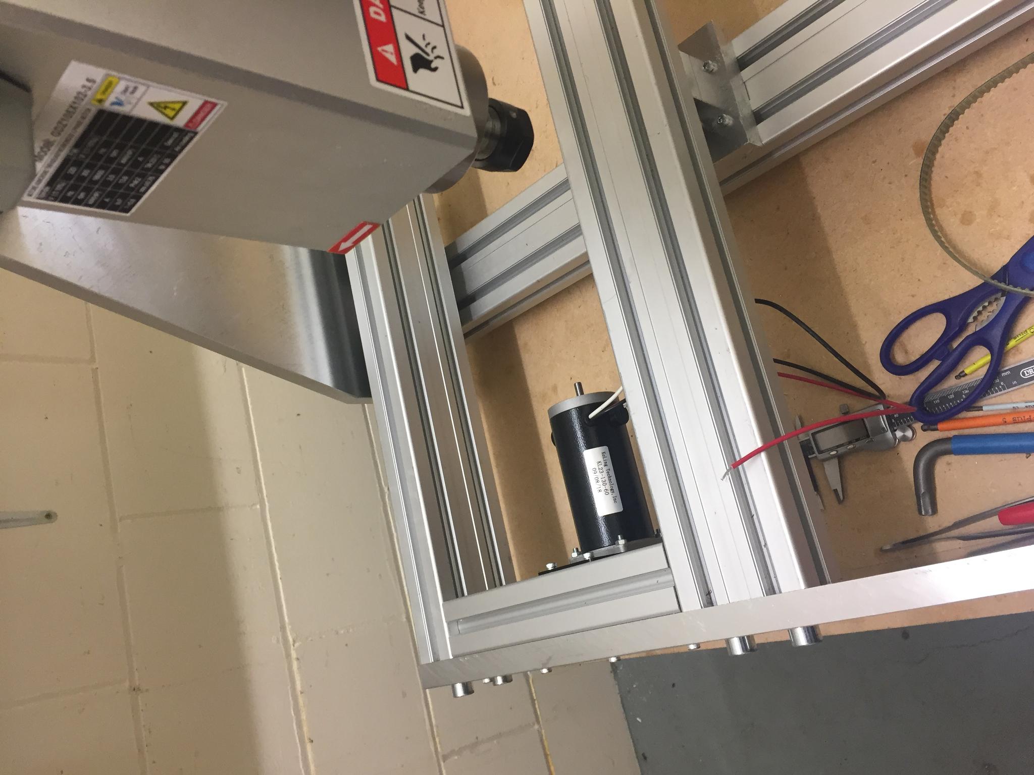

    quick measure up of the drag chain - I'll cut some Ali Plate to support this - one end will be attached to the gantry, the other directly to the table - not pretty but I think it'll work just fine - I liked Wal's build that he had his chain under the table, but I have my reinforcement struts there and prefer rigidity over neatness!

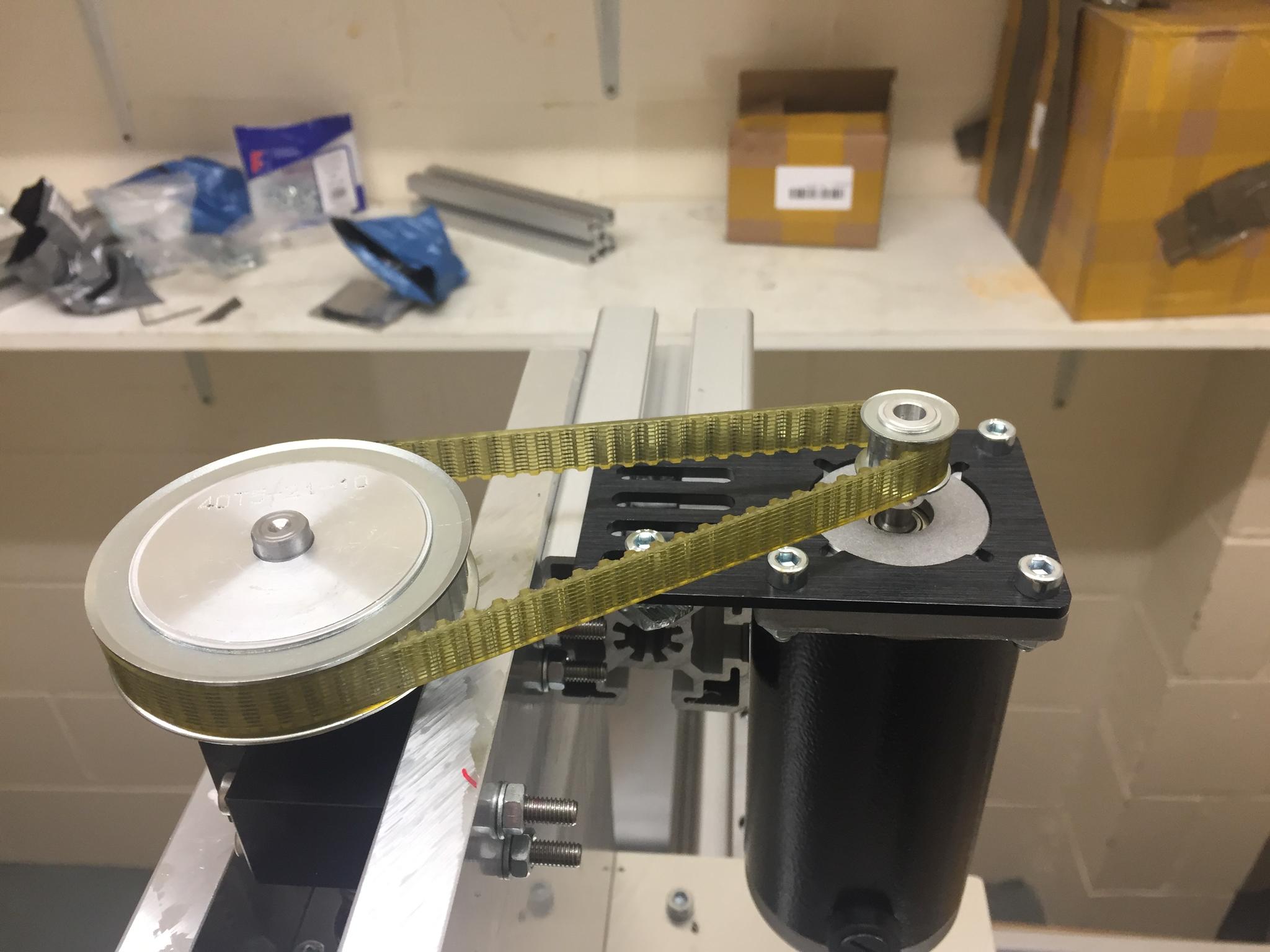

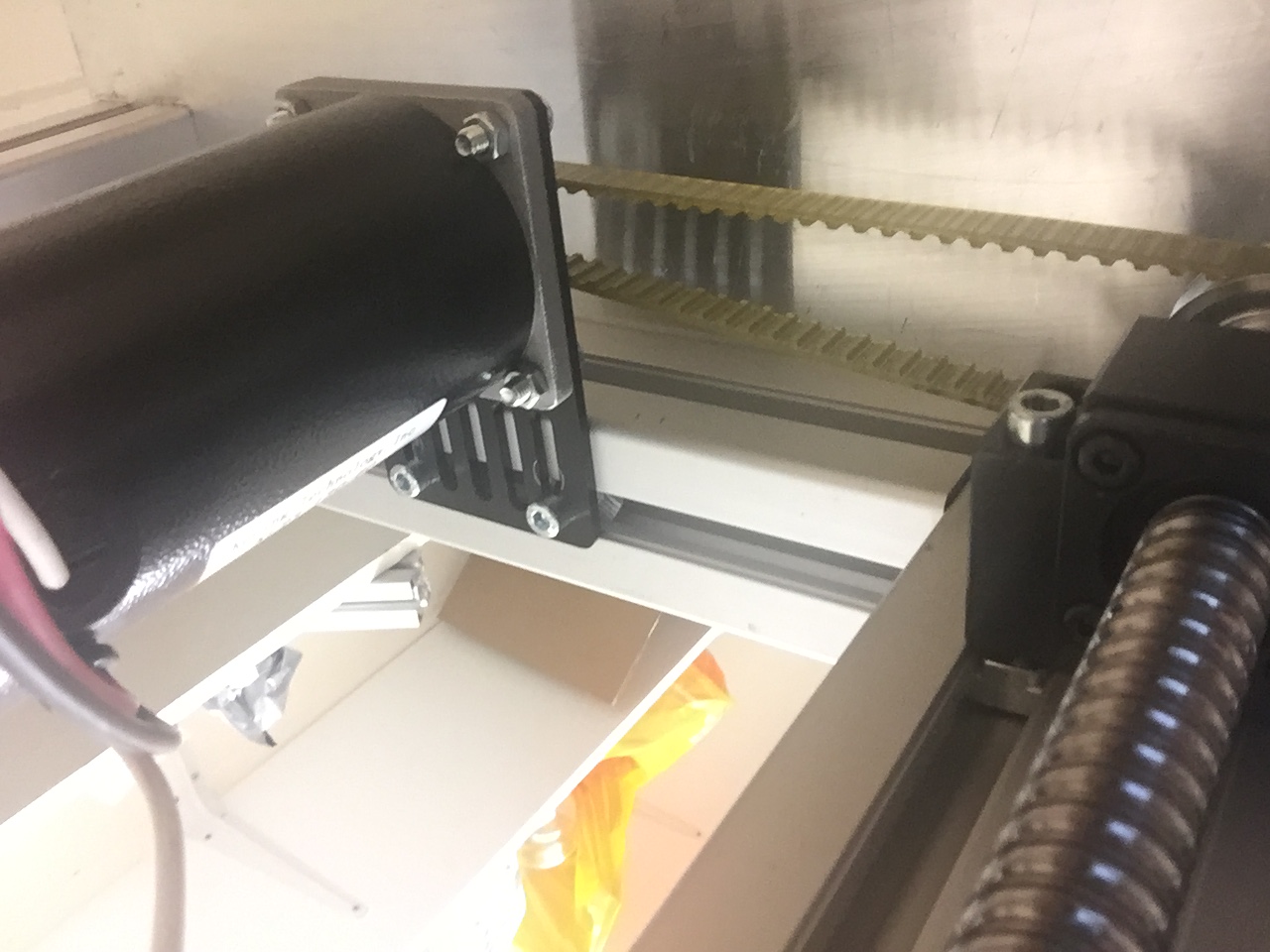

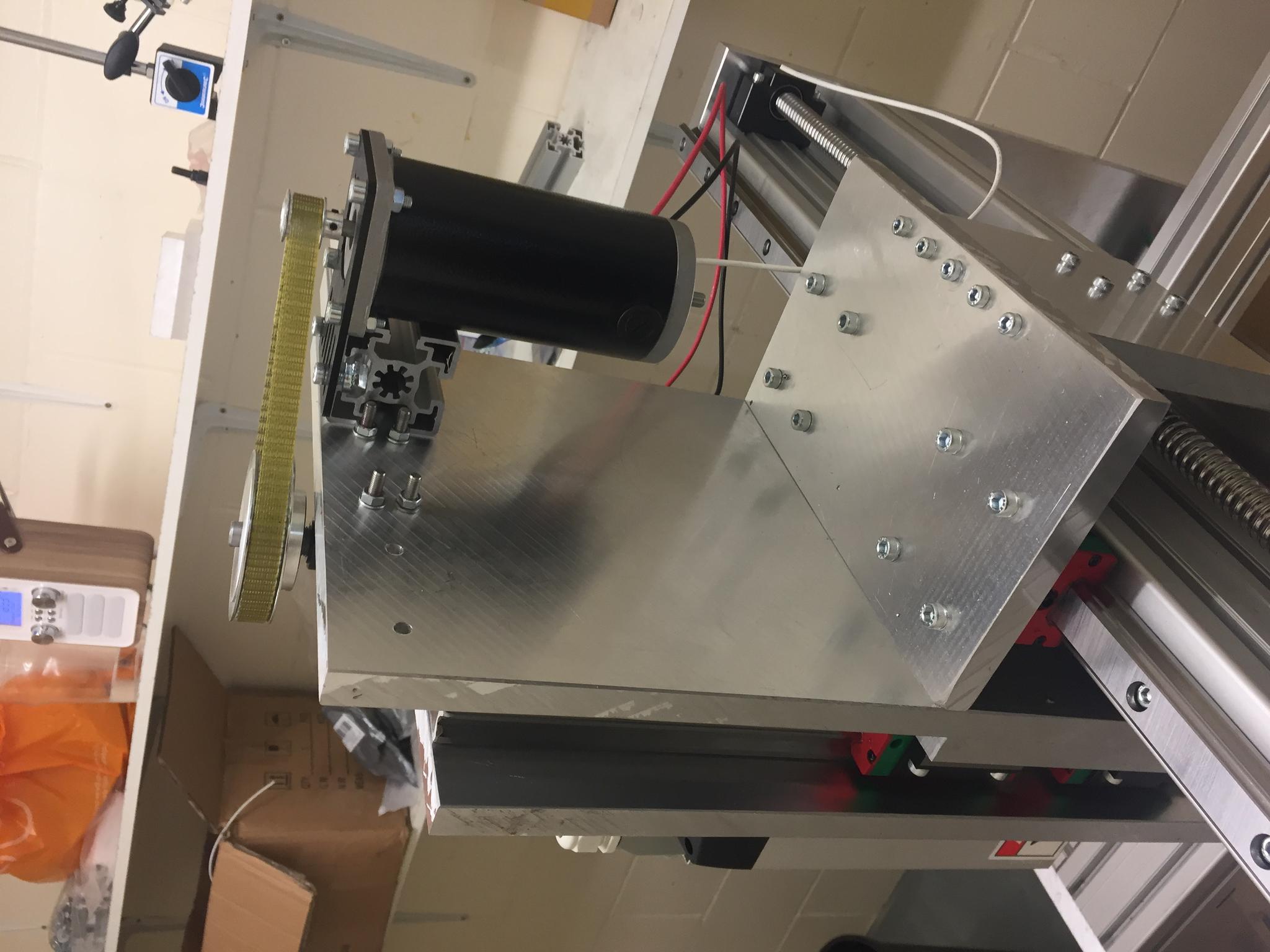

    finally, a quick test fit of the servos to see if there is enough pulley adjustment range (broadly planned that there should be throughout the build!) and to check whether the belts I have are of suitable length. I need to buy a slightly longer Z axis belt, you can see that the servo doesn't quite mount properly as is - I had to shorten the support extrusion for it during the build as I couldn't be arsed to cut an indent to go around the ballscrew bolts.
