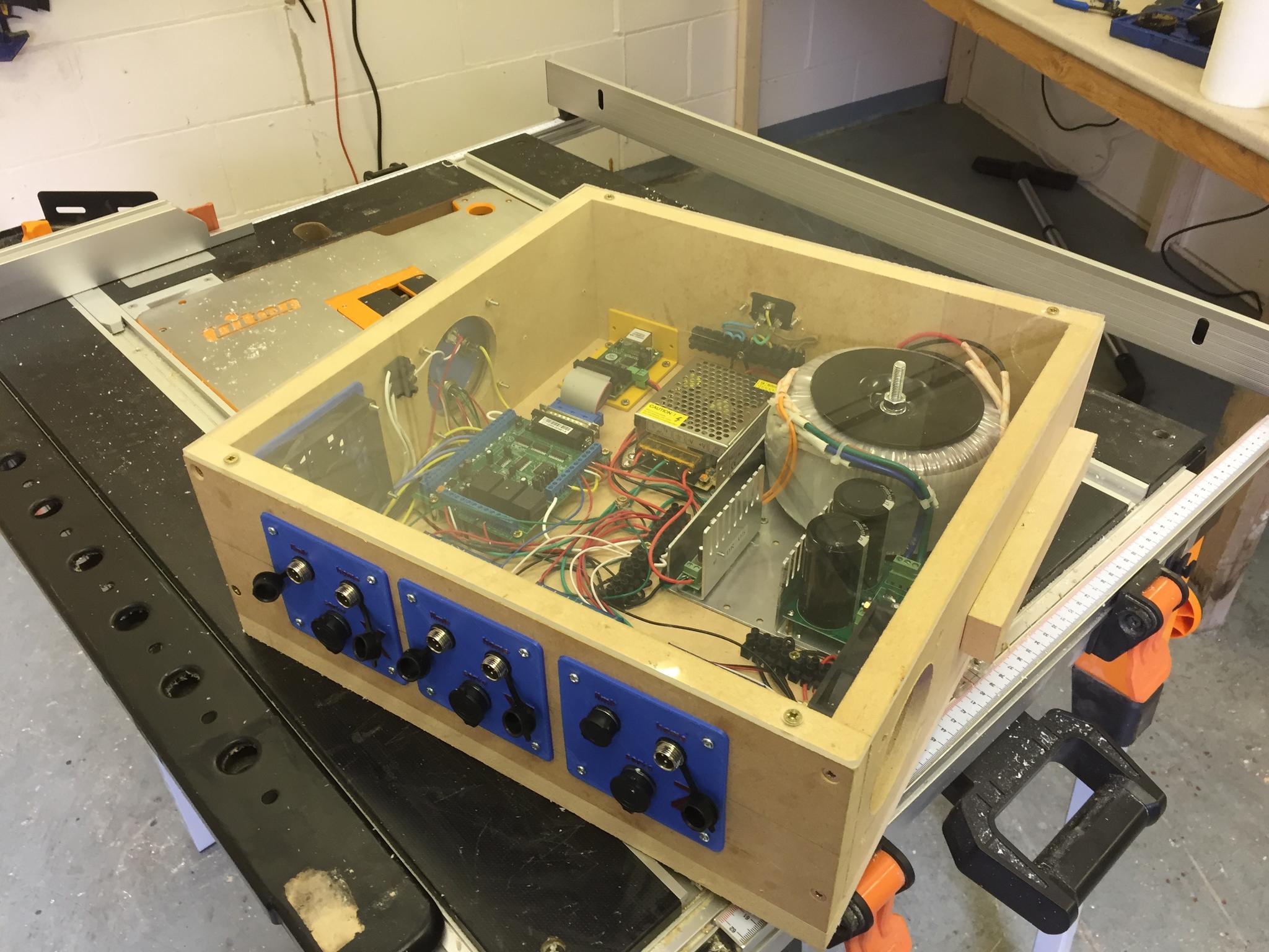

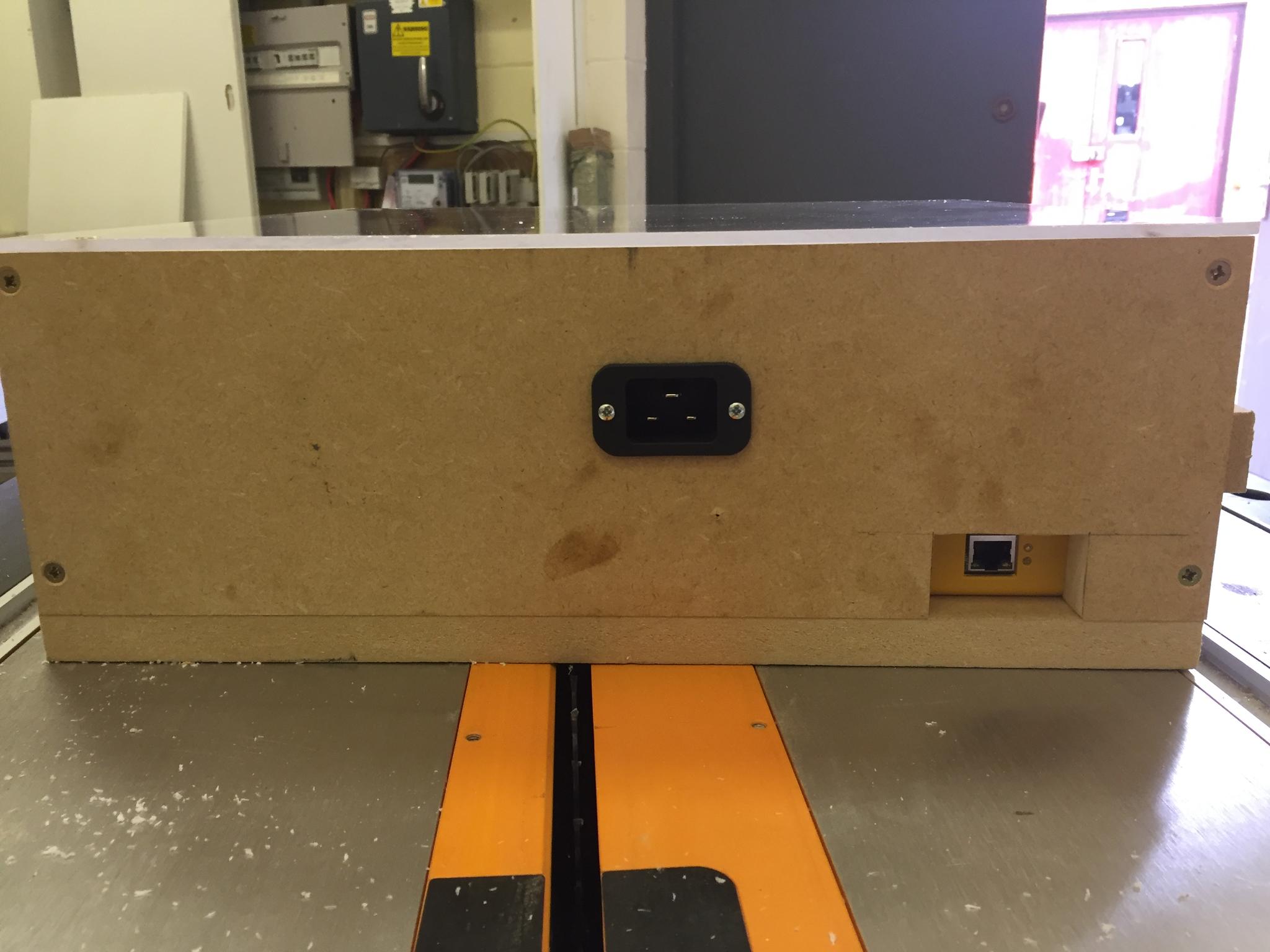

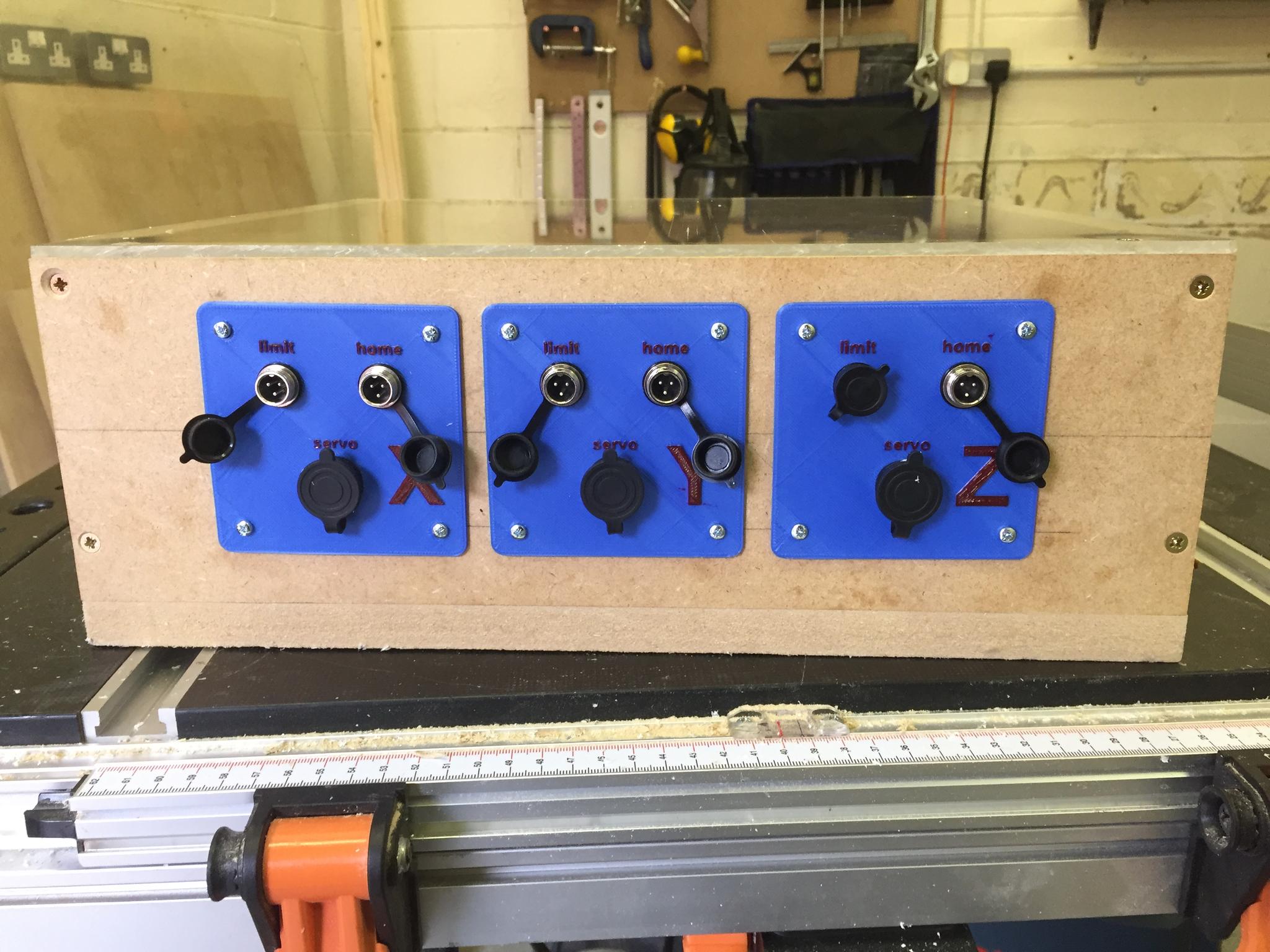

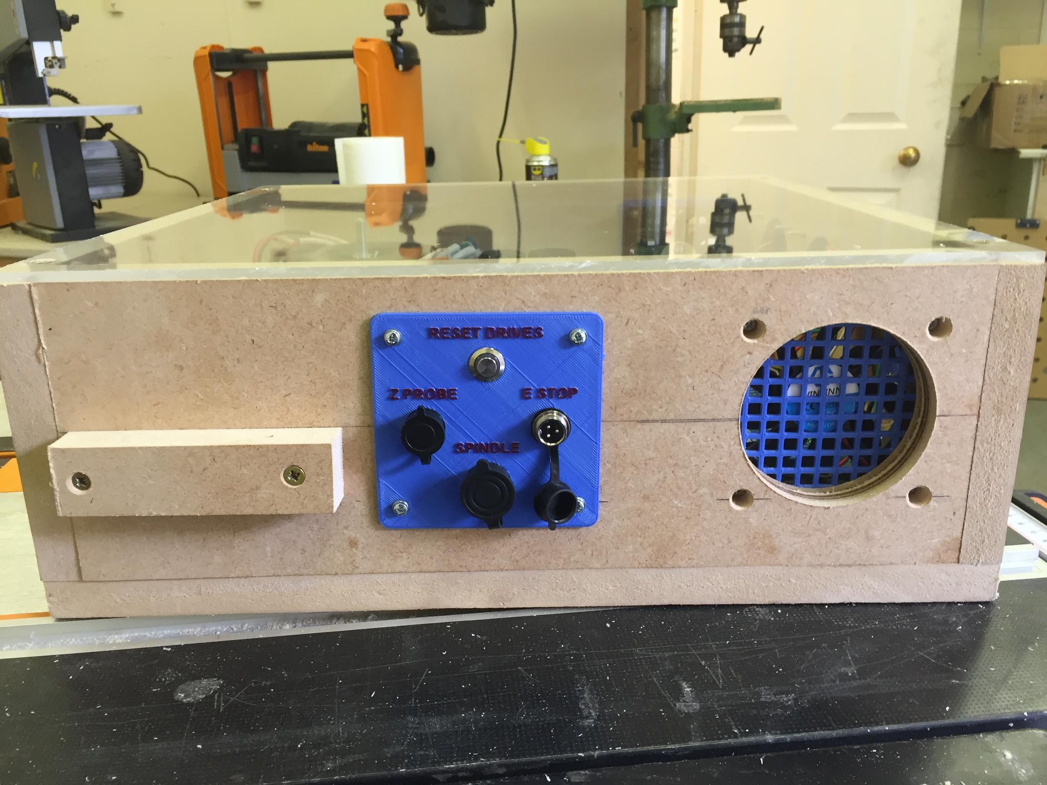

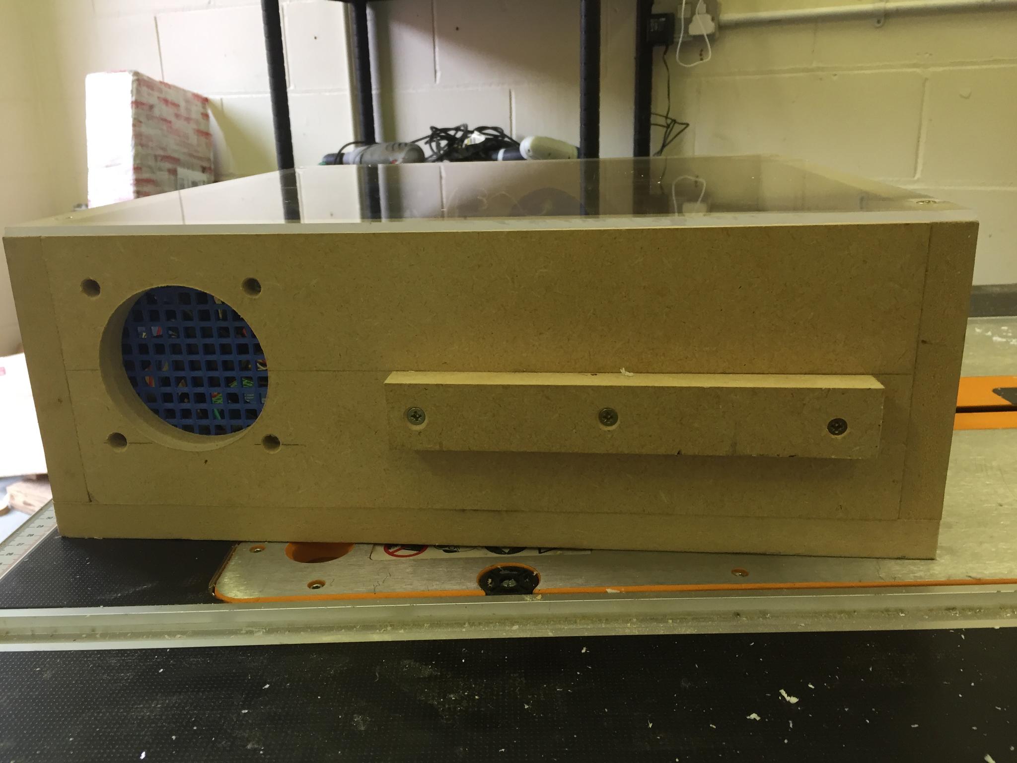

    Been a little while since I last posted but progress has been made. Almost finished and very pleased - things all worked pretty much to plan, even the electronics and software.
    1) Made a simple 400x400mm MDF enclosure for the control box. 3D printed some connection panels so I can change the interface in future if necessary. Bit of spare clear acrylic for the top.

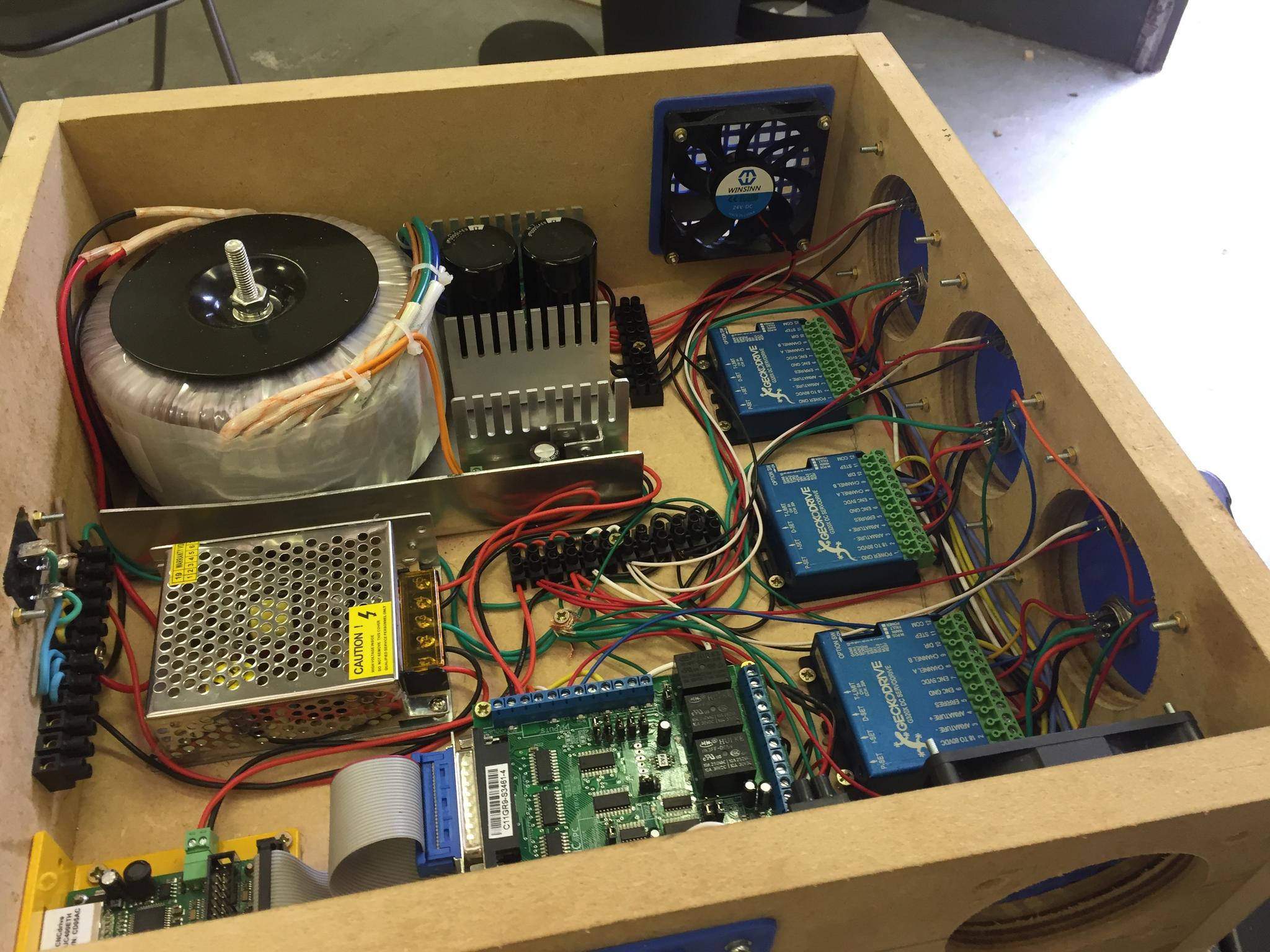

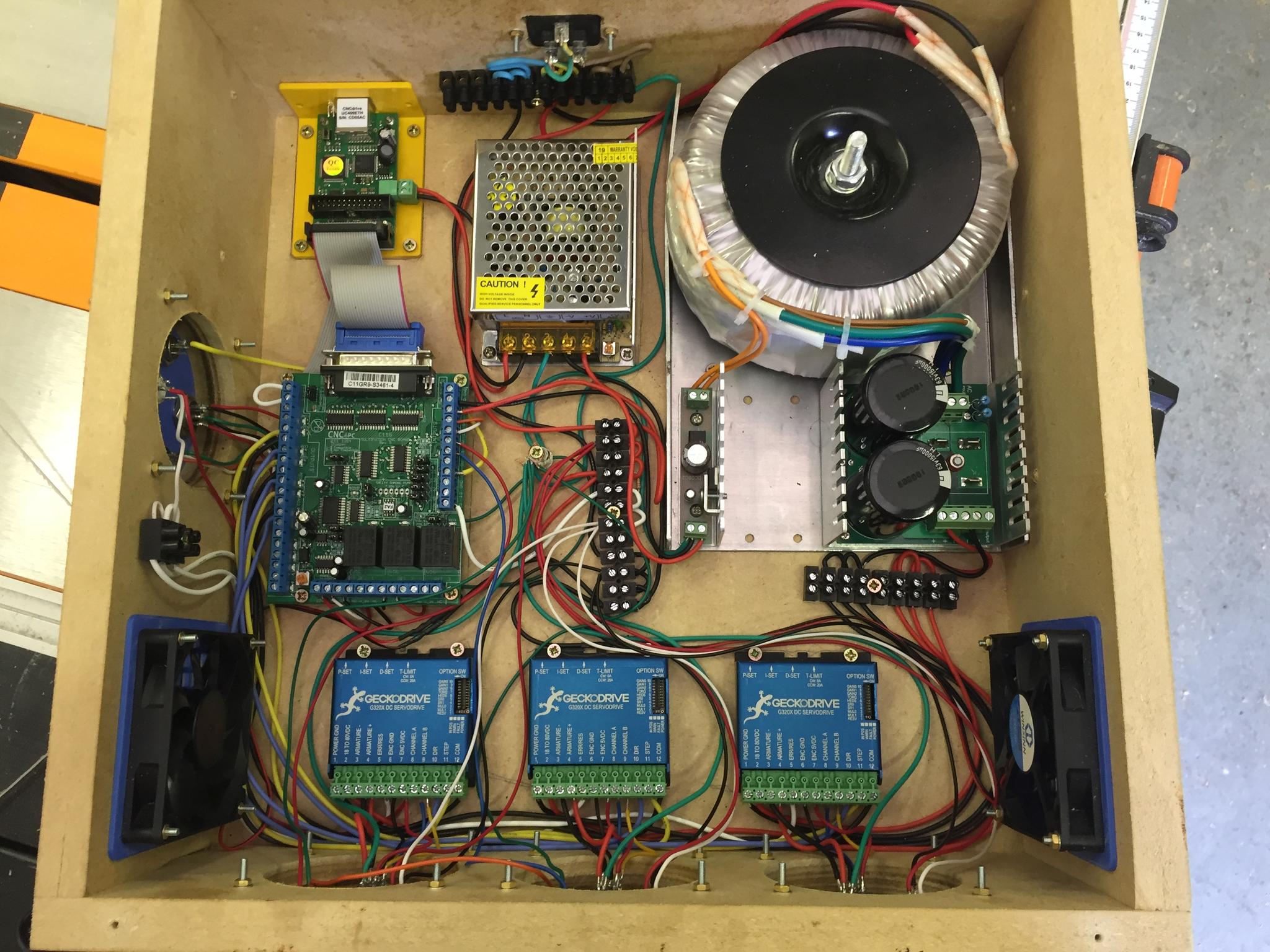

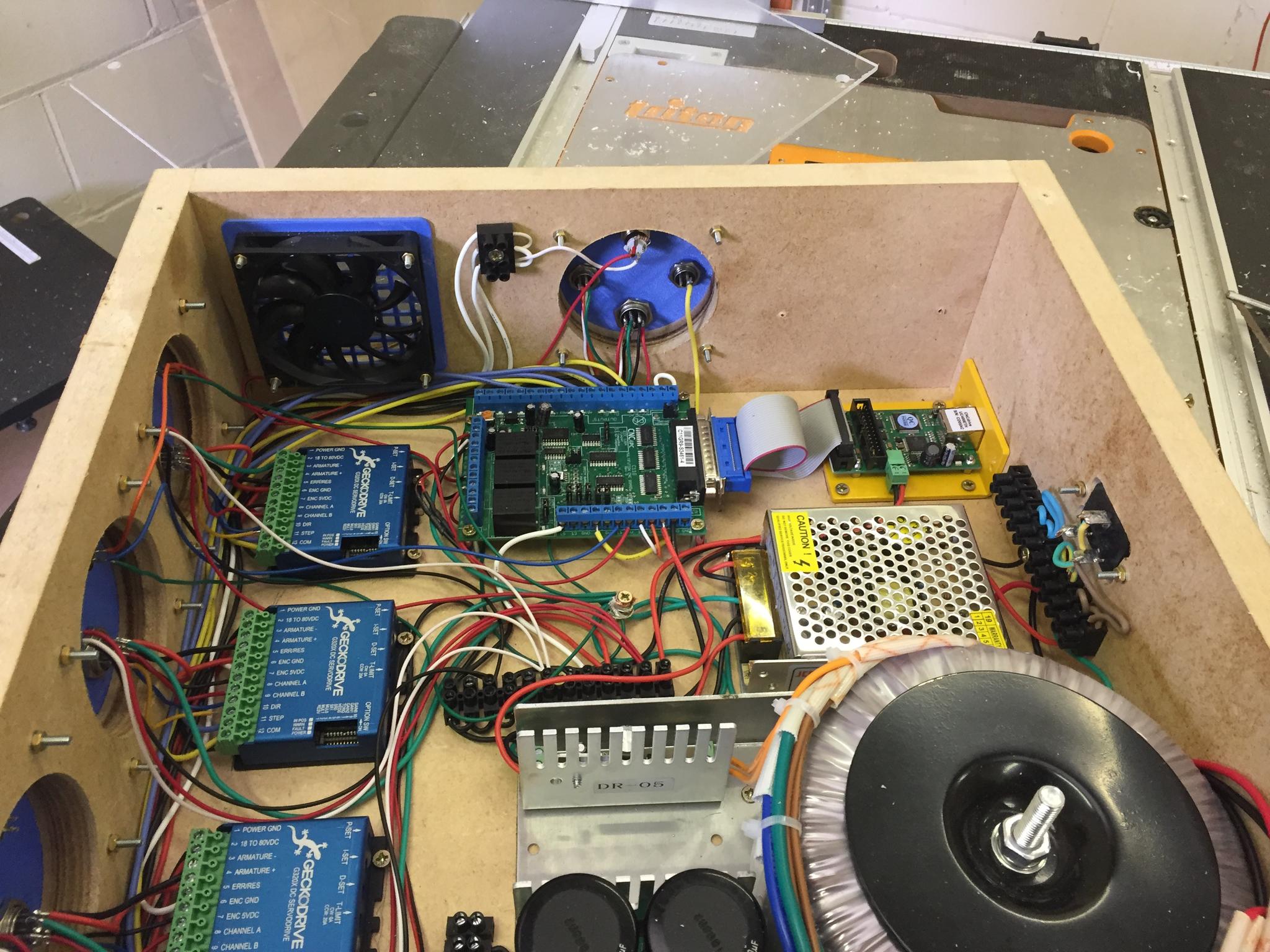

    2) Spent about 50 hours of bench time to wire the control box. Surprised at how long this took - thought it would be simpler but I was testing individual functions as I went to make sure it all integrated OK.

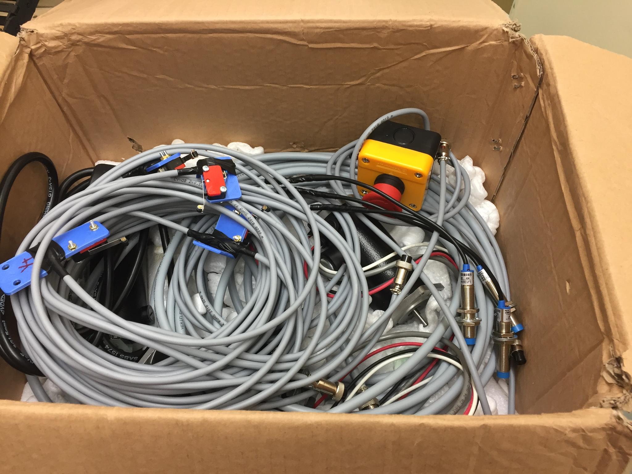

    3) A lot of the bench time was spent preparing cables and connectors. Here's all of the prepared cable ready to go into the workshop:

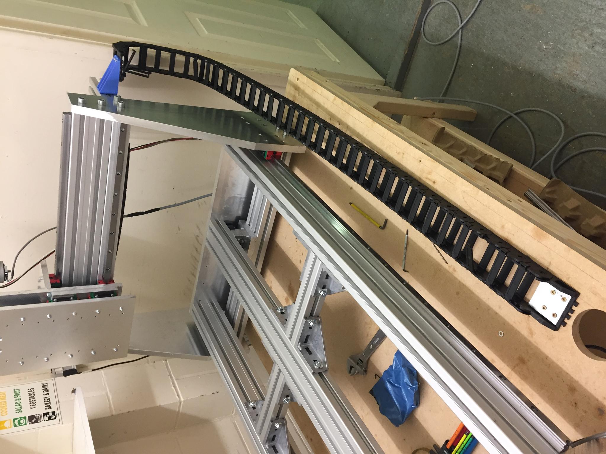

    4) Back in the workshop, attaching the drag chain to some 3d printed mounts:

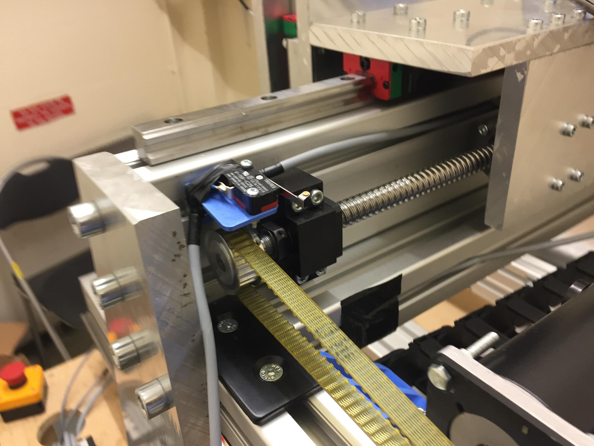

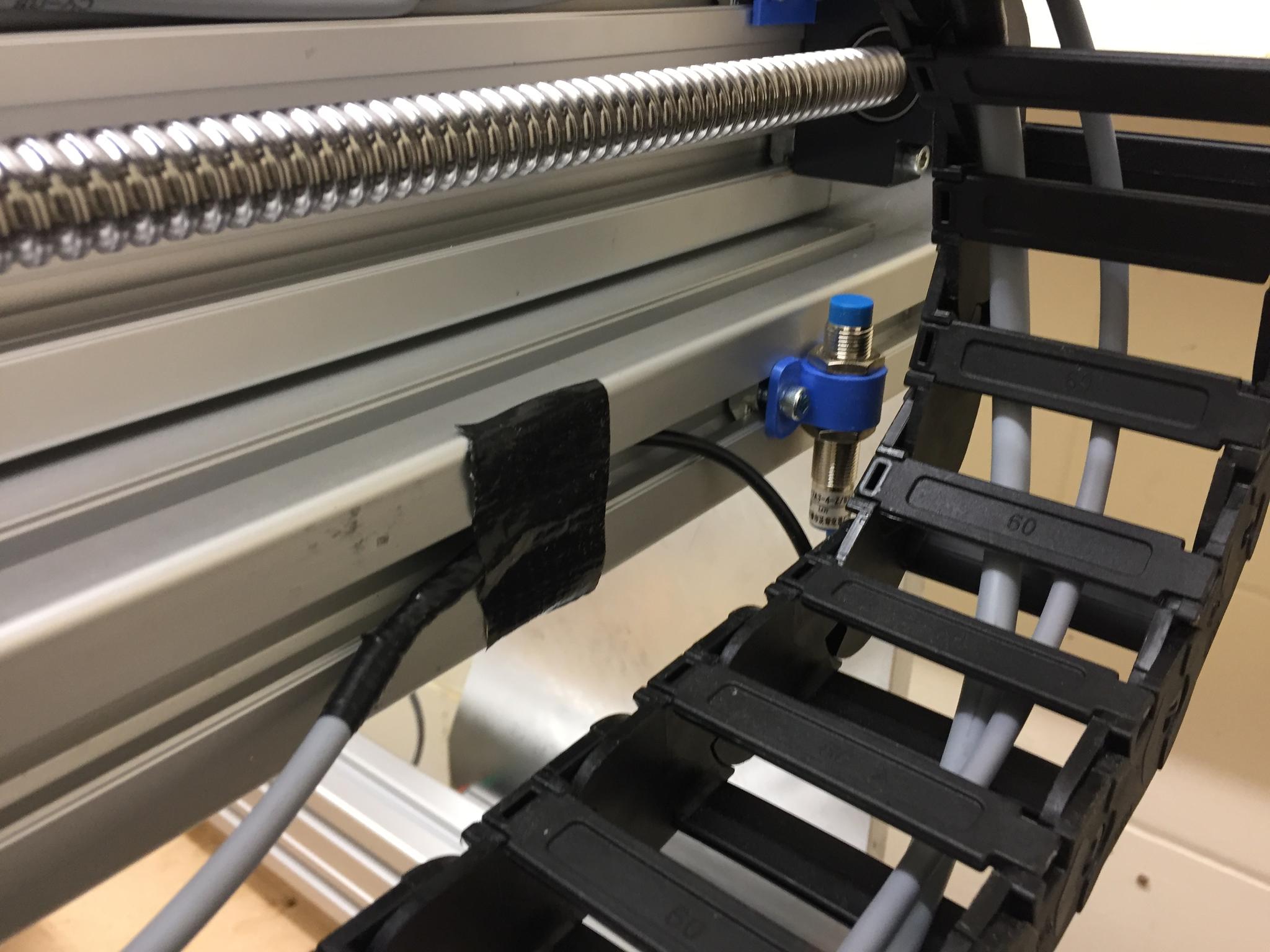

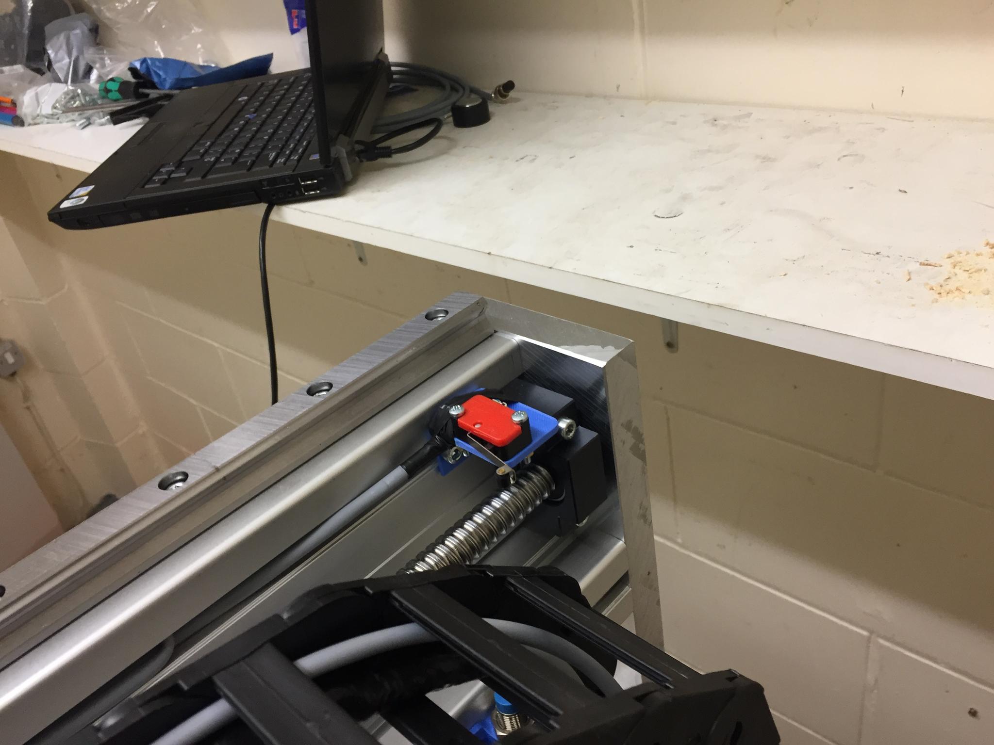

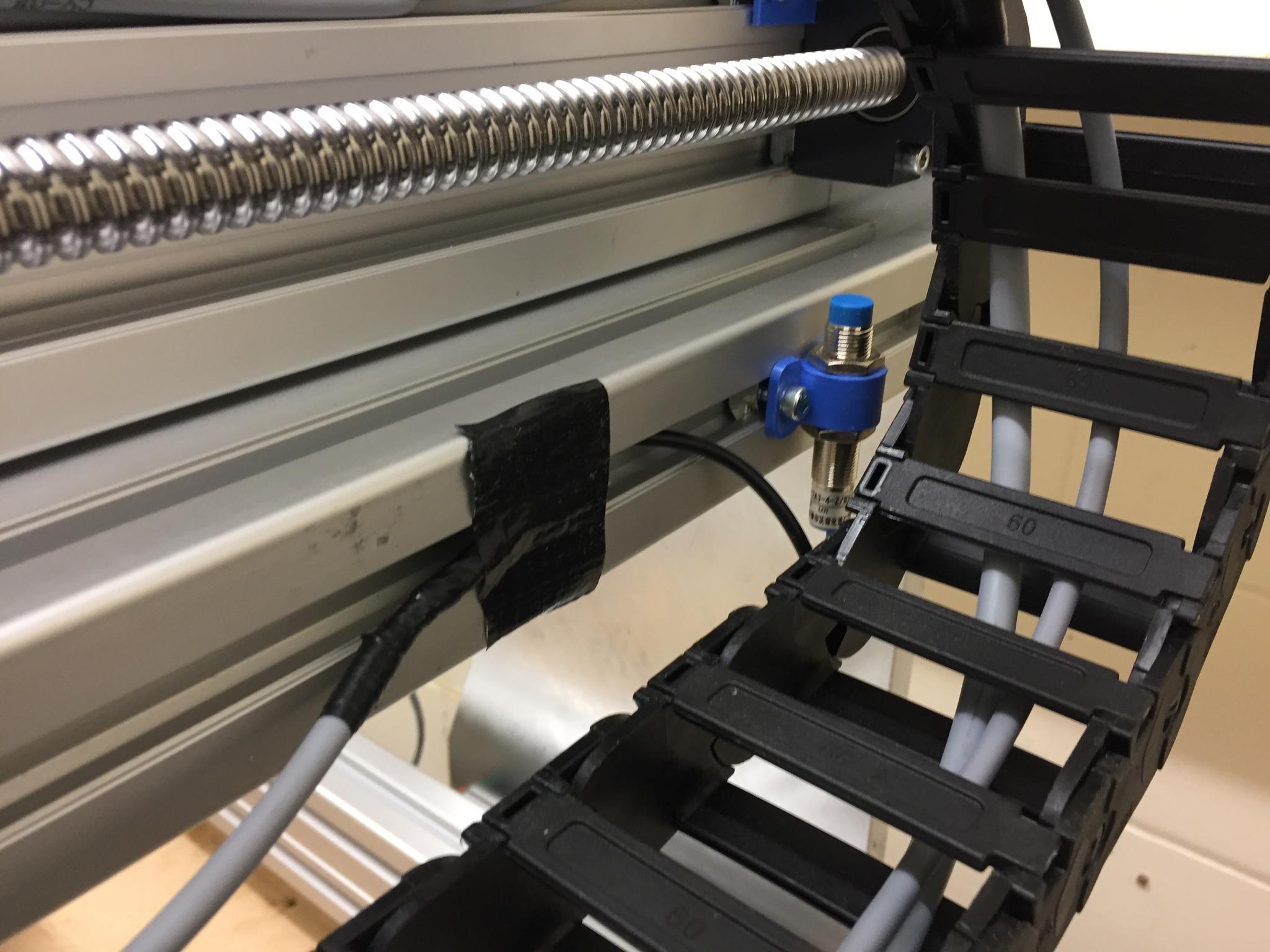

    5) Attaching various homing and limit switches, once again on 3d printed mounts. Laying cable in the drag chain.
ID:	26039Click image for larger version.
ID:	26040Click image for larger version.

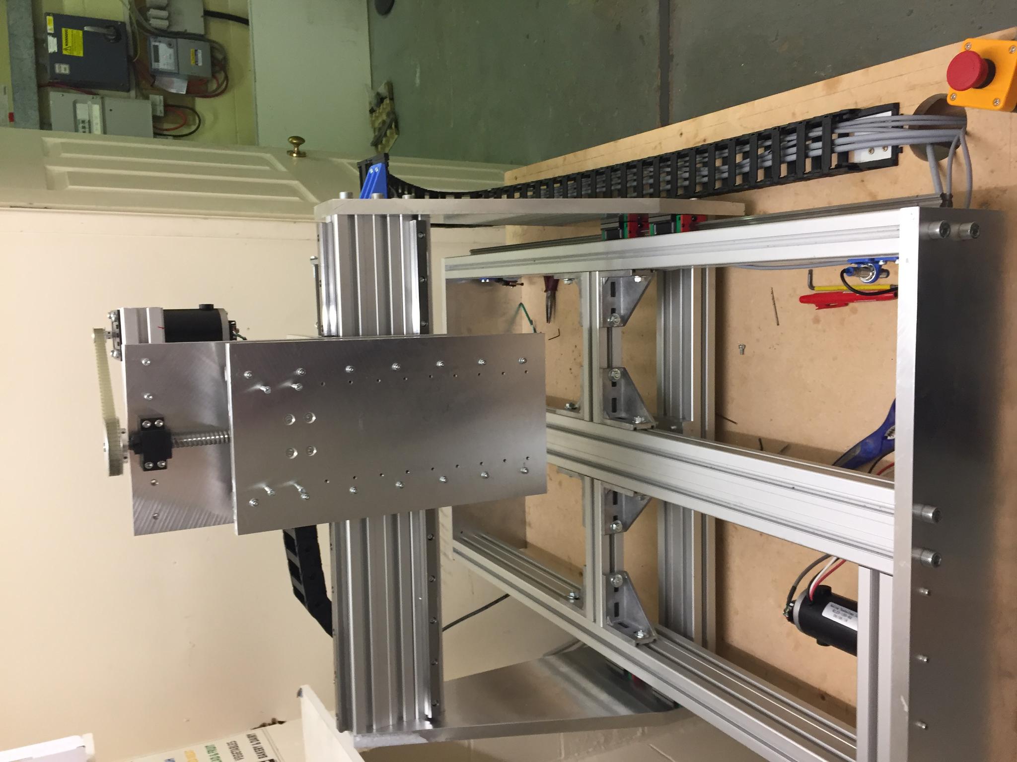

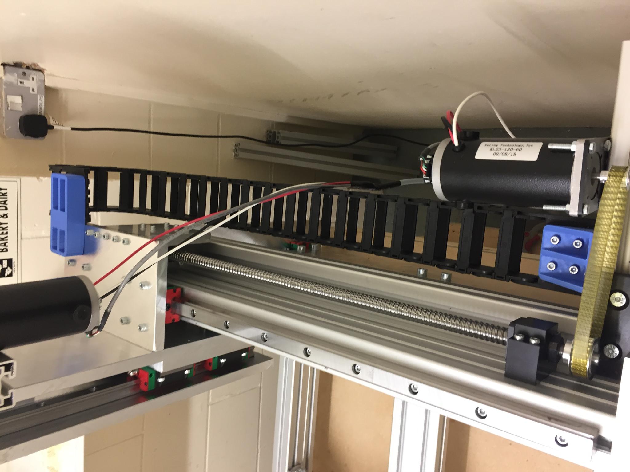

    6) Here is the basically complete machine!
    Heres a quick vid of the machine doing some initial rapids. Spindle yet to go on, but I'm getting 9000mm/min on the X & Y axes before servos stall. Thats setup for a theoretical precision of around 1/1000th of a mm with the encoders I have and running the UC400ETH at 200kHz. Obviously that precision is pretty goofy, I was just erring on the side of caution - still there is plenty reason to think I can squeeze a bit more speed and torque from this setup after a bit of experimentation and tuning.
    https://streamable.com/orect
    There is still spindle mounting and some tuning to do for precise axis scaling and servo PID controller tuning. After that I'll be moving on to spoil board, jigs and dust extraction.

    I love the control box! It's so much easier to fix everything to MDF than mild steel or aluminium and makes future changes a lot easier. It also allows you to concentrate the funds where they make a difference rather than just spending money on something that looks good. I've never quite seen the point of making one-off home constructed machines mimic professional, mass produced factory built versions. The priorities are completely different.
    The only possible problem is electrical noise, a discussion going on elsewhere on the forum. This is something you can address with additional screening and appropriately placed capacitors if and when it shows up during testing.

    Thanks Kit. I couldn't care less what it looks like, as long as it functions well!
    Everything seems to be ok so far - no interference yet, but it is very early days. I have implemented a single point star ground and shielded cable throughout, even on the limit switches - I am more worried about interference on all that cable than I am into the control box. Also, almost every EMI noise source in the room is actually sitting in that box already, so I'm not really convinced a metal enclosure will help anything for me! We shall see!
    Also, I've been meticulous in avoiding ground loops. Despite this, I did knowingly introduce one ground loop into the system - this loop goes between the control box and the VFD, and back through the mains circuit. I wanted to avoid this, but I also wanted to have a Z probe which worked without a crocodile clip. There were a few options I could see:
    1) lift the mains earth in the VFD - this would probably be the best way but the VFD is very high power and I was worried that earthing it through the signal cable shield could potentially dump a huge amount of current into the control box if the VFD failed. Then I would have to replace not only the VFD, but also debug and fix the whole control box!
    2) rely on a common earth between the control box and VFD - earth both to the mains, and assume that is adequate to close the loop on my Z probe. This would certainly have worked in my workshop - because I plug both devices into the same mains circuit so they share a common earth. However, if I ever moved the machine somewhere else and the two devices no longer shared a common earth, my Z probe would fail! This seemed like a really unpleasant easter-egg for future me (or another owner) to have to deal with!
    3) Knowingly introduce a ground loop. This may or may not cause an interference issue - but is safest option. No issues noted so far!

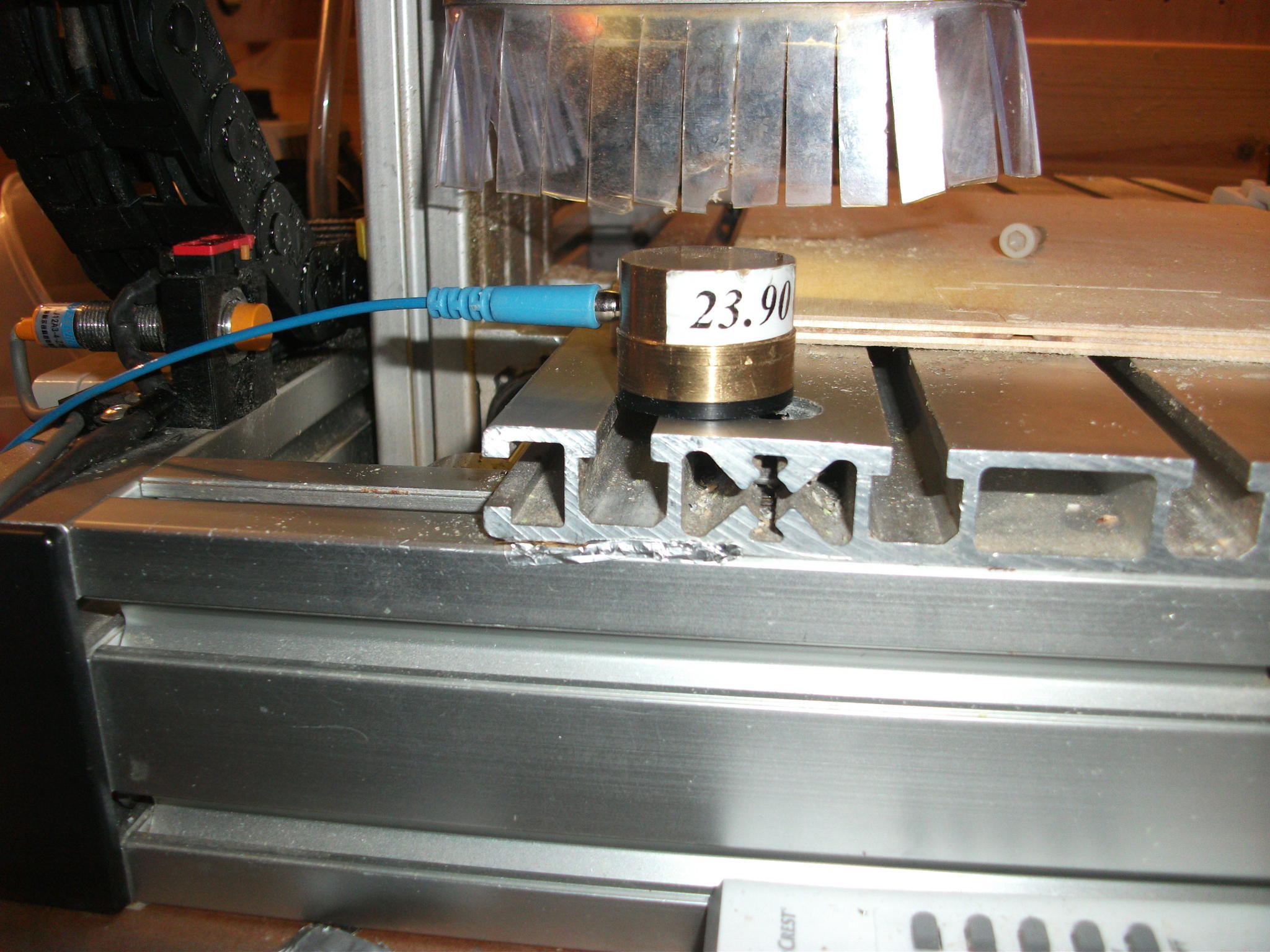

    My tool tip has earth continuity, so this type of touch plate works for me.

    Even though your spindle body may be earthed, that may not continue to the tool if you have ceramic bearings, so a switch type would have to be used.
    Have you metered the resistance between collet and spindle body ?

    I've metered between collet all the way to the BOB, thats what made me think it would work. I then tested the z probe (same idea as the one in your pic), thats how I know it works!
    Weirdly my spindle is quoted as having ceramic bearings though so not quite sure why it does work. But I'm happy so far.
