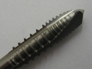

    The best taps I've found for through holes in ali are the blue ring spiral point types like this:
Name:	Europa spiral point blue ring.jpg
    They're made specially for aluninium, the interrupted thread higher up seems to help with binding. Typically I've found you can tap a hole in 12mm plate in 3...4 seconds with one of these in a cordless drill with some cutting fluid. For blind holes as Mekanik said you need to use a spiral flute tap (to get the chips out), again I've found the blue ring types are marginally the best.

    In a nut shell for taps-
    Spiral Point - Only good for through holes, as they push the swarf forward through the hole.
    Spiral Flute - good for blind holes, as the swarf comes up around the shank, but are more prone to binding if the swarf doesn't clear.
    My preference is always spiral point, as they're the stronger option.
    If you're only going through relatively thin section, I'd avoid the interrupted flute ones Voicecoil posted a pic off, as a bit inadvertent sideways pressure with only two or three support flutes engaged can quickly jam the tap and snap the tap/rip the threads out the hole.
    As always, lubrication is key. For tapping aluminium, a drop of good quality cutting oil is essential to stop things sticking.
    There are also threadforming / roll forming taps which can give a stronger thread in aluminium, but drill hole size is very critical, so I would advise against them unless you can control the hole size well. Undersize and the tap will quickly jam, oversize and you won't have much of a thread.

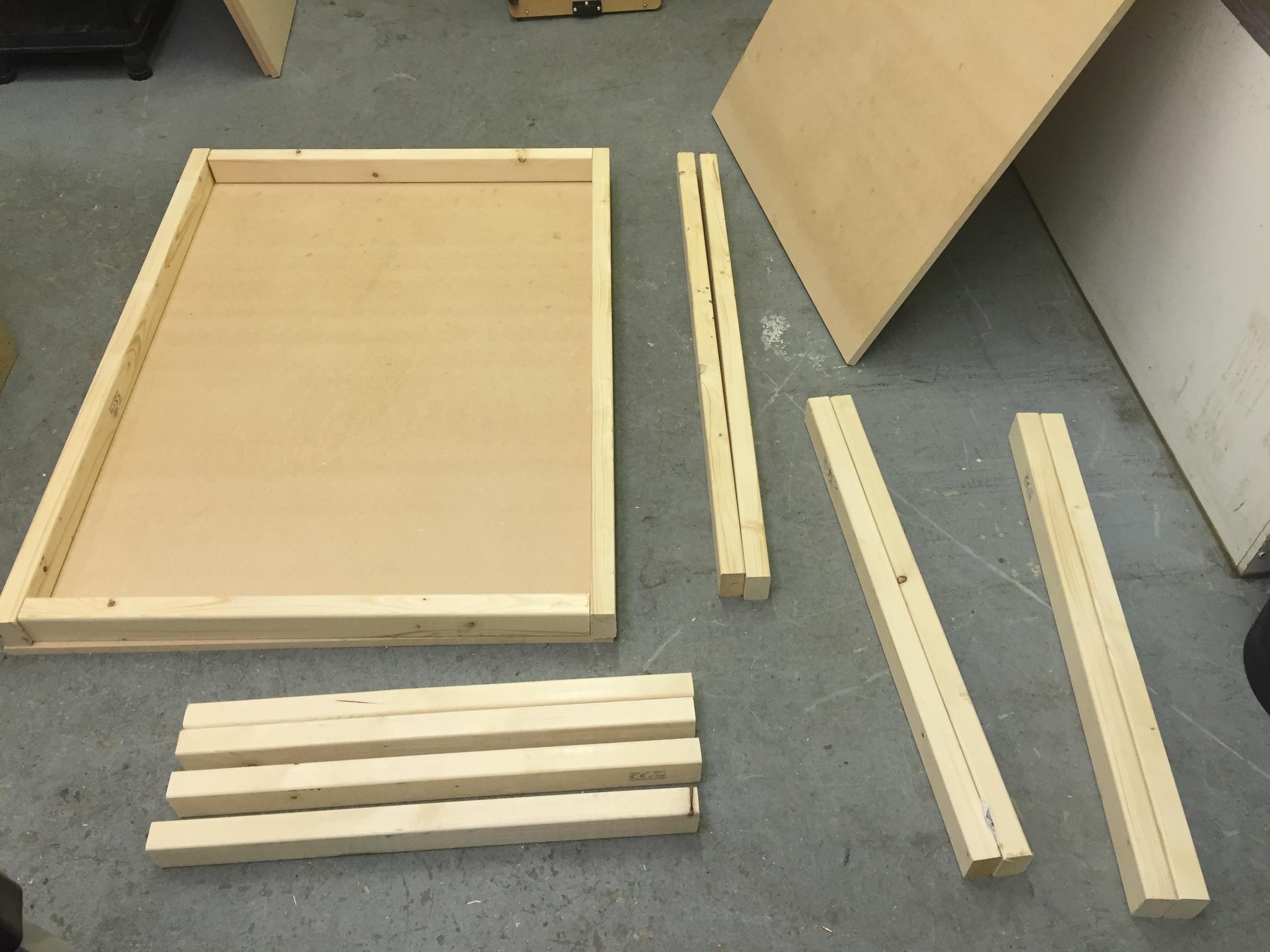

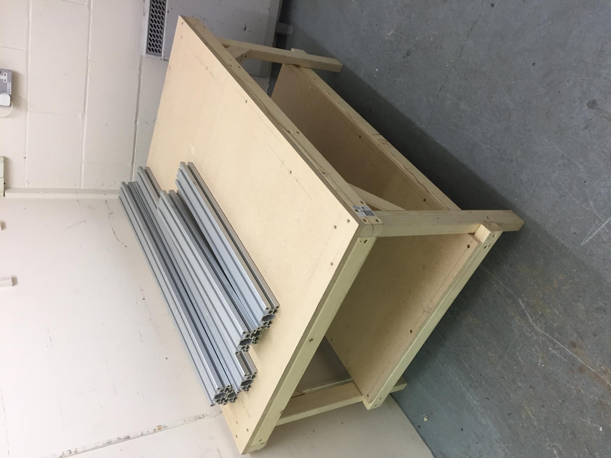

    Hi guys,
    Have not been on for a while as have been busy sorting out my new workspace and stocking up on parts. Thanks for everyone's various messages - don't have time at the mo to answer everyone individually.
    Its all go on the CNC front now my space is sorted and I have all my parts, so I wanted to post an update.
    Today I built a table for the CNC. 18mm MDF & C16 CLS timber from B&Q. About £30 worth of materials:
    1 Cutting to size

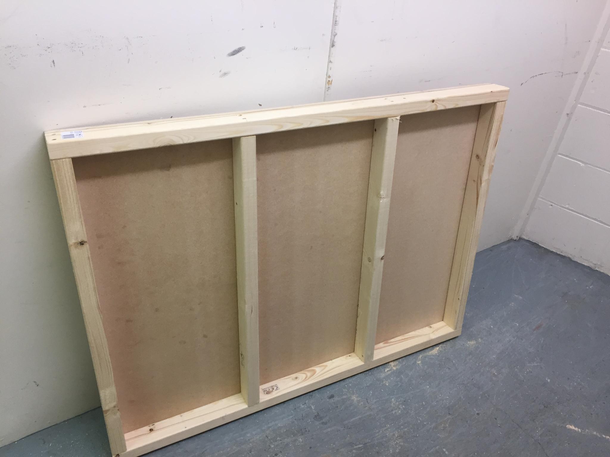

    2 Table top is 900mm x 1220mm; Supported by a timber frame:

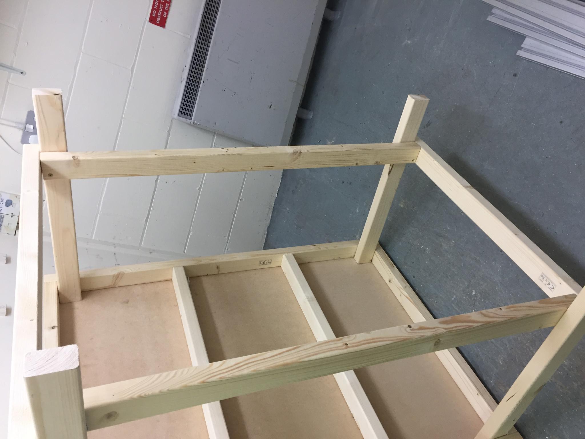

    3 700mm legs screwed on to table top:

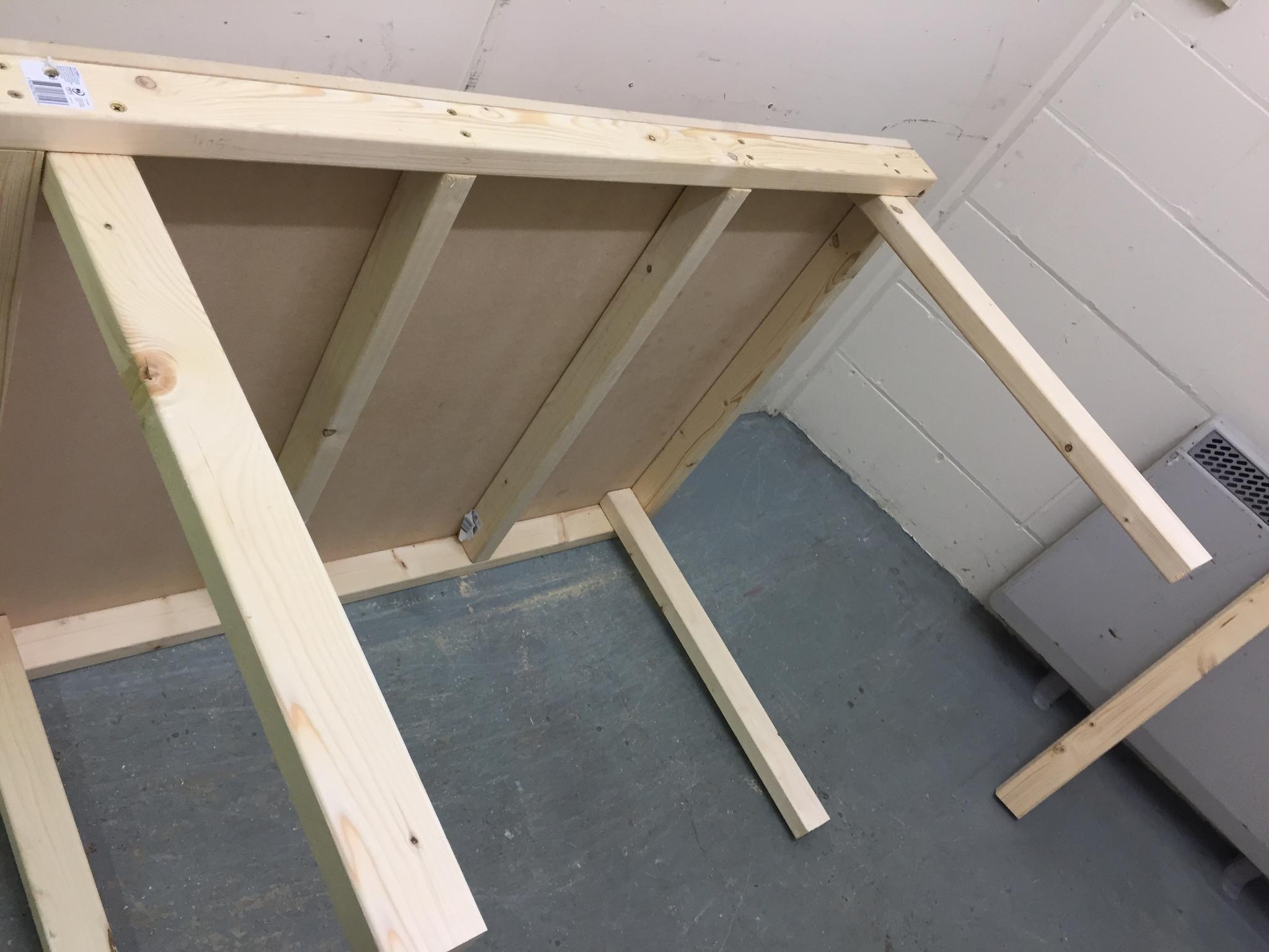

    4 timber base frame for support and shelf:

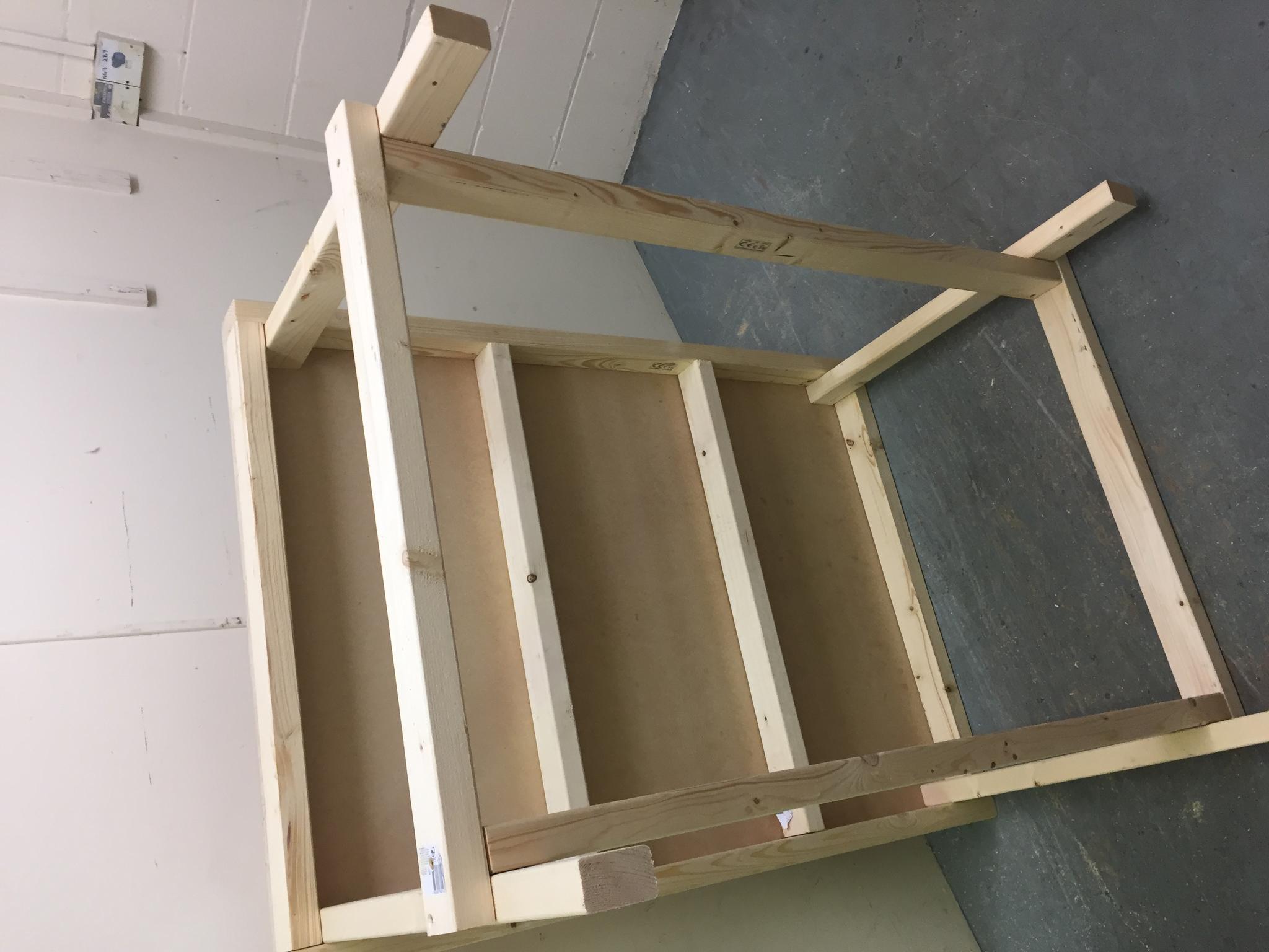

    5 MDF shelf for base frame, and a few corner supports for increased rigidity (may need more of these in the short-dimension in future)
    Table finished, ready to start assembling the machine itself:

  9. #39
    Doddy's Avatar
    Lives in Preston, United Kingdom. Last Activity: 16 Hours Ago Has been a member for 9-10 years. Has a total post count of 1,364. Received thanks 188 times, giving thanks to others 66 times. Referred 1 members to the community.
    Looking good. Just a thought - is MDF the best, most appropriate worktop for something that could end up working with water (if only a failure-case for the spindle coolant, for example). My point - I have a sacrificial MDF layer on my "electronics" bench - and that's suffered some small water damage from an ultrasonic bath - and the surface is now perpetually feathering and impossible to flatten. My personal preference atm is ply, but most of the shops are stocking cheap eastern boards with large filled voids. The bench I've used for the mill is steel framed with ply top, sheathed in 1.2mm steel sheet (I had a bit lying around) - that's tough as boots.
    I'm assuming that the bench is entirely separate from the machine? (it doesn't form part of the machine build?)
  10. #40
    Yes it is a separate bench - not connected to the machine - though I will probably mount the X cable chain directly to it. I will mount the electronics to the lower shelf for now and see if this causes any problems.
    I'm using an aircooled spindle so hopefully no issues with moisture.
