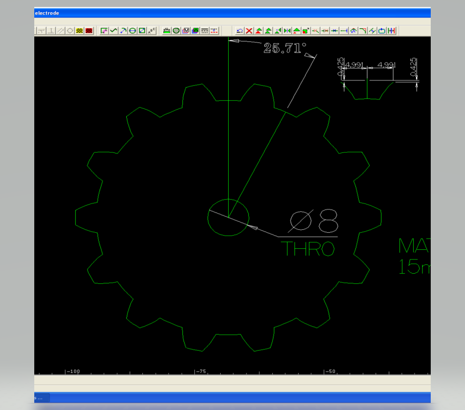

    Can anyone help me out with this one . I am milling splines on a cooper electrode but I’m having trouble writing my subroutine
    I want the 4 axis to rotate 25.714 degrees in a subroutine/subprogram so that i will have 14 splines around the circumference of my electrode these days i'm not with it offline programming as its been a while please help a fellow miller out

    Been a while since I have done any offline programming, I seem to use fusion even for the simplest things these days!
    I think what you need to do is this... This uses M97 so sub program is local (Haas only)
    For Fanuc you would nee to use M98 and have separate programs..
    N10 O1
    N20 G90 G21
    N30 G40 G80
    N40 T01 M06 (6MM CARBIDE)
    N50 G54
    N60 M01
    N70 S3000 M03
    M97 P1000 L14 (CALLS N100 SUBPROGRAM 14 TIMES) ;
    Z150 F1000
    M5
    M9
    M30 ; (END OF PROGRAM)
    N100 (SUBPROGRAM) ; ;
    N80 G0 X-6. Y-29.51
    N90 G43 Z50. H01 M08
    N100 Z1.
    N110 G1 Z-2.743 F1000
    N120 X121. F250
    N130 G0 Z50.
    N140 M09
    N150 G91 (INCREMENTAL)
    N160 B25.714 F1000 (B AXIS MOVE)
    N170 M90 (ABSOLUTE)
    M99 (RETURNS TO MAIN PROGRAM) ;
    Hope this makes sense/helps
