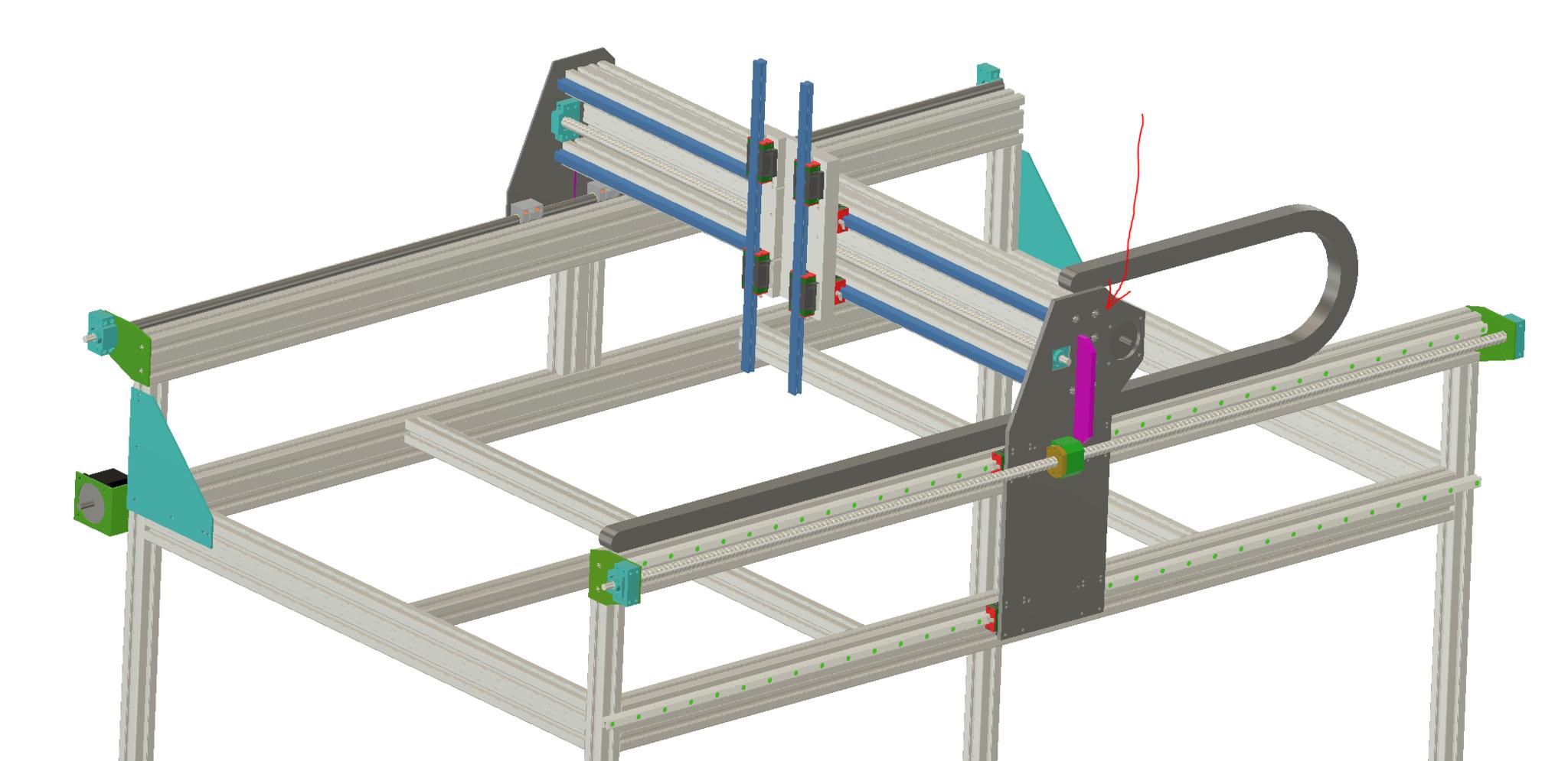

    It seems I have messed up my explanation here. I do not plan on using four rails, but instead three. Two linear HIWIN-style rails on one side, mounted atop each other. The other side only has one rail, and a different type, namely the cylindrical Igus-Style rails that you also often find in 3D printers, like the Prusa MK3. That will still take some work aligning, I get that, but it should technically work to help let the machine compensate. I know, technically is a nice word, but practically often takes precedent :D I have added another picture, with the HIWIN rails in their place, to hopefully make that more clear.

    When I first saw this design, I couldn't help but think that was far, far too flimsy
    Now with your explanation of the gantry driven from one side only (above)......it's getting worse!
    Don't forget that to reduce cutter breakage, wear, chipping, improve accuracy and surface finish, the whole machine must be as rigid as possible and subject to as little resonance and vibration as possible. This is why machines traditionally are made in cast iron or synthetic granite (Granitan etc) that are "dead" materials, they don't "ring".
    In the latest design, you are driving the gantry from one end only (and I still can't understand what the benefit is of the lower ballscrew). This goes against evrything that you will read on this forum, "ballance your forces", " place the cutter forces in between the bearings" etc. It is akin to digging a hole in the garden whilst standing on a diving springboard!
    And the 6mm thick gantry sideplate.......
    Compare yours

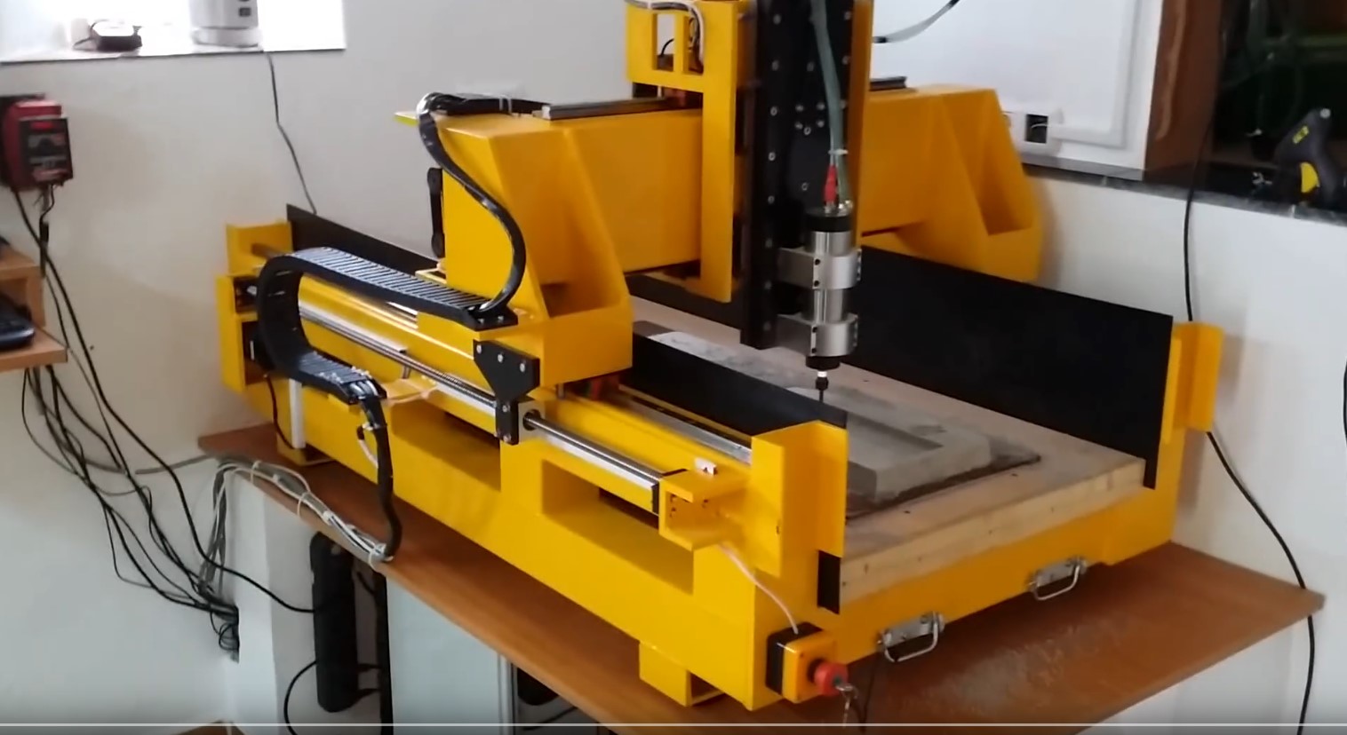

    with this from Boyan.
    Yup, Boyan's is built like a brick sh!thouse. Some may say that it's over the top, but I bet it does the job!

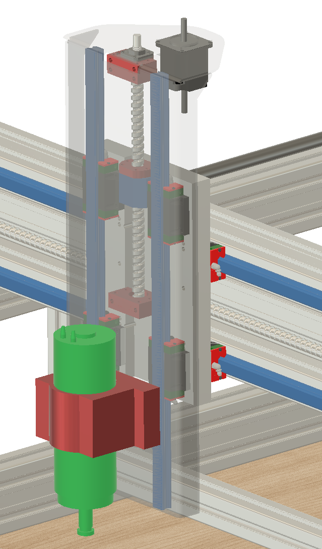

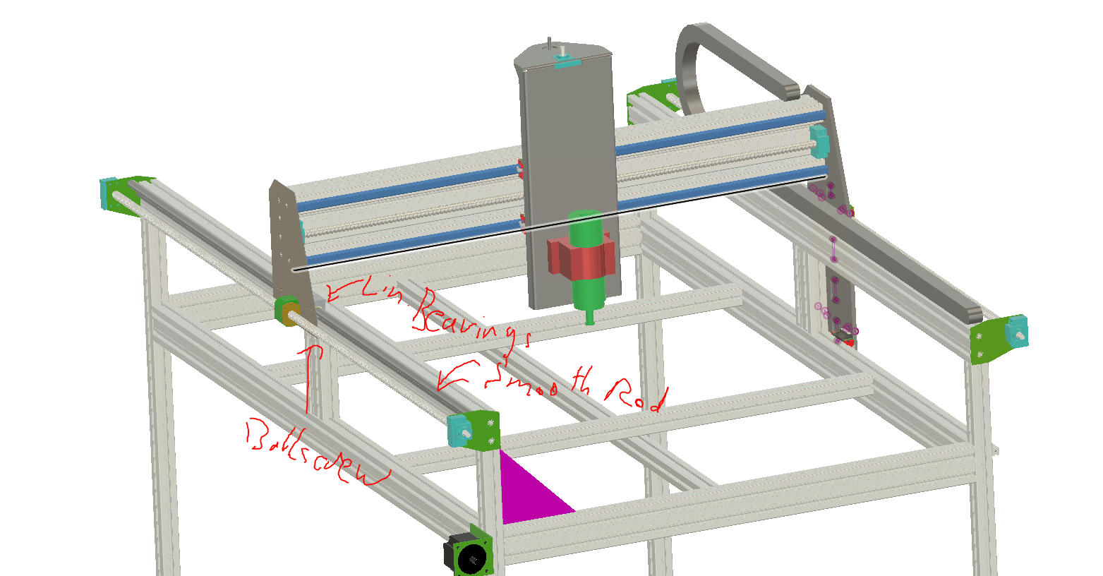

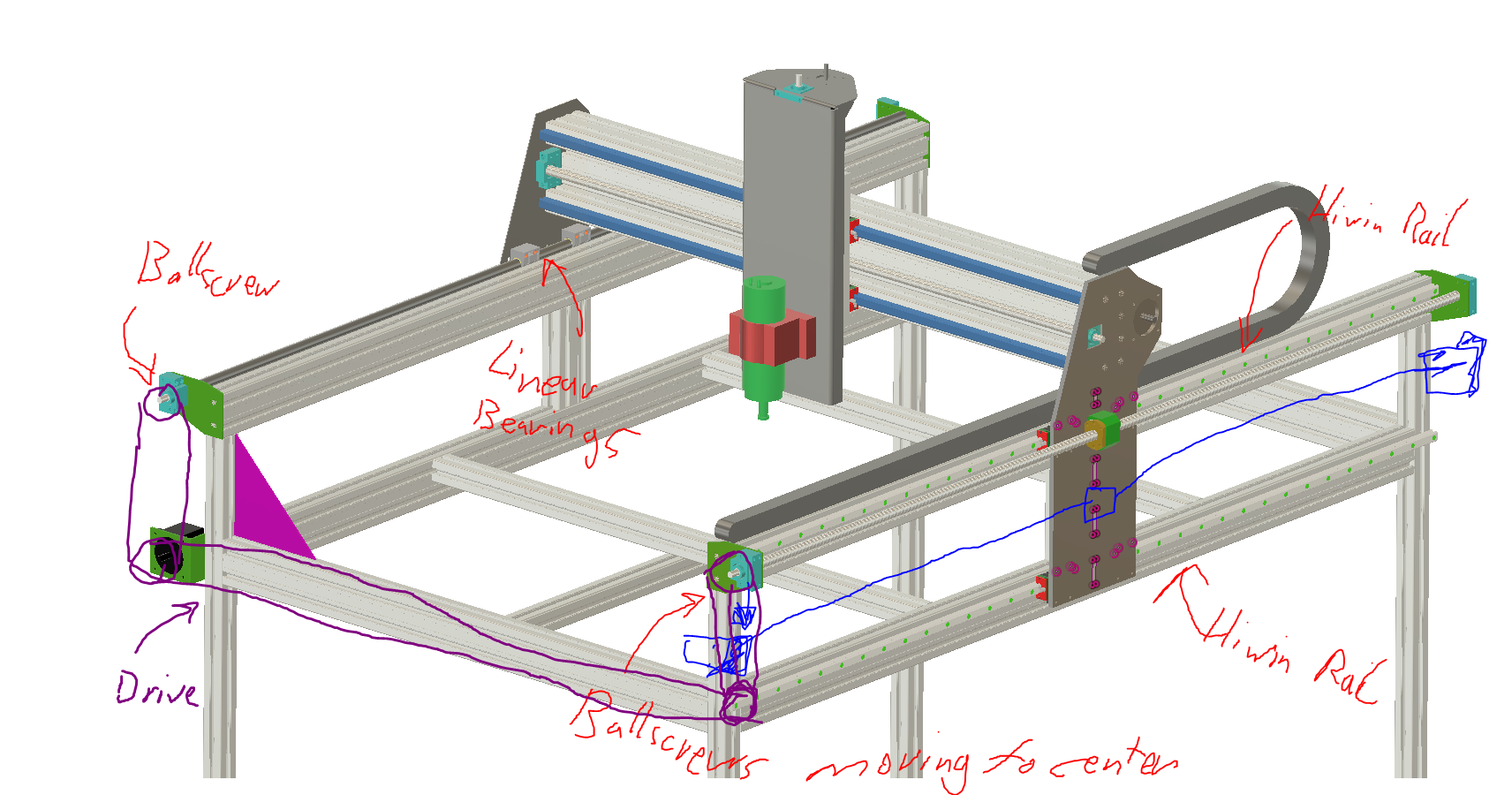

    First up, I am still driving the gantry on both sides. Just one side is resting on two HIWIN rails, while one is resting on a linear bearing on a smooth steel rod-type rail. Here is the model if you want a more detailed look.
    Secondly, I appreaciate the feedback, but what exactly are the problem areas here, what needs to change? Most design decisions come from advice I got from the mechanical engineers at my place of work, some of which have been building similar highly-dynamic gantry machines for Zeiss, taking measurements. This is also where the rail division comes in. Looking back at my technical mechanics textbook, this should protect the linear rails from having to take on torque, while still handling static loads. So that is the reason why. I, obviously, cannot tell you if that will work or not, but that is why I am here, after all :D

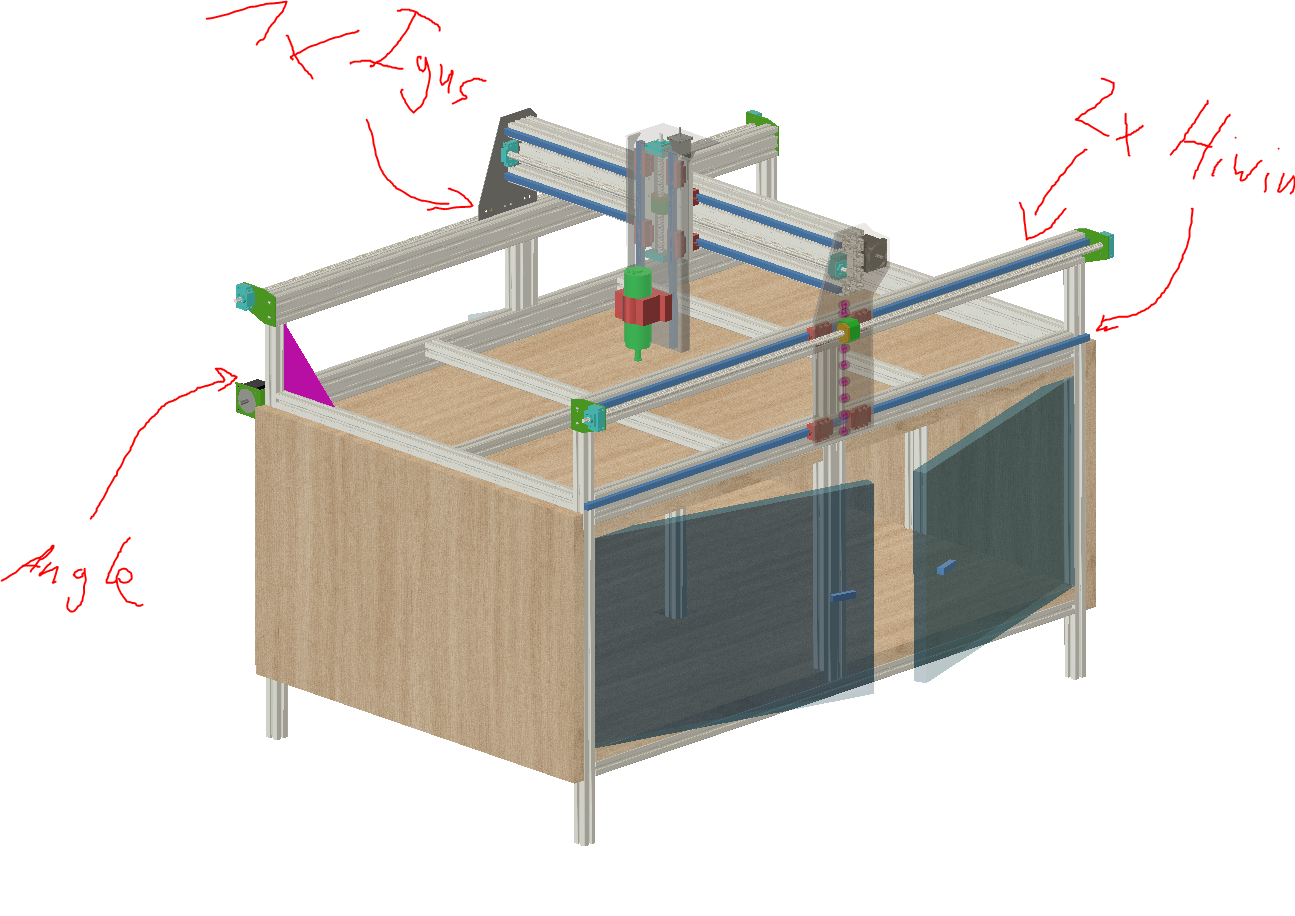

    Edit: Some pictures to illustrate the whole X-Axis setup, excuse the dreadful mouse-written writing.
ID:	26064Click image for larger version.
    Another constraint I am having, is that steel box section, for example, is pretty difficult for me to work with. I do have access to people who can weld for me, etc., but I pretty much have no way to assemble the machine where I need it to, in my workshop, or get it out of there, once assembled. It is on the first floor in my garage, with the only access being a small staircase barely wide enough for one person. Hence the aluminium profiles. If that is a no-go, the only other option i have, is a small hatch, not even high enough to kneel in, which will severely limit the machine's size, overall.
    Then there is also my budget, which is pretty close to being used up, even with that design.

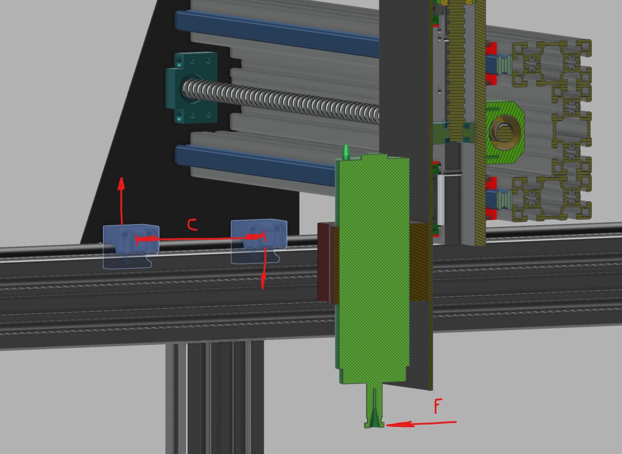

    Chrono, apologies for missing the second ballscrew, that makes a big difference. You at least have a brick under the end of the springbard
    Most builders here use rails both ends of the gantry to as best they can, constrain "flexy" elements (don't forget, most materials are looking for any excuse to bend, twist or vibrate).
    When your spindle is cutting at the 6mm plate end of the carriage, Hiwin rails will help resist the twist on the gantry better than the Igus ones. And either way, increasing the distance "C" between them will help.
    I mentioned Boyan Silyavski's build
    http://www.mycncuk.com/threads/6457-...my-first-build
    not to push you towards steel, Al is fine, but to demonstrate by design, reducing the chance of flex and vibration.

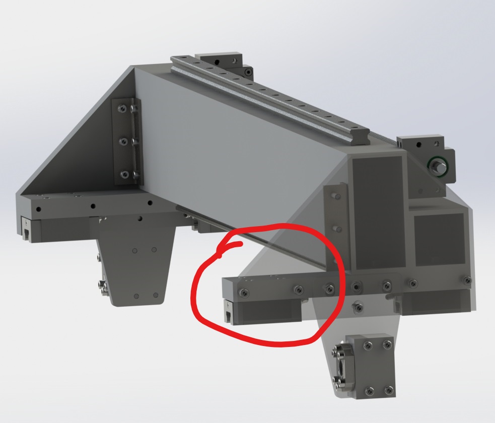

    Re. the 6mm gantry end, I think that you mentioned that it is to "...let the machine compensate". I guess that you mean "to accommodate assembly/build errors" One way that others achieve this with rigid side rails and substantial side plates, is to mount the Hiwins on the top so that with clearance holes in the sideplate mounting, they can find their own best position on the carriages. See AndyUK's approach. Again, I am not pushing you to change, just showing other approaches to your best friend "rigidity". Also, bracing across the end is another approach.
    I have a background in manufacturing with machining centres and lathes with capacities up to 1200mm, precision grinding and measuring with CMM's in controlled environments. Whether it be a CMM or a cutting machine, we want to be assured that the probe or cutter is in a specified and known position. The difference betwen the two are the forces in the system. Those in a cutting scenario being far greater....
    Regarding the side rails, it wouldn't harm if you added one or two extra pillars and fillets per side. Also, bracing across the end is another approach.

    That cleared things up a lot, thanks! I gotta admit, for a second there I thought the aluminium profile construction was "out of the question" entirely, so to speak, so I am relieved on that end
    I also thought about putting in some more support pillars, so I will do that. They are so short anyways, that they don't cost enough to not put in. regarding a crossbar, I could easily put one in in the back, without even impeding X travel, since the gantry's body will sit on top of it, and it will run out of rails before the spindle would even get a chance of touching it.
    You also put in angles in the middle pillars. I definitely see their point, but I am looking at them protruding into the machining area, so I might try and make them removable, with accessible screws, so I can put them there for smaller projects, and take them off, when I need the space. That way I get the best of both worlds, so to speak.
    Also, regarding the distance between the bearing blocks on the X: That is one of the parameters I can just change on-the-fly, so changing that is easy-as-can-be :D I am mostly leaving it as a kind of place-holder while I am working on getting everything into place. Afterwards I just need to open the variables panel, and go to town dialing everything in.

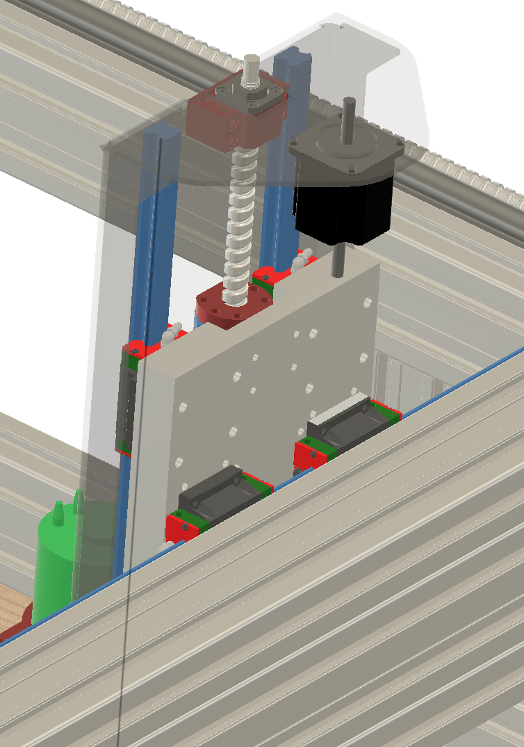

    Finally, on the topic of the thin plate, and the associated double-stack of rails, with one opposite linear rod bearing: It is not that much about building tolerances (I mean I am not perfect, so there will be those), but also things like thermal expansion, and so on. I am going off of the one lecture in mechanical engineering I got in my electrical engineering course, but with the linear rails on both sides, you would enter statically-overconstrained territory, which is exactly the reason for me to go for the steel rod and linear bearings, exactly because they cannot take on torque. however, if this ends up not panning out, changing the lower rail over, would be quite easy, since all i would have to do is cut down the gantry extrusions by 7mm (which the linear bearings are higher by, compared to the rails and bearing blocks), or shim it with another plate, and swap in one of the rails, not a big hassle.

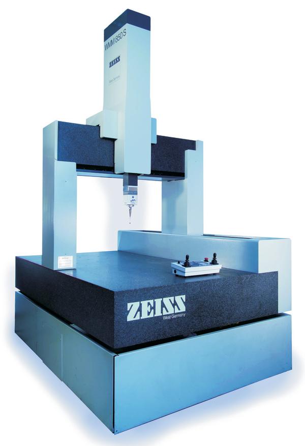

    And I found a picture of the Zeiss machine I was talking about: Click image for larger version.
    As you can see, it has a similar design, with rails on existing on the right, while the left either rolls on the table or hovers on it, I cannot remember if the hovering was another machine, though, and a quick search did not throw up any info. Either way, looking at the YZ-Plane, one end is fixed, while the other is allowed to expand/move. Of course, that does not mean that it works the same for me, but I thought I would post that for illustratory purposes :)
    I also plan to add some slits in the plates themselves, serving as holes for potential cross-supports, should it turn out that they are, indeed, too bendy. I will attach a picture hereafter, looking at the right plate, with such a support in vibrant pink. I am afraid that picture can explain this much faster than I could in words. Those plates should serve to add further rigidity, in the same sense as the bends all around the Z-Axis do, and if I find I need them, I can put them in, weld them in place, and go from there.
    (also seen in the picture, in the front left of the machine, the WIP of new angle plates. The right is not in yet, because I still need to move the right ballscrew vertically in between the two rails)
    What do you think of those measures to address these problems? Is there anything else I should be doing to increase the rigidity?

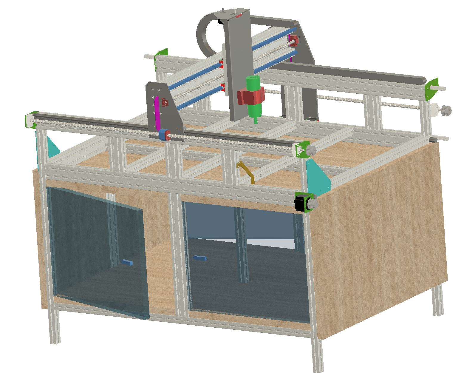

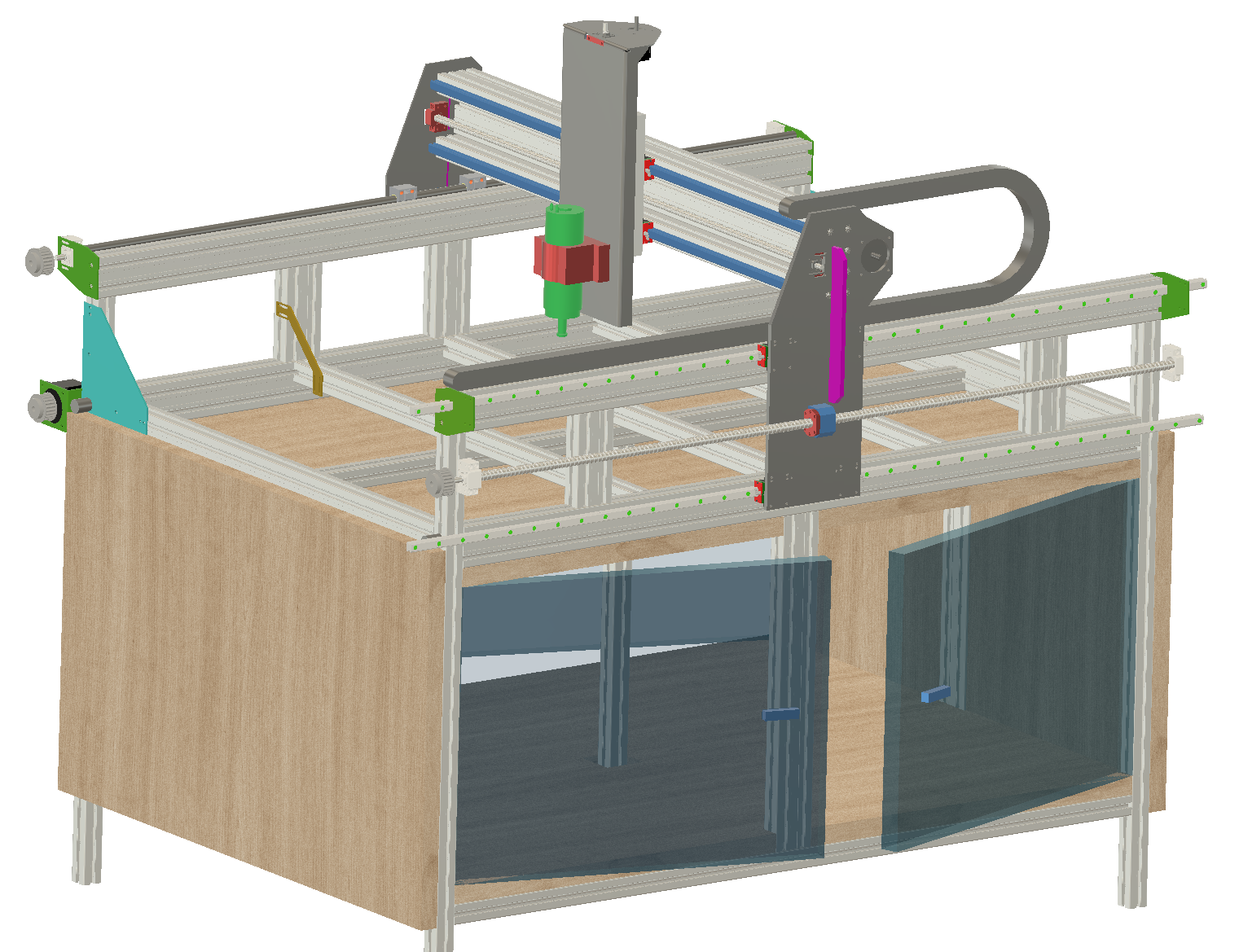

    Long time no post, was busy these last couple weeks, but I am finalizing the build. Pretty much everything is done, except for the timing belts and the electronics layout.
    I solved my motor problem by simply shrinking the machine to a tiny 1.8m on the X-axis. This allows the use of the smaller 2010 ballscrews, and, in turn, a single motor.
    Other than that, I have been verifying dimensions and hole placements and been putting in manufacturer CAD files for all the rails and screws. I have been putting together some angles for the inside (the yellow one in the left side of the machine in the picture) that I can remove if I need the width and otherwise keep in. Since the CAD file already takes ages to change anything in, I only put in one, to keep the computation time down a bit, but the plan is to have two per column.
    I guess I only have 4 questions left:
    1. I have seen that people usually use transformers for their steppers, and I understand that that is because regulated PSUs may have problems with the current spikes (at least according to the app notes). I could not find a proper post on how to do it on here though, so If anyone has a good source on that, that would be perfect.
    2. How do people usually tension their belts? I am still trying to figure out where to place my tensioners.
    3. Where do you even get belt long enough for something like this, and what type of Belt? Using a manufacturerer's tools, I have been able to calculate that my belt would be approximately 4.8m long, for the X-Axis. I have not found closed-loop belt in that size yet.
    4. Is there anything you would still change in the design? When I say finalizing, I mean that I am compiling prices and sources for my parts, and ready to pull the trigger whenever I am done and move this over to the build-log section, so this is the "final chance" to change anything, so to speak.
ID:	26188Click image for larger version.
ID:	26189Click image for larger version.
ID:	26190Click image for larger version.
    As always, here is a web browser accessible version of the model if you want a more detailed look.
