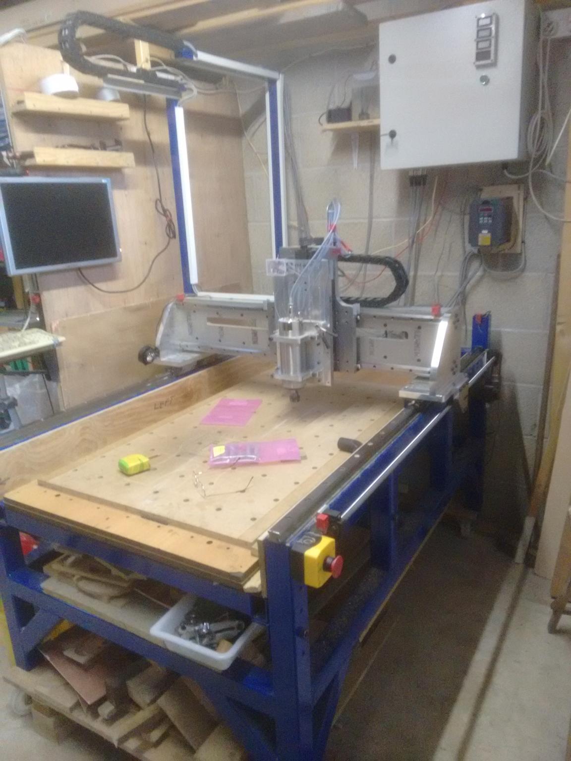

    1610 and about 70kg
    there are two 1000x60x60 x5mm box section behind the front plate on the gantry.
    Also you don't need the screw to be the full length of the machine
  4. #24
    I like the ajustable bed.
    How wide are the plates top and bottom of your gantry. As you have slotted your gantry for ball screw.
    I like the look of your gantry.
    The slot in your gantry is what I had planned for my box steel,so I could fit the ball screw inside. But I didn't realise how much strength I was going to lose. I ordered 8 mm thick to allow for it. After posting here and getting the information realise it will weaken it to much.
    Sent from my SM-G900F using Tapatalk
  5. #25
    If I was doing it again I probably would have used heavy duty ali profile formed in a L shape. But that was my first router.. Gantry front plate 1000x210mm
    Some pics here:- https://photos.app.goo.gl/cfbXGLBdxYvB9s536
