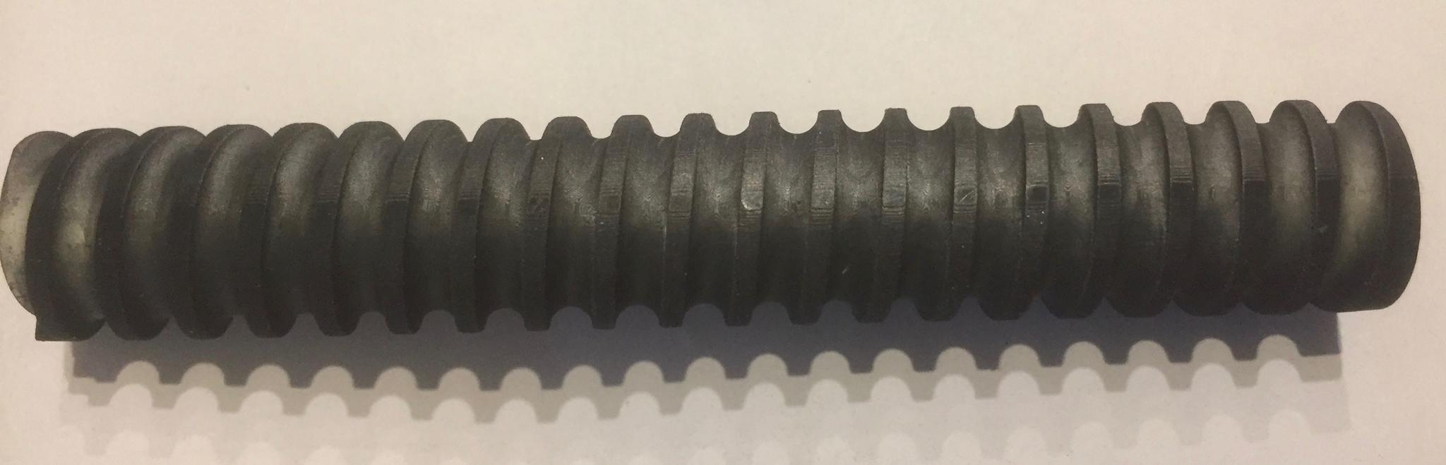

    Next bit of fun... I tried printing a packing tool to help on this job (I do still have one spare ball nut somewhere)....
    Isn't that cool!!!
    Now, look closely at the thread rotation.
    My how I laughed.
    Another 3 hours to print this the correct way.

    In time you printed that you could have packed 10 ball nuts. Nice find on the kit though
