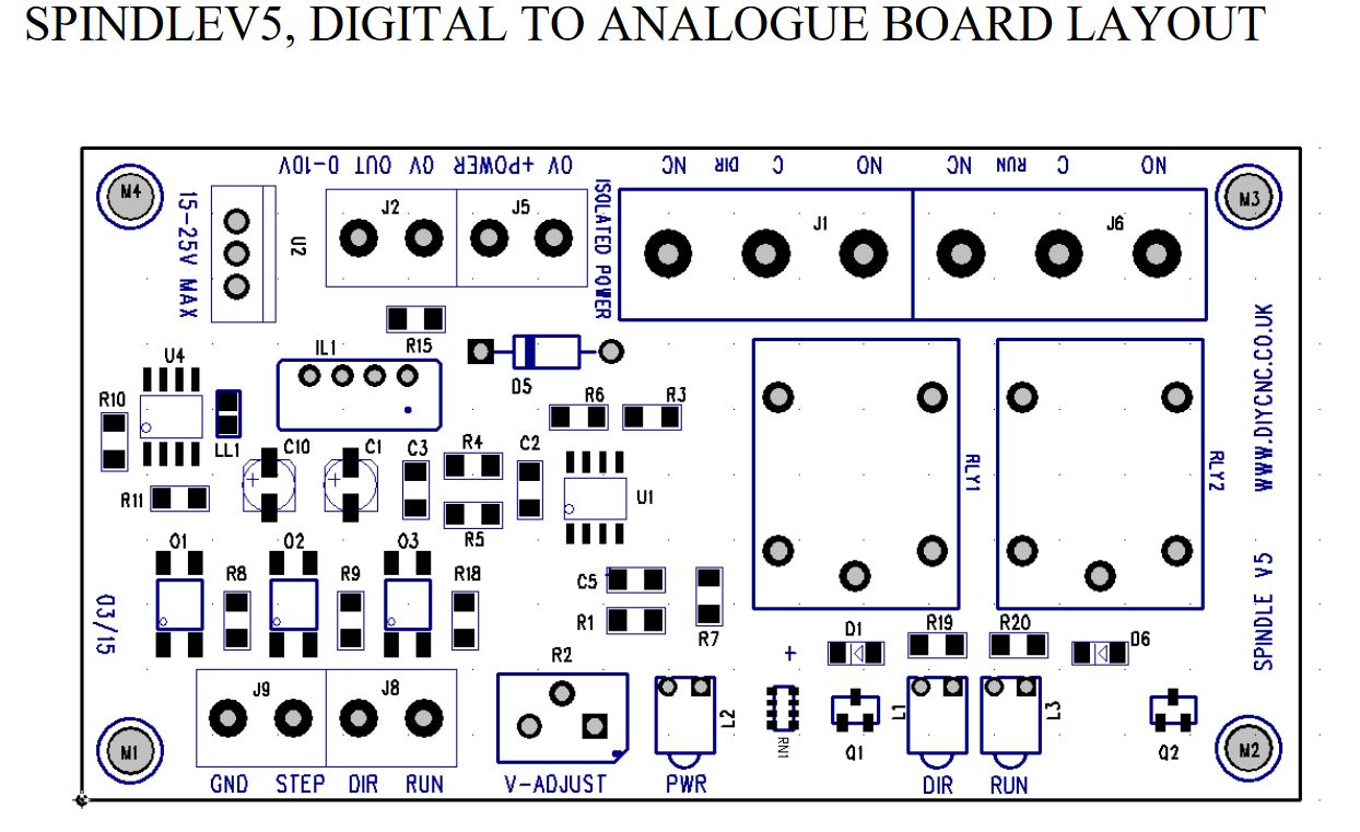

    Looking at how the system is set up at the moment I am a little bemused. The motor control relays on the Spindle V5 aren't connected so I assume the Sprint board turns the spindle on/off (or the Cable porter spindle is soley controlled with the 0-10v output). Either way am I correct that for the spidle powered by the VFD I don't need the Sprint? If this is the case my easiest (and foolproof) option is the simply add a new Spindle V5 and add a connector so only one can be used at a time. Can you suggest any PWM to Analogue boards to ue instead of the spindle V5?
    My setup is wired similar to this except the stop/cc and stop/cc are not used
    Spndle V5 board for reference

    I’m not familiar with the Spindle board (and on mobile so not going to start googling) but looks to take step/dir signals to generate the 0-10v analogue output - why not simply use the or a similar replacement (as you suggest) - if it ain’t broke....
    The other easy alternative is a parallel Bob with onboard 0-10v output but that would need a PWM Drive from the controlling pc for effective speed control.
    I could suggest you’d be best taking the RUN relay output from the Spindle board (if used) into the FOR input on the new VFD

    Missed a bit... have the connectors between the Spindle board and the Sprint/VFD, no need for two Spindle boards

    A reading of 1?, okay, gonna ignore that and keep with the "always closed" statement - so the Spindle V5 card isn't actuating the CW/CCW outputs?, that sounds more like an integration issue between the SpindleV5 and the controlling PC/Mach3.
    Step forward a bit to where they are working, and you couple the N/O CW output and ground between the VFD FOR and DCM pins, then set PD001 to 1 and that's your motor on/off control, and the 0-10V I think you've got working onto the VI input and set the PD001 to 1. And Bobs your uncle.
    Looking at the Spindle V5 manual - this takes a Step/Dir input from a BoB - which clearly is set up okay, but it also expects a digital output from the BoB to actuate the Run control - which I'm guessing is what the Spindle V5 uses to drive either CCW or CW output relays. For that - check that the RUN input on the Spindle V5 is connected to a discrete output on the BoB, and that is bound to an output number in Mach3, and that output is specified in the Spindle Control page on Mach3. Details in the user manual. The goal here must be to get the CW relay switching.
