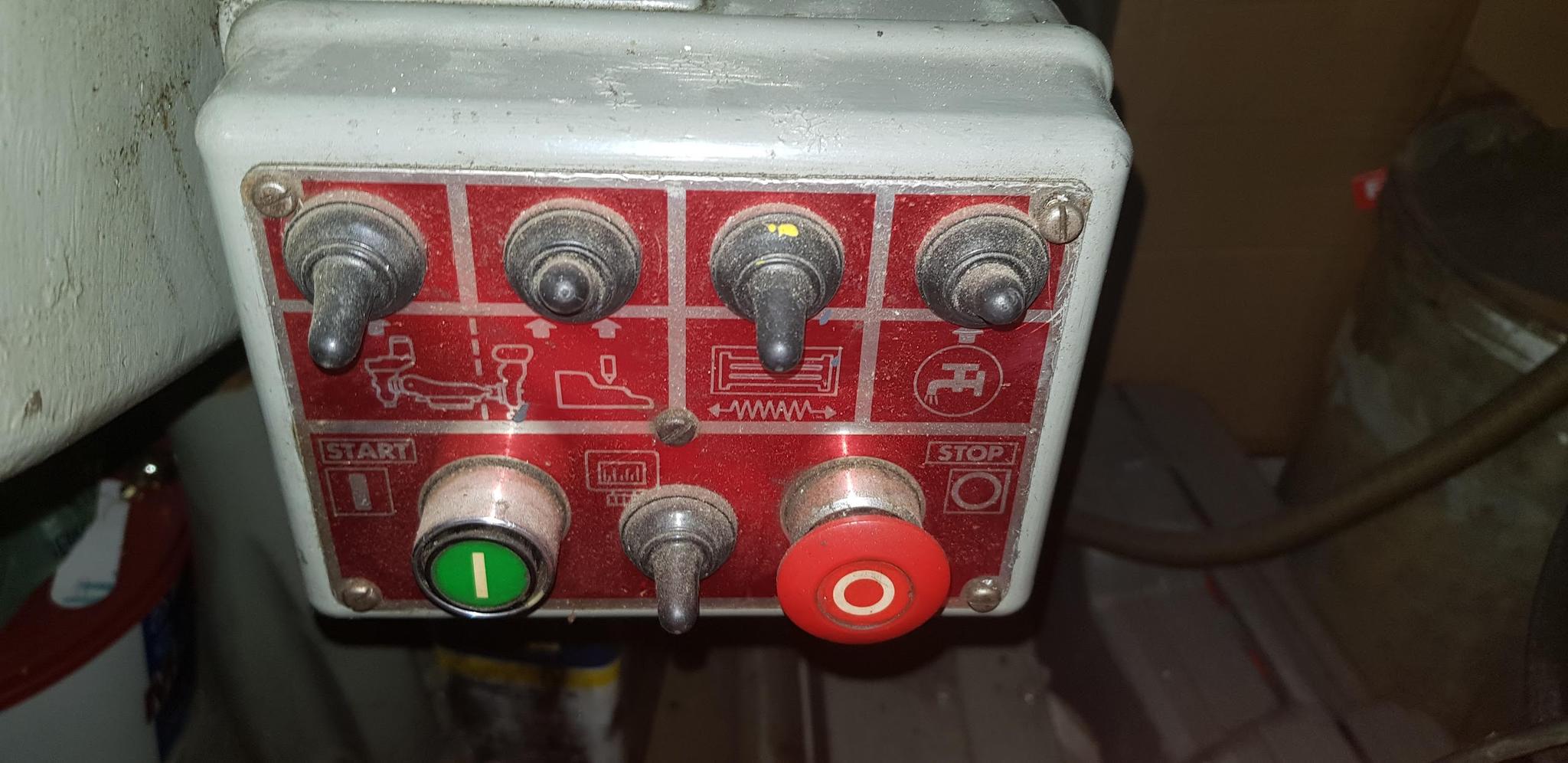

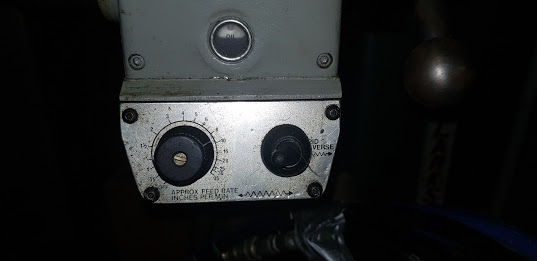

    Also, regards the power feed for the table X, I had the feed dial above zero, and I think I engaged the feed out of neutral (using the long bar in-front of the bed), but didn't get any motion - any ideas what could be wrong?
    I've also got this switch panel which I can't seem to find out what the switches are for, some help would be appreciated! I guessed that the one with a table like icon on the top row (3rd from left) might be the power feed on/off, but it didn't seem to matter which position that switch was in.
    What do all of the switches on this panel do? And the one between stop/start?

    Table feed settings:
