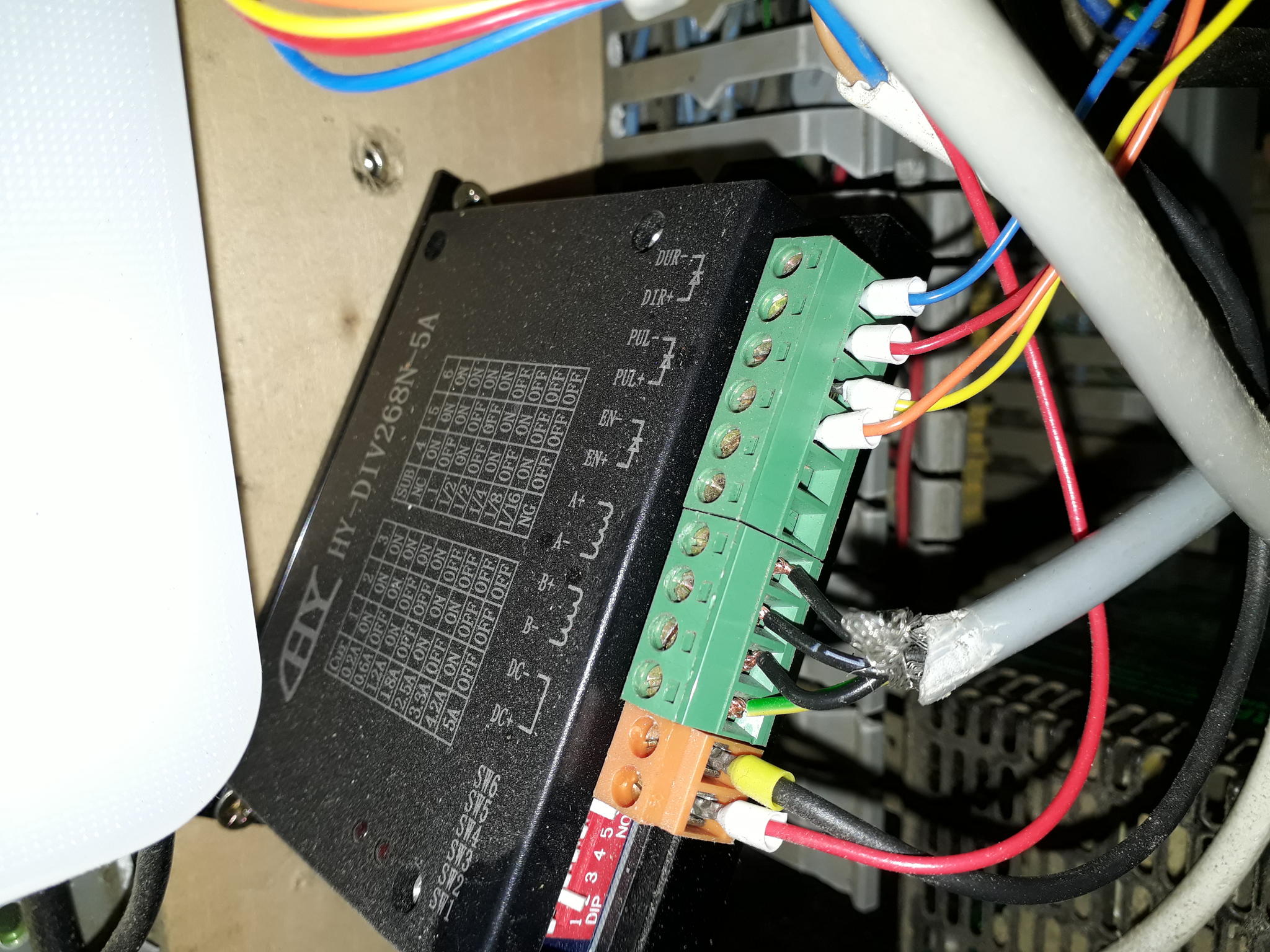

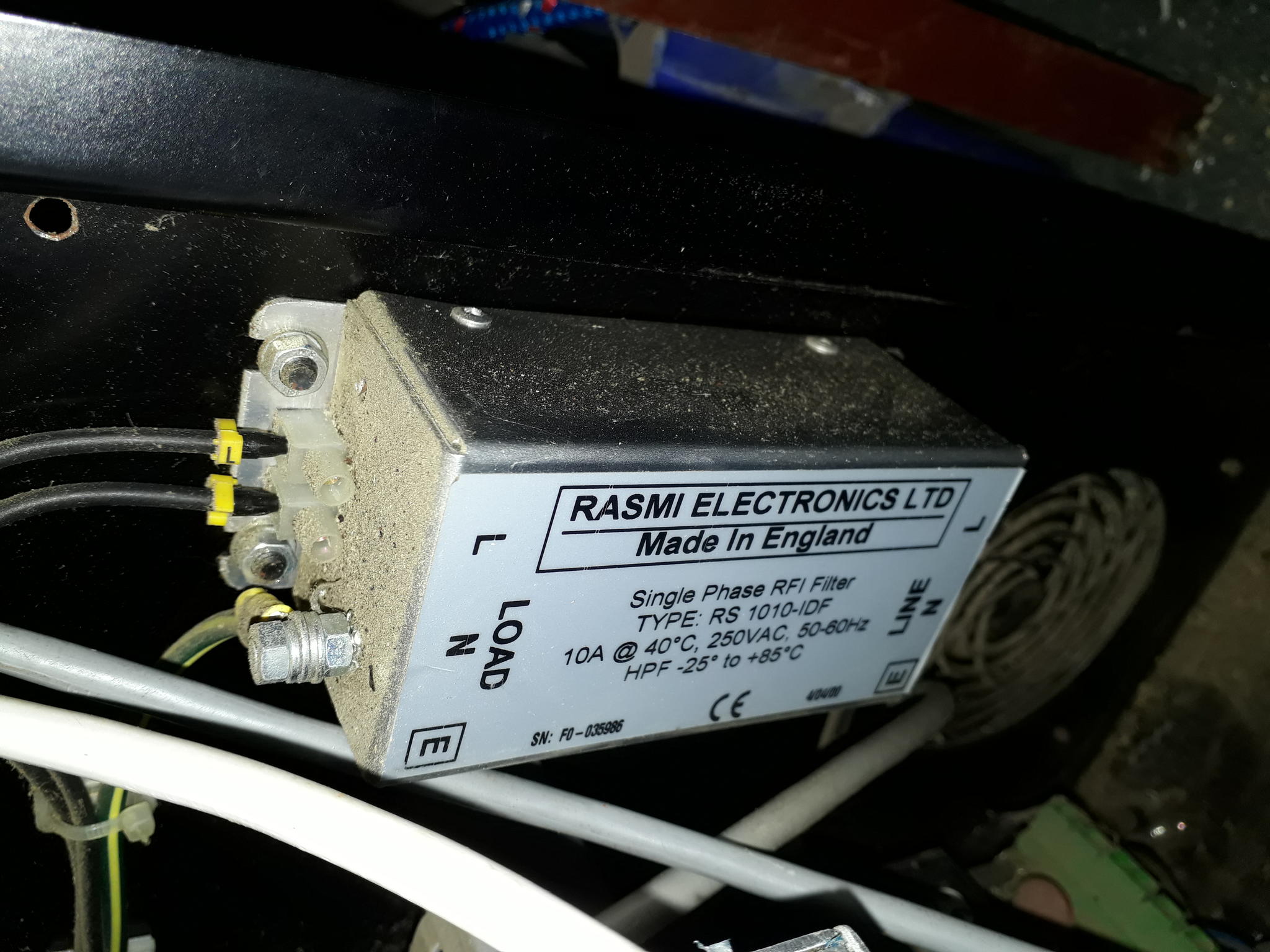

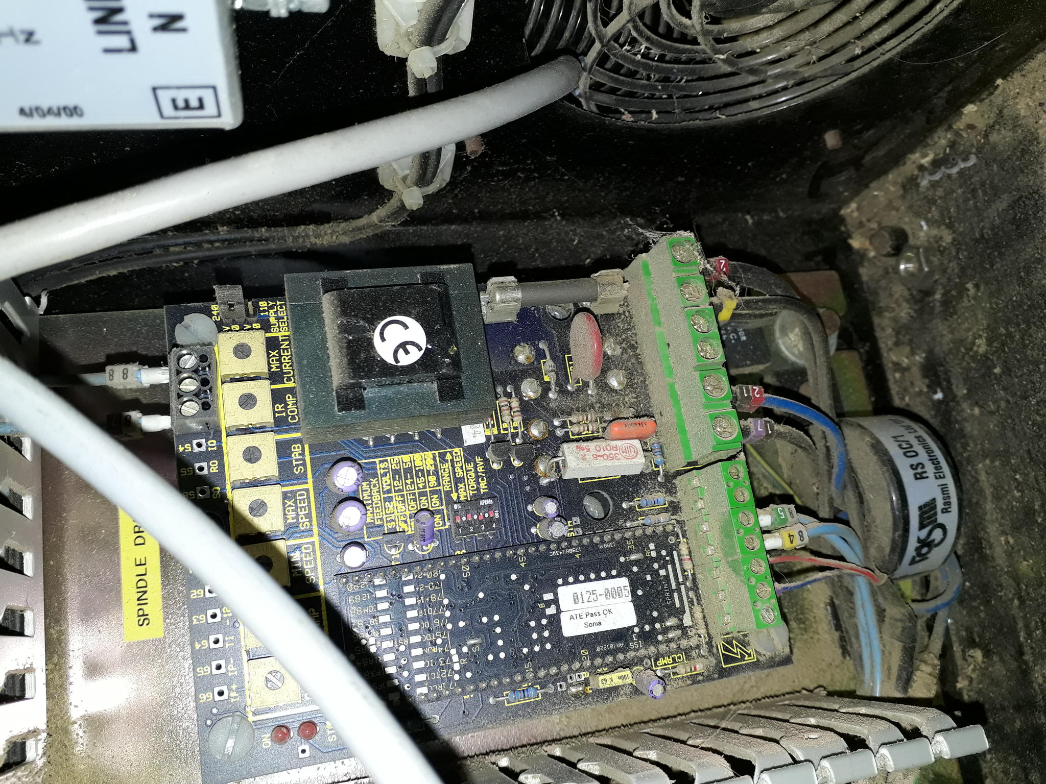

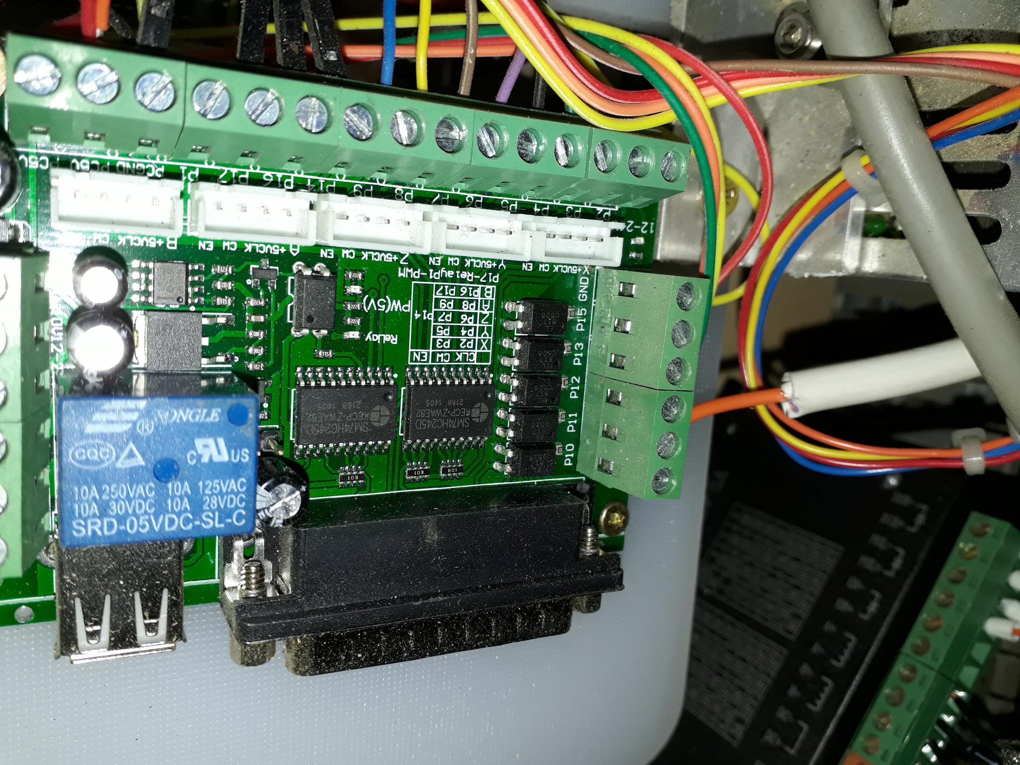

    The on/off and speed of the spindle fitted is controlled by a Spindle V5 board (https://0201.nccdn.net/4_2/000/000/0...spindleV5x.pdf). I have attached pictures of all the other internals in case information on them is needed.

    id also be very surprised if you could find a suitable spindle that is a straight swap.
    I didn't expect to be able to do a straight swap (though it would be nice). Would I be better looking at a new spindle and building a new control box for it? It would certainly make swapping between spindles easier/
    The BoB you have, I am certain, has 0-10v output to control spindle speed with a VFD and Spindle setup, so you don't need any more electronics apart from the VFD. The rest is setting it up in Mach3.
    Thanks, so which spindle should I be looking at bearing in mind it is for finishing only so RPM is more important than power.
