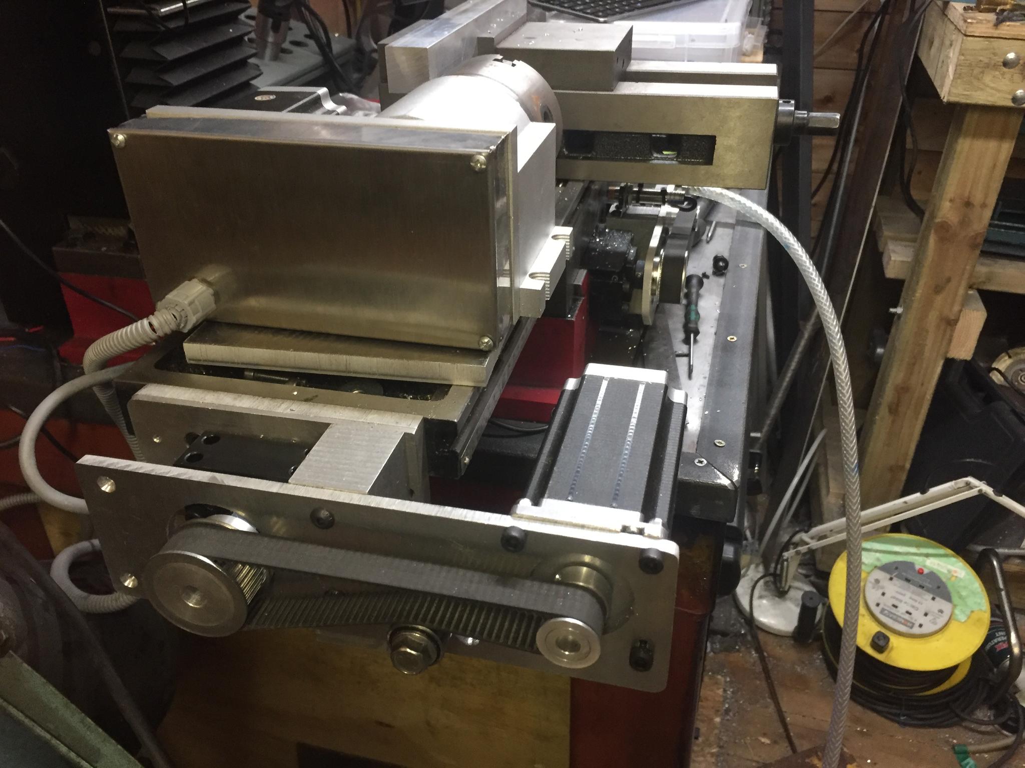

    Some detail on X - ignore the hack job on the ball nut - I was trying to expose the nut holder's bolt hole in situ to unbind the screw that was slightly misaligned after I'd tightened all bolts. That was a difficult few minutes with a Dremel and none too pretty.

    I am attempting this conversion on a new SX2.7. Do / did you find any problems created by the belts creating a small amount of backlash as the motors change direction? How critical is belt tension and does the additional side loading of the motor shaft bearings created by tensioning the belts concern you?
    Dennis
    The belts each have tensioners (just a M8 or M10 in a machined slot to allow any slack to be taken up, packed with bearings to present a rolling surface to the belt). There's no discernible backlash (yes, of course there's theoretically "some" but not enough to worry me) - choice of HTD belts obviously helps to some extent.
    How critical is belt tension?, don't know - took out the slack and I can measure a step on the stepper translating to linear motion.
    Side loading on the motor shaft bearing?, if it's a problem I'll replace the motor, it's worked well for 18+ months with light use. The bearings are designed for radial loads so I'm not losing sleep on that one.
    You have to consider the scope of the mill - is a mini bench top mill - nothing more, nothing less.
    I should also add... half the reason for a belted solution was to turn the motors back in on themselves to reduce the external footprint of the machine. It needs to sit on a 1300x700 mm bench top (originally intended as a router frame), Even with the motors turned inwards the longbed version of the 2.7 challenges that footprint.
