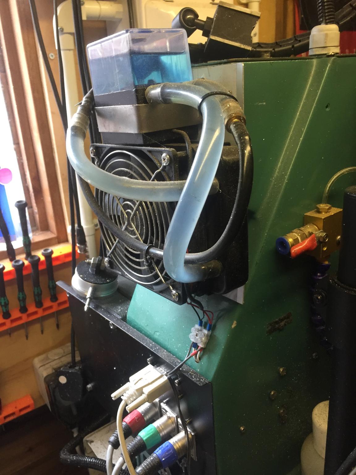

    I used a pond pump too but found it rather noisy and with it being directly mains powered couldn't easily control it from my panel. I then went to a 24v self priming pump and that way I just control it via a normal toggle switch when required as the temperature reaches a certain temp.

    When I get round to my build, I have acquired a second hand 24v pump, fan and radiator (120mm) and a perspex header tank, so I plan to mount it all directly on the machine. I have some NC 40degC thermal switches, so one of those will go on the spindle.

    Something like
    I'd keep it simple. The fan and pump are near silent (the rest state of the steppers is noisier).
    I never cut for long - probably 30 mins max - but there're no thermal issues at 2.2kW.
    Standard car coolant - that's been in there for a few years now.

    Something like ?
    Yes, exactly like.
