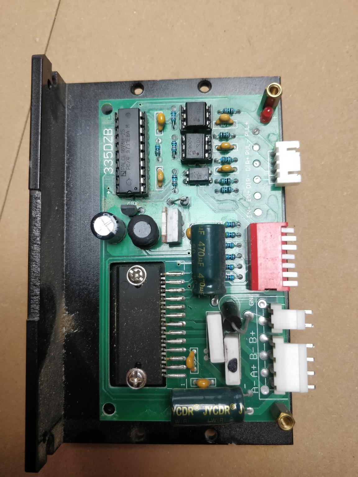

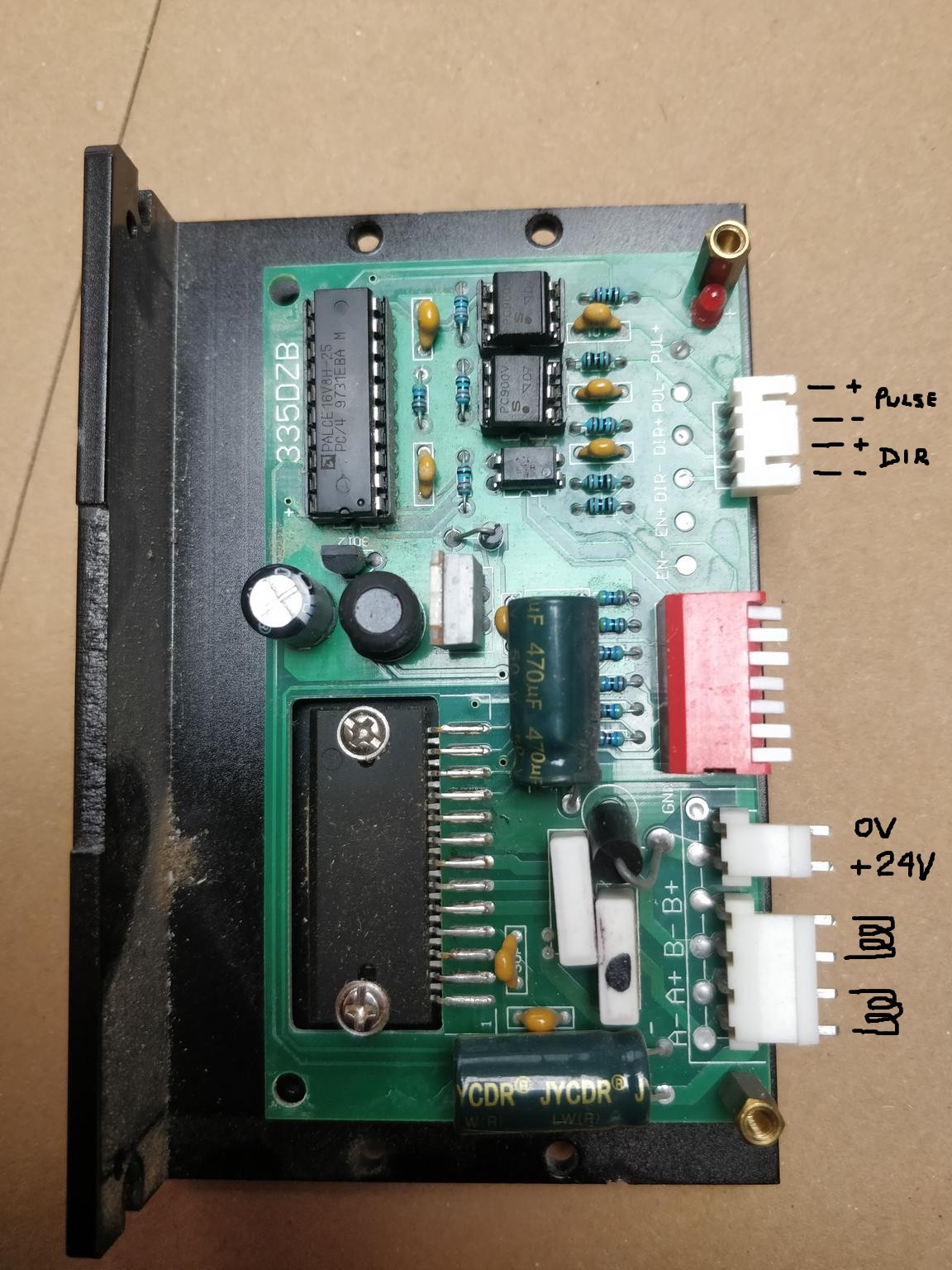

    i have been running the Chinese 6040 for a couple of years on light work and i have been happy with it so far. a couple of weeks ago the X axis stopped working so after a little research i managed to swap the A axis driver (which was never used) over and it worked great. yesterday however the Y axis stopped working and again after swapping drivers around it was confirmed to be a driver issue. this leads me to my questions

    a quick web search for the YOC335 didn't indicate if its built around the TB6560 or TB6600 IC
    open the faulty driver and take a picture of the board
    to complete the job you may find you can obtain a TB6600 based driver for example quicker than the original YOC335

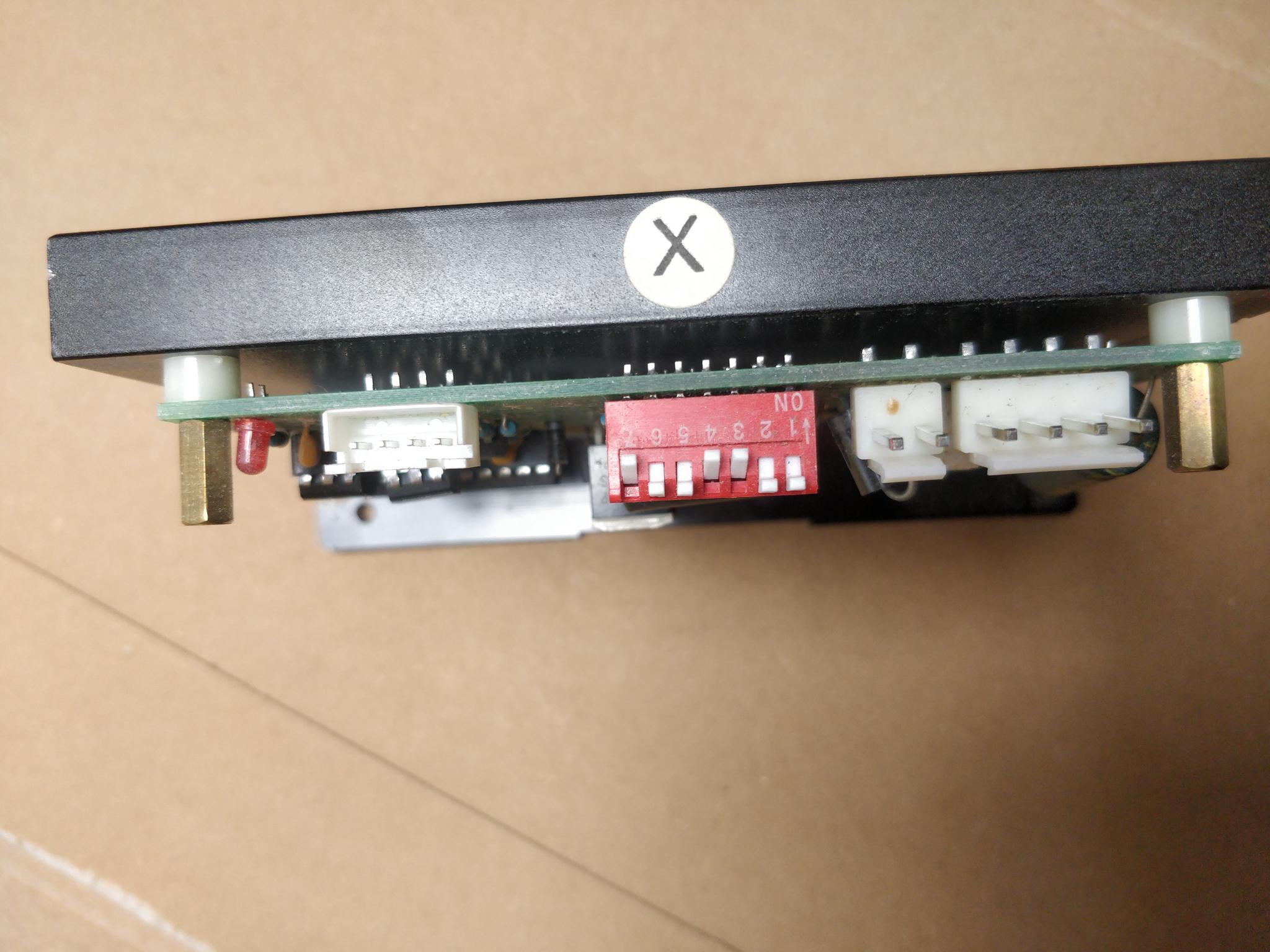

    i have contacted cnc4you and they are currently looking into which driver would be best suited as a replacement so i will let you know what they say. in the mean time i have attached a photo i took of the X axis driver but they are all the same

    It looks like the driver is one of the many TB6560 based drivers
    some CNC kits sold comprise of motors & drivers and a 36V power supply
    the TB6560 IC has a maximum supply limit of 24V !!!! so the drivers don't last very long
    most if not all TB6560 drivers do have design problems
    https://www.cnczone.com/forums/gener...-software.html
    with the 24V supply they should be OK but the low supply voltage limits the speed you can step the motor

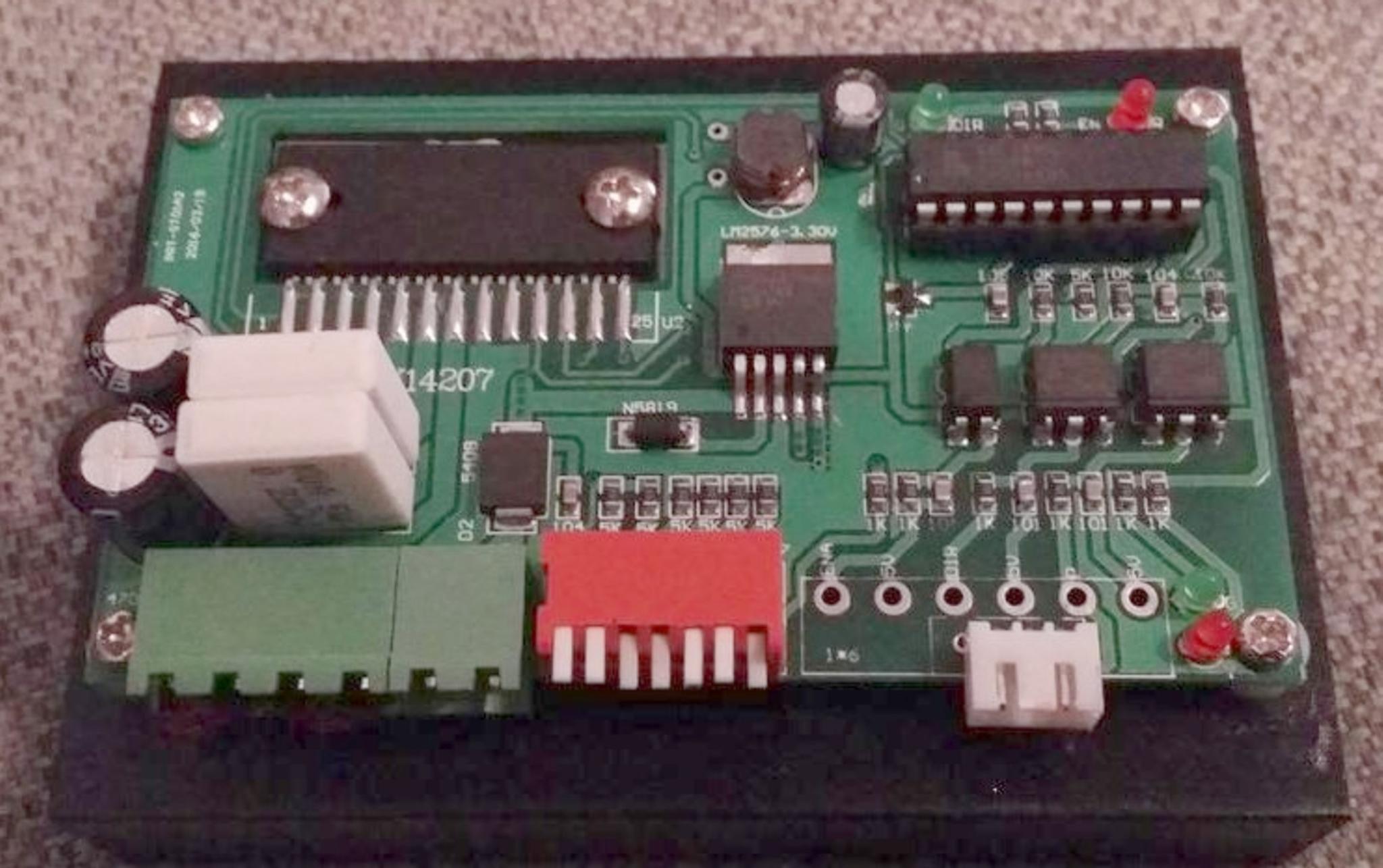

    PS
    your driver looks like another version of the TX14207

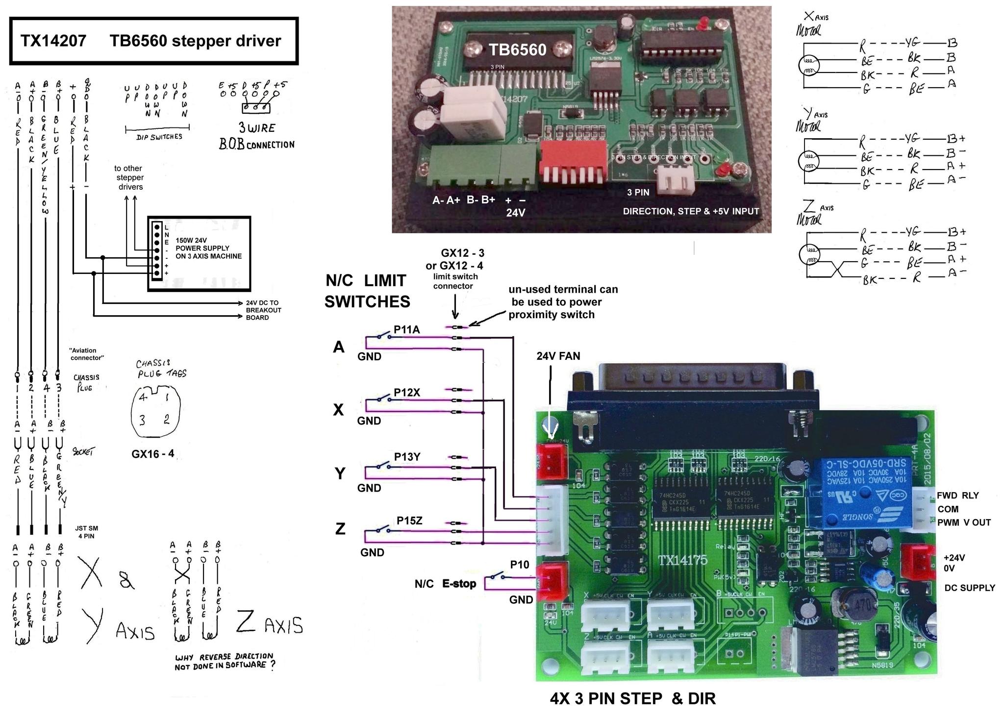

    PPS
    going by this diagram it looks like the + step , + direction & + enable terminals are commoned and only have one + 5V connection to the breakout board +5V

    thanks again john even though that is as clear as mud lol
    the thread you linked to was well over my head
    not sure what you mean by

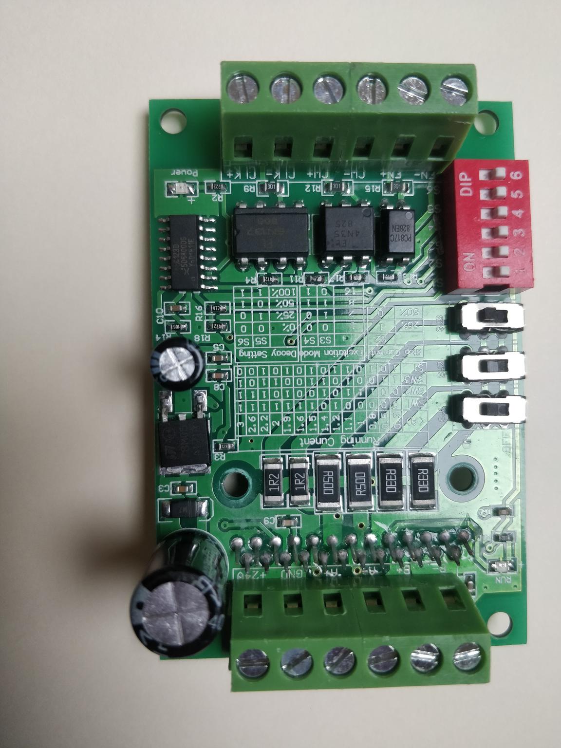

    i have managed to get my hands on a TB6560 v2 but it looks nothing like the one in the photo you posted (see attached)
    the switches are also different but hopefully i can figure these out as there is the info printed on the board
    would this work do you think ?

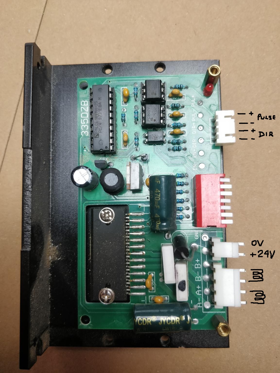

    after comparing the two boards i think i could match most of the wiring up. the only ones i am unsure are marked up on the YOC335 board as DIR +, DIR- and PUL+, PUL-
    on the TB6560 board they are CW+, CW- and CLK+, CLK-
    it doesn't look like the EN+ - are used
