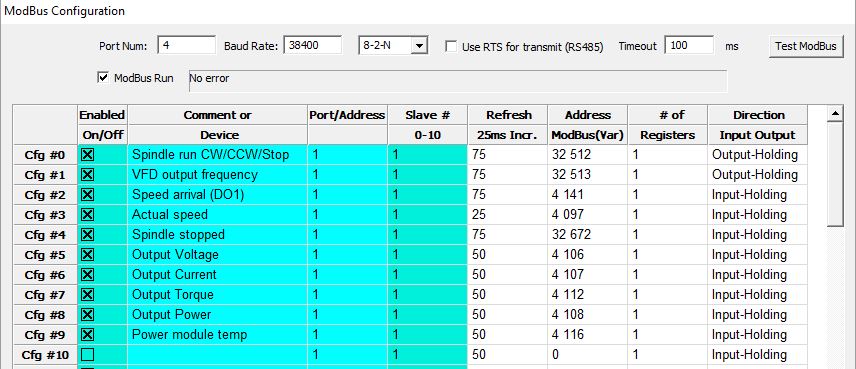

    A Mach3 brain file is all that is needed to control a VFD and a spindle if only basic functions are needed. Any VFD can be controlled with my solution, using a simple USB - RS485 converter and two wires connected between that and the VFD. Normally a shielded twisted pair wire should be used, but right now I have what I have, which is just a lamp wire, between my PC and the VFD. Of course, that will be replaced with real communication wire later on, but that is not the highest priority now.
    Start with wiring and plugging in the RS485 dongle, or connect to RS232 if that is what you want. I can't help with the RS232, I use a simple USB interface, this is the one I bought. I only know of the VFD I have, so I can't help you with connecting yours, you have to ask the seller or consult your manual or the web. Configure the port in Windows and check that it is recognized and working. I have Windows 10 Pro 64 bit on my computers and the dongle is plug and play, no driver needed. As far as I know, there are dongles which may not work under Windows 10, so that is something you have to check out, but I had no issues with mine.
    Once you have it all wired up and working in Windows you have to create a Modbus configuration file. Open your manual and find the relevant information. Note that if you are only interested in basic functions (CW/CCW/Stop/RPM) than you only need Cfg #0 and #1. The rest of my configuration is bonus, which I explain later. This is how my configuration looks like, but you need to alter the addresses to suit your VFD:
Name:	Mach3 Modbus config for Bosch Rexroth EFC 5610.JPG
    When you have your manual in hand you can test each address and command if you click on the "Test ModBus" on the top right of the window. Don't continue unless you manage to control the spindle through the test function. From there you should be able to run the spindle CW and CCW and to stop it as well. Remember that for the spindle to spin you must set or send a frequency as well. Remember also that you need to configure your VFD so that it reacts to commands from the communication line. Normally the default is the control panel, but there should be a setup or a DIP switch or a jumper to change that. Again, this is not something I can help with, only if you are using the Rexroth I have, or the other models which are compatible with it.

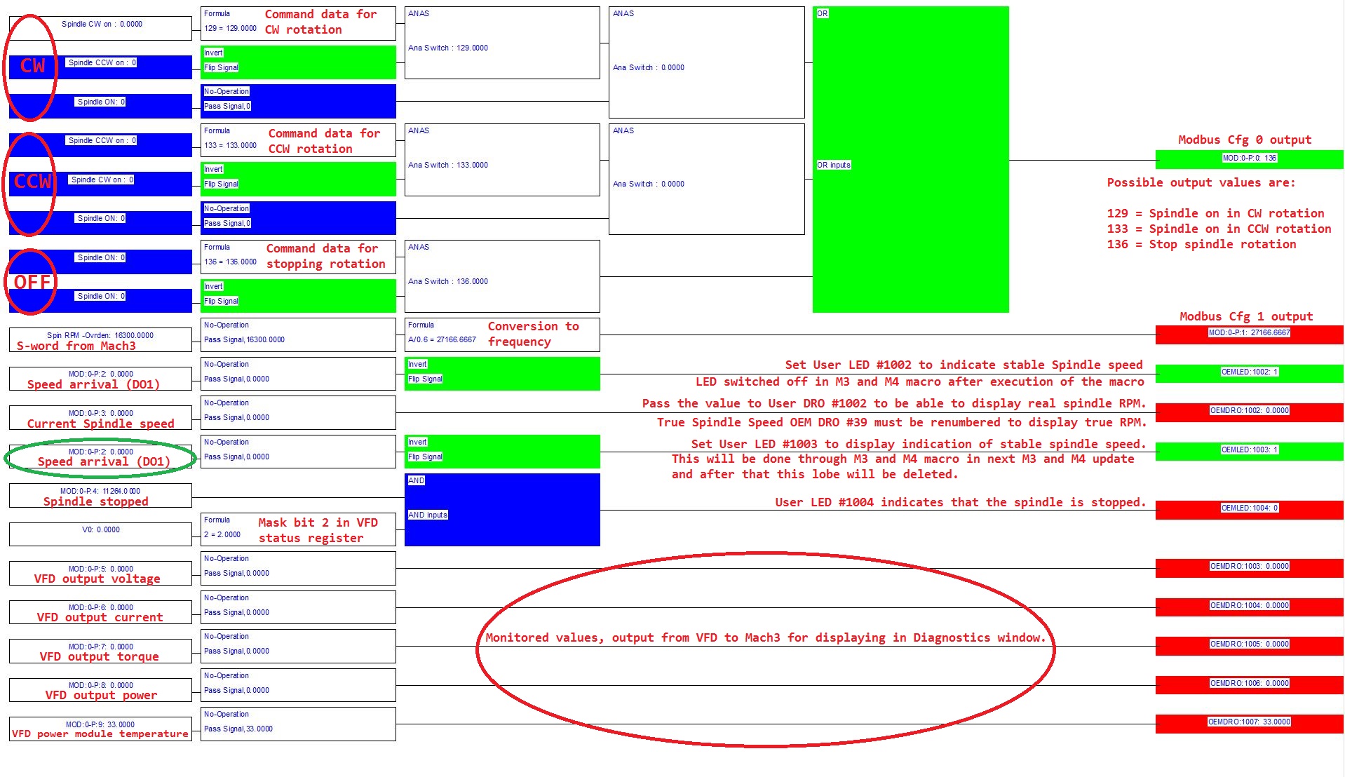

    The brain view looks like this:
Name:	Mach3 brain for Bosch Rexroth EFC 5610 explained.jpg
    Note again that if you are only interested in basic functions (CW/CCW/Stop/RPM) than you only need what is connected to Cfg #0 and #1, which are the two first lobes, i.e. the ones marked CW, CCW and OFF, plus the one where it says "S-word from Mach3". I have edited in some explanations in red, and those I think are pretty simple to understand. Ask if something is not so clear, I'll be glad to explain. Start up brain editor and create your own file using mine as guidelines. I will not post the brain file itself because this way you'll learn more in my opinion.
    Basic functions:
    Basic functions are: running CW/CCW and stop plus the spindle RPM. These functions are very easy to implement.
    The brain reads OEM LEDs for CW, CCW and Run, and sends a data to Modbus output port according to the commands for these rotation controls. The modbus address for this is defined in Cfg #0.
    In my VFD data value 129 is the command for starting the spindle in CW direction, 133 is for starting in CCW direction, and 136 is for stopping the rotation. This command data must be sent to holding register address #32512.
    To control the RPM the frequency value must be sent with two decimals in integer format, so 24,000 RPM = 400Hz and the data to be sent will be 40000 to holding register address #32513. In my picture the spindle RPM is set to 16,300 and to get there Mach3 must multiply that with 0.6 and send 27166, corresponding to 271.66 Hz. The decimals are truncated, but that doesn't really matter, the RPM is accurate enough.
