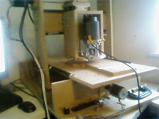

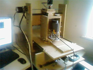

    (small)Pictures of my cnc(taken with a phone)

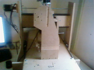

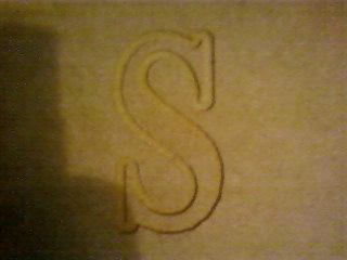

    The third one shows the new gantry side cut using this machine. The forth was a test.
    Table size at the moment is 500x240x75

    Looking good mate, whats the ganrty side for machine two or ?
    Its to update this machine to make it neater, also have exact slots for the leadscrew bearings and bearing assemblies.
  4. Nice little machine there bro I like it, thats what its all about glad you have it working. What did you use for the leadscrew and nuts ?? nice job.
    Quote Originally Posted by Kammo1 View Post
    At the moment its using m8 threaded rod and delrin nuts. My upgrade to trapazoidal leadscrew and delrin anti backlash at some point to gain some speed. Running at 24ipm at the moment. Slow but accurate.
    Fine drive nuts they are to ;).
    Actually quite a bargain given how much messing about was involved to make nuts before. The best thing about these is how easy they are to mount.
    Have you thought any more about making round ones with a flange(im sure thats what they call the surrounds) or even better antibacklash ones using a split end and a spring?
